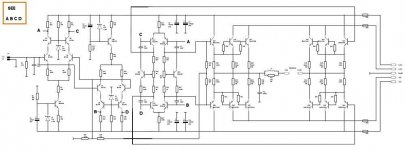

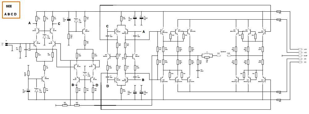

Let me get this right.....A nice design, :cool: just a bit complex
This is a fully balanced amp that does BTL (Bridged) and only takes the NFB from the 15K going to the HOT (+) output? Does the other output (-) follow but in the opposite direction despite not having a feedback connection to it?
Does the fully balanced design reduce THD% by having a more equal swing?

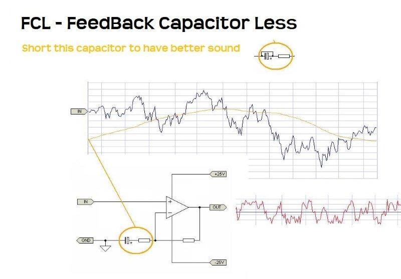

Hello
in the various experiments described I think I have generated some confusion ...
as we know when it is possible to have every stage in perfect complementarity
the sound improves ...
(for example with the stadium entrance is an OP-AMP the rest is symmetrical)
improves the sound even when you have two amplifiers working together but in opposite phase...
(it's worth recalling that the configuration AB bridge or balanced involves the simultaneous activation and superimposed channel N and P as in Class A)
what I discovered (about Nelson) and I ask you to test on your amplifier (be cautions - start with a resistor on output)
is that eliminating capacitors in the circuit
improves the sound so very significant
the use of capacitors output was only a caution!
shorting the condenser of feedback with a resistive load instead of the speaker
you realize immediately that the gap permanent of direct current in output
there are negligible
in case of configuration to bridge this stable component halves
that's why I developed the tandem mirror system:
1 -to have an input absolutely complementary (something impossible with the OP-AMP)
2 -to have a balanced output (then with a DC-Offset minimum)
3 -and of course playing with a clean feedback (the Feedback Capacitor Less method may be is not my invention)
try to beleve if I say the true:whazzat:
keep in mind that these qualities are valid for each amplifier (universal)
do not need a particular schematic:( :(

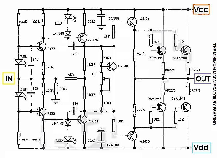

Thank you for your answer,
I understand your point of bridging. I'm not a big fan of bridging but why not. About the use of LTP as VAS stage, Douglas Self showed it's not the optimal configuration but there is nothing really wrong with it. The biggest question that arise is about the NF picking point : since the final stage is not included, it will not enjoy the NF distortion lowering. Most part of the distortion in a power amp appears in that final stage so it will stay untouched at the output. Again, it's a matter of choice but why?

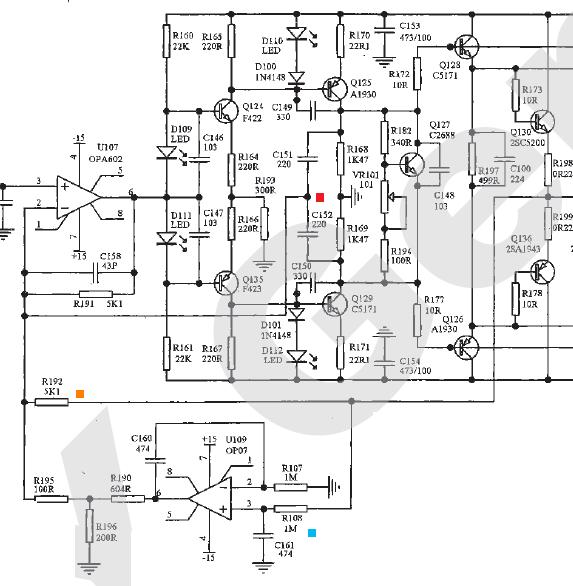

essential quality for true realism (of music)
Most part of the distortion in a power amp appears in that final stage so it will stay untouched at the output:
true but don't need NFB because don't have gain (in voltage)
the criterion of essential quality suggests not to add components where there is not needed
even if this variation try on your amplifier
you realize that the harmonics increase generously:angel:

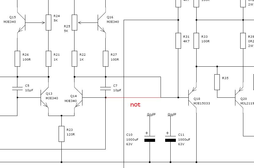

Hello again,
I don't think that this "gain in the last stage" question is relevant for distortion cancellation by NF. The distortion is an added component and is not amplified (unless it comes from the previous stage off course). It's more a question of gain difference between open and closed loop in the overall system leaving headroom for NF.
And even if the overall system has low gain or unity gain, you can still get a powerful NF by adding gain in the NF loop, with the subsequent problem of linearity in the NF loop.
To include both polarity in the NF of your amp, I guess you could maybe loop the (-) NF point to the (+) of the input pair and let the pair make the subtraction. I don't know about the stability problems it could cause but it seems ok to me. The other solution would be to stay with a unique return path and substract before applying the NF to the (-) of the input, with an opamp for example.
I maybe wrong but let's discuss it
