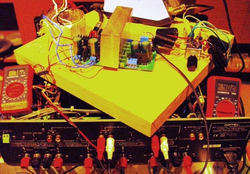

Forget Capacitors on Output
I'm testing RB-976 from 10 days in bridge
without famous NFB capacitors
see picture (see also TDA balDAC)
one channel have 76mV other -40mV of DC gap
maximum have found double time (150mV)
don't understand function of this orrible old design
may be in the past amplifier was very unbalanced?
try with your amp with a power resistor for load
... may be have no more then 350mV

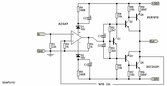

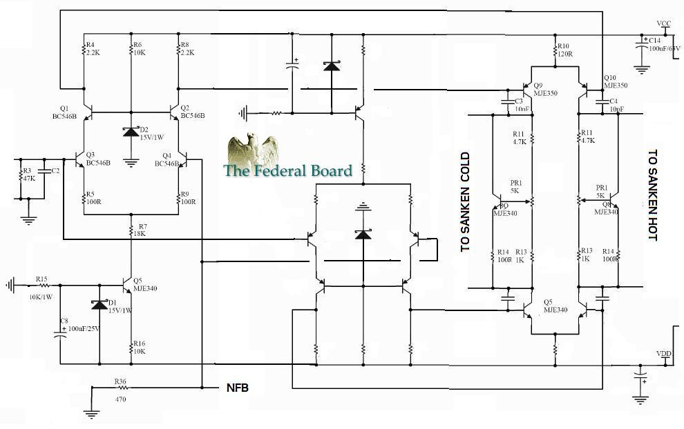

hi, Stee
some details...as i already said, in my schematic/amplifier is no nfb capacitor (see attachment on post 25).
i found this schematic on a russian site and i gave it a try because seems interesting at that time (and it is still the case, so far).
on the output, grounded (normal) mode, i have 2mV on R channel and 3.7mV on L, DC offset. i didn't try to adjust the offset on TL071s, these are "default" levels.
i will redo the test in the following days, putting 4x4700uF/channel and with 47R between out(+) and GND, as you suggested.
regards,
Tibi

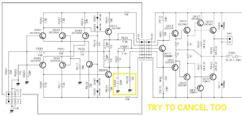

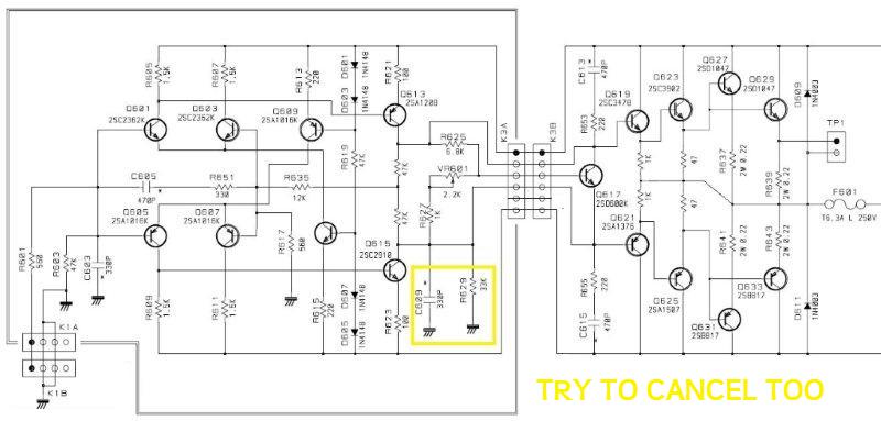

Re: Re: Re: try the new idea it's easy
Stee, regarding the image you attached in the above post. Those caps are there in a shunt across the VAS for compensation. They are critical to stabilise the amp for those specific transistors. Using other transistors would force you to use other compensation mechanisms. Either way, you will have to compensate somehow, no matter what transistors you end up using. Think twice before removing any caps from an amplifier, you might just end up with burnt silicon and/or fired speakers.

Searching definitive solution
I have a diagram on paper
T-90 AM Audio built not far from my house
when I have the scanner working ...
and also that resistor and capacitor are gone
compared to the classic pattern
I believe that another default by engineers !
of course I am prepared to risk a transistor
but not the speakers
use the output resistor/then capacitors to measure/prove
for sure
where you can better simplify😎

hi, Stee
i guess maybe it's a bit tricky...but....this is not a traditional class AB amplifier, it's current dumping principle. that means existence of an alternative current bridge...and R10 is part of that bridge, composed by R10-C3-R11-L1. accuracy of the bridge has pretty big importance on amplifier response, so R10 can't go...this is my point of view after reading some documentation about Quad405 and current dumping principles.
please correct me if i'm wrong.
also the op-amp don't drive speaker directly (DC-mode), because there is C2 and JP1(jumper)...C2 is not really needed because original schematic had 741 as op-amp,and the 741 needed some correction...but for TL071 it's not the case. so, JP1 can be in "open" state and then is no direct connection between op-amp and speaker. in fact, JP1 is currently open in my case (his short/open state influence i found being null so far). if it useful somehow i can give the original link, where can be found original schematic and also some details about that one posted by me.
regards,
Tibi
Stee said:in your case R10 don't need
op-amp don't have to drive speaker
hi, Stee
regards,
Tibi

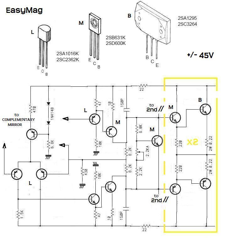

this is the direction of my project ( now renamed EASYMAG )
again from T-90 schematic...
1 - Use only 3 size of transistors (Little Medium and Big)
2 - VAS is most critical, so better put a current stage
3 - Final stage is better double also for driver (in parallel)
now see this architecture
is becoming very interesting
... who wants to book a printed circuit board?
coming soon
coming soon
