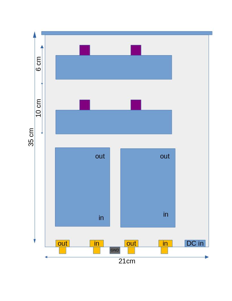

Hi all,
limited space makes it necessary to employ max a 23cm width case. Wondering if the layout below is good enough heat wise for the shunt UBiBs. Distance between the first UBiB transistors and the second UBiB will be about 4 cm. There is space for more distance if necessary. The transistors will be chassis mounted.
Thanks!

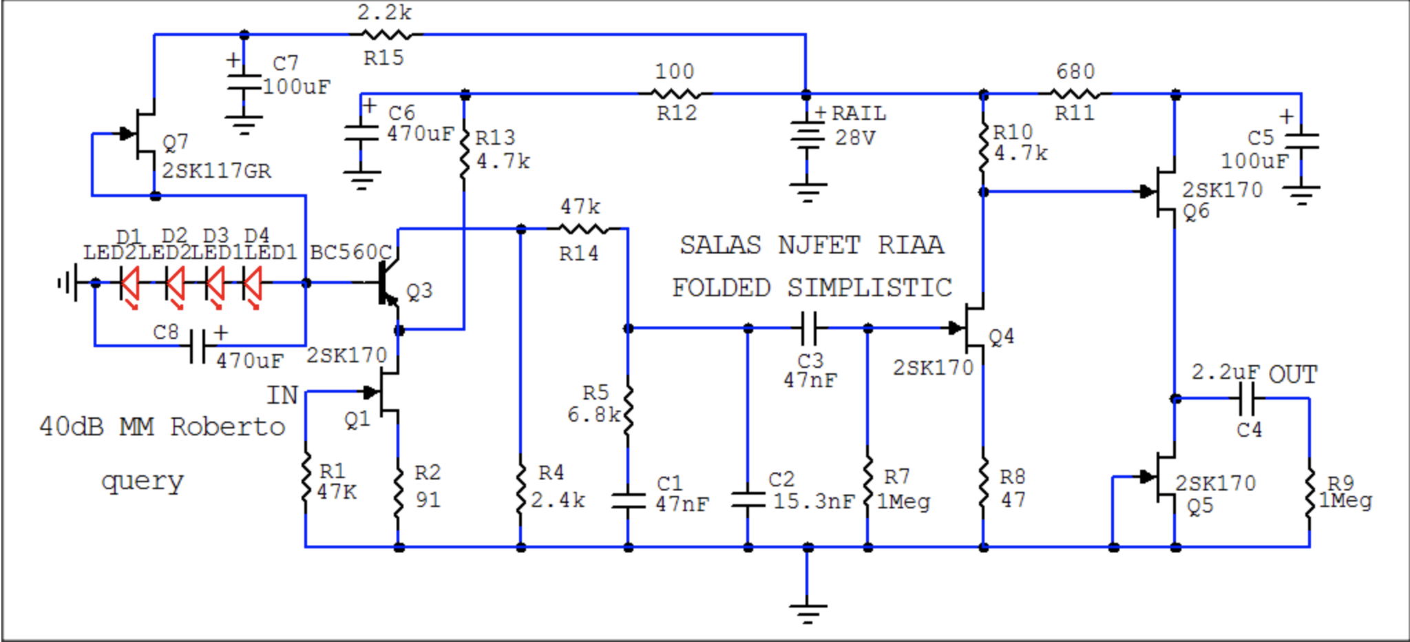

Hi Salas. I am using the MM version of the folded simplistic...when I built it I was using MM cartridges (2M bronze). I power it with the 1st generation BIB shunt reg.
But now I am using MC cartridges with this same phono stage. Using your Jfet step up from the simplistic PDF powered by batteries for MC use.
Is it worth building a new simplistic with the MC capability in one unit? Will I see any performance advantage vs the MM simplistic + Jfet step up?

You delete a stage and a capacitor coupling when losing the pre-pre step up so you should expect some increase in transparency. Maybe not spectacular because such low level input stages don't produce much signature THD, but it should be an audible circuit simplification. Remember, absolute phase also returns to correct after that (3 vs 2 gain stages reversing).

BTW regarding absolute phase in a three gain stages inverting system, like you now got with an active pre-pre, reversing the cartridge pins wiring can restore it. With exception of some cartridges having connected one channel's earth pin to the cartridge body as a shield. Was usual in vintage MM models.
Not that you can easily tell a difference with typical recordings and non linear phase speakers, maybe on headphones with some minimalist recordings. If there was provision to keep them phase consistent during program production, cut, and press. Else they will like it by chance.
