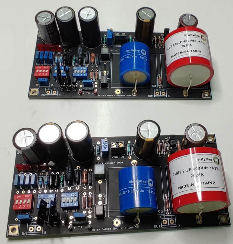

Sorry if this has been covered
Do the trim resistors need to be set prior to installation and if so to what?
You may install the mutiturn trimmers as they come half way value set from factory and start from there.

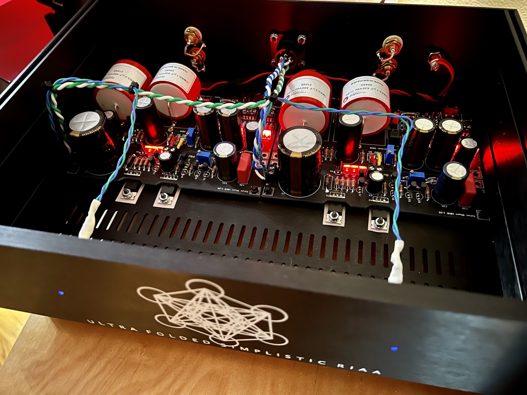

It's been a while but wanted to again thank you Salas (and Teabag, for all the parts and PCBs), your design is still bringing me enjoyment and I'm always amazed at it's capability to make vinyl come alive! I've slowly upgraded to an entirely JFET chain: Simplistic NJFET, Mesmerize DCB1 and a First Watt J2.
I still have 2 UFSP's to build - the last year was consumed with work, family and covid but I have listened to a lot of vinyl to stay sane. I've had a couple cartridges rebuilt (Benz Ruby 2 and Soundsmith Otello) and replaced the AT VM540ML stylus. I gave up on my tube amp as the primary amp, it was fun but too much maintenance and tinkering for it to be the in the primary sound system for the family. The UFSP, Mezmerise and J2 with the Altecs are pretty amazing - family is happy too and I don't worry about things being inadvertantly left on overnight.

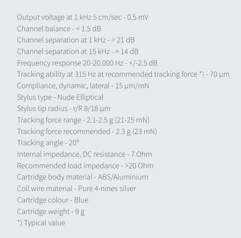

I would like to try a step-up transformer with my folded simplistic pre-amp (built for 40dB gain), I would like something with multiple taps to allow 2 or 3 gain settings. I would like to use it with an Ortofon Quintet Blue (specs below). I was thinking of the Lundahl LL9226 on a custom pcb to allow switching of the gain. What do I need to look for to know if this would be a good match for my cartridge and the FSP? Other suggestions? Thanks!
Your cartridge's resistance is safely below all lowest Ohmic recommendations for ratios and good frequency response in the particular step up transformer's datasheet.
It is also useful to remember each transformer's setting divides the MM phono's input load resistor by a squared ratio i.e. 1/10 divides by 100 so 47k/100=470R reflected load at the primary as seen by the cartridge. If you want 100R load on 1/10 ratio for the cart use 10K R1 in the FSP and so on and so forth.
