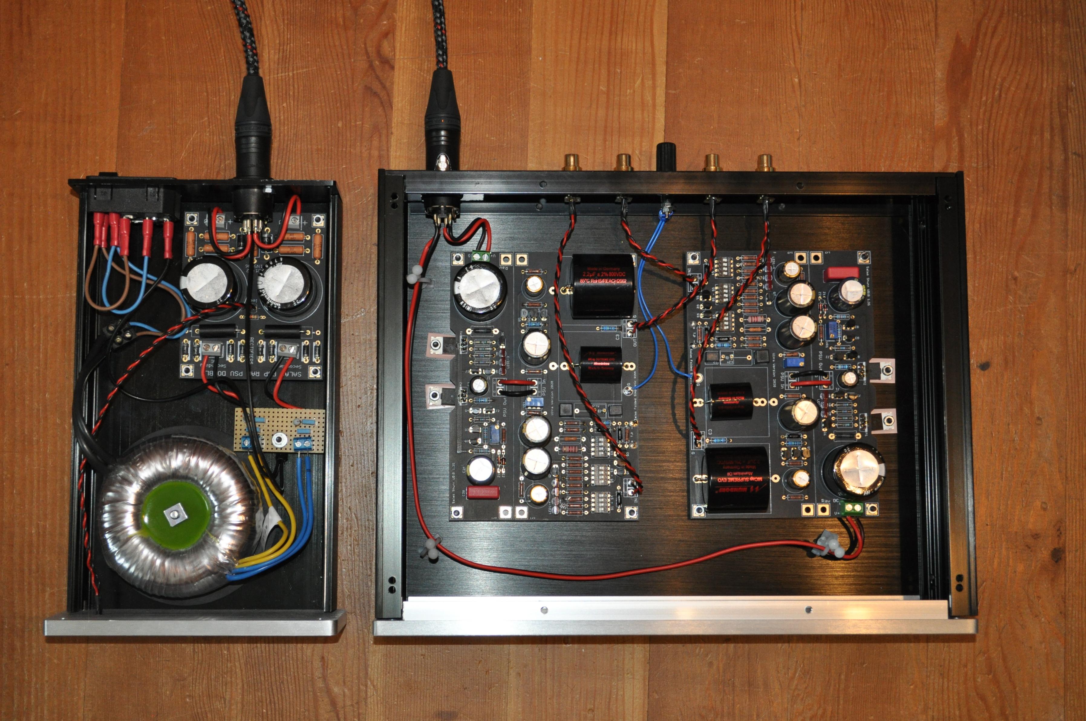

Folks:
I've made the revisions suggested by Tea-Bag and Salas: the PE via on the RAW power supply pcb is now connected to the PS chassis (and toroid shield) and earth ground. The ground wire between the PS chassis and UFSP chassis has been disconnected.
The hum is unchanged. What would you suggest as a next step?

Move the PSU further away from the main unit and the TT. Also rearrange any mains chord that may be located near the TT cables.
Salas & Co.:
The power supply chassis is about 25-30 cm from the UFSP chassis. The turntable has a 2-prong cord and is plugged into an SG-4 sine wave generator (a speed controller). The SG-4 has a 3-prong cord and is plugged into a power distribution box. The two pairs of RCA interconnects leading to the UFSP (from the turntable and to the preamplifier) are both shielded with the shields connected at one end only.
The hum persists regardless of whether a ground wire connects the UFSP chassis to an earth ground connection.

Try connect the speed controller box to the TT ground lug on the phono box with an alligator lead. To see if it makes any difference.

Is the hum present with only one RCA connected from the TT?

I was wrong about there being a 2-prong cable on the turntable; it is 3-prongs. However, the earth ground for the turntable power receptacle in the SG-4 was disconnected (the SG-4's power inlet's ground was still connected to the SG-4 chassis). I reconnected the ground connection in the SG-4 and, as a separate test, ran a wire from a ground lug in the SG-4 to the turntable's ground lug. There was no difference in the hum with either or both ground connections.
Rush:
Yes. The hum is present in both channels at an equal volume when both RCAs are connected to the turntable. When the right channel RCA cable is removed, the hum is unchanged in volume and is still present in both channels. When the left channel RCA cable is removed, the hum remained in both channels and increased slightly in volume.
Scott
Try a regular RCA cable with shields connected at both ends. (Or have I misunderstood you? Is there a return conductor in the RCA cable besides the shield?)

Could the hum be caused by a broken headshell lead? I suspect there may be an issue with the right channel hot wire.

I had a headshell lead disconnected a few weeks ago when hooking up a headshell to my tonearm. It buzzed a lot, it was not subtle.
One could i guess take some small pliers or tweezers and connect with some effort to see if the hum drops down.
If you are saying with TT disconnected, no hum, then we are left assuming that the TT has some grounding issue somewhere?
headshell/tonearm lead wire issues do not sound fun.
Tea-Bag:
Yup, I think the problem has been isolated to the turntable's right channel. Time to start looking at options. The tonearm on my Apollo is air bearing, so the wires are particularly small gauge and insulated just with varnish; wire drag can really affect an air bearing's performance.

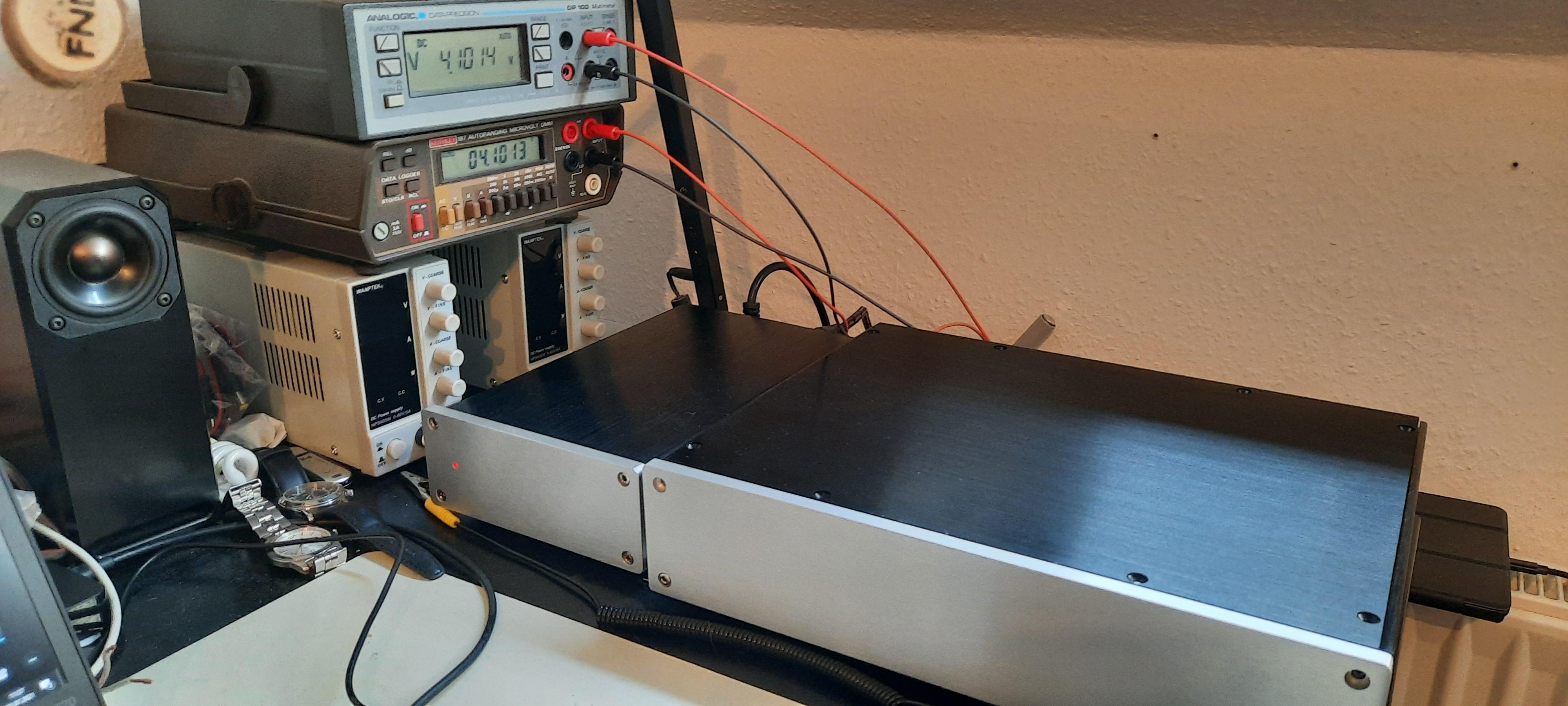

Hi Salas (thanks for reminding me to write something more here) and all...
adjusting 4V was time consuming, but fun. Enough time while working in home office.
Both meters are "calibrated" by me, at least adjusted to show the same value, differing about 4 digits at 20V, at 4V about 1 digit.
So adjusting both voltages to 4V (beginning now at 4.2xxV with turning on and decreasing to 4.00x V after about 3 hours, staying there.
Then the shock while trying to evaluate the value for C2y. Connected to my Technics 1210 and Denon amp, listening with headphones.
HUMMM... Grrr. Short story: The terminal for the ground connection is crap. No connection, regardless how tight the screw is..
Installed a new one, now silence. Phew.
