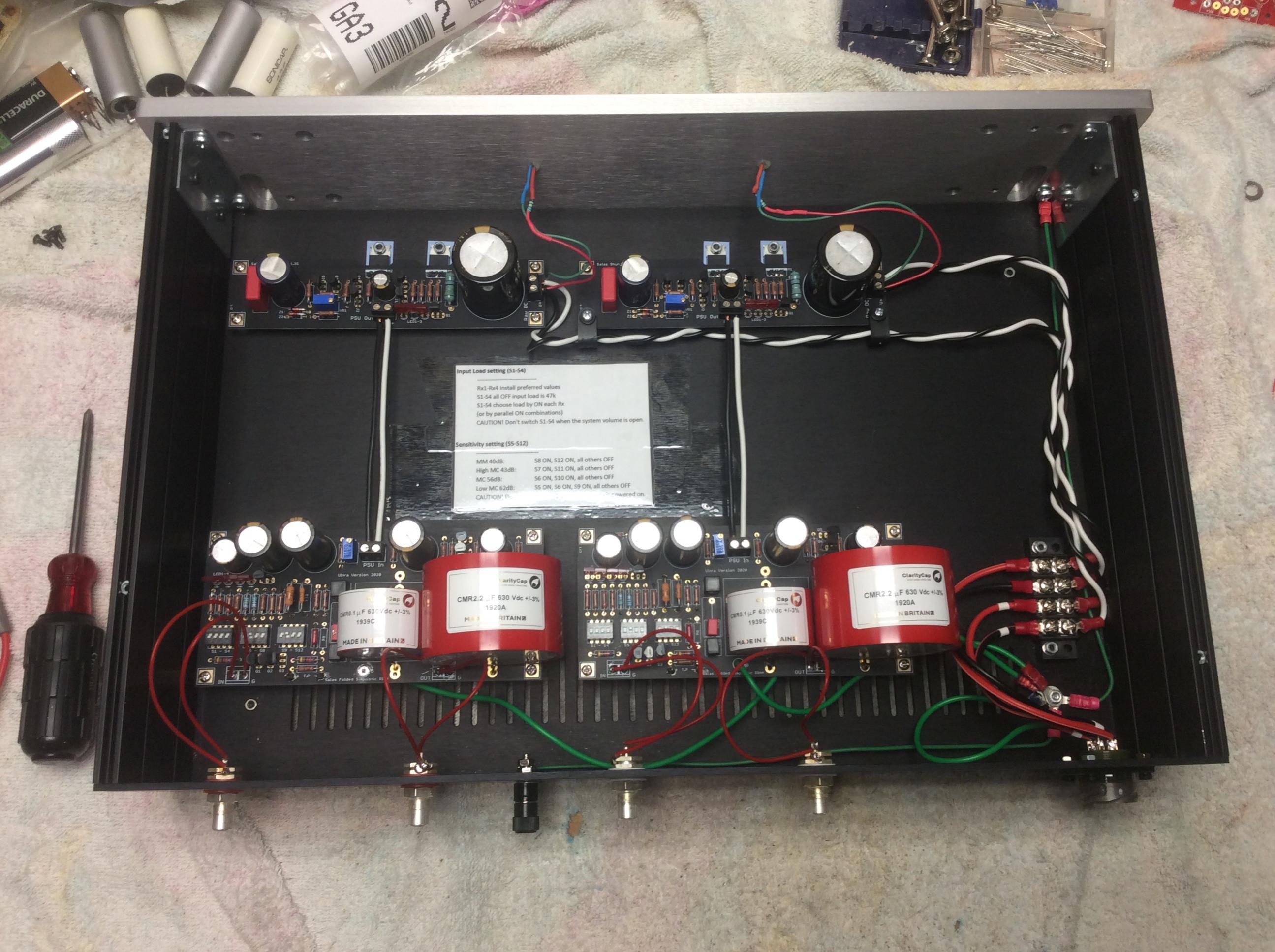

Folks:
I'm trying to correct a lingering ground issue with my phono rig (Maplenoll Apollo, Lyra Lydian Beta and UFSP) and would appreciate your guidance. The audible 60 Hz hum is limited to my phono set-up only. As can be seen from the photos, my UFSP is in two enclosures, connected via a 5-wire umbilical.
On the power supply chassis, there is no connection between the RAW pcb's PE via and anything else. The toroid's shield and the chassis are connected to earth ground, as is a wire running through the umbilical to the UFSP chassis.
On the UFSP chassis, the earth ground from the power supply chassis connects to the UFSP chassis (both the chassis base and the front panel), the ground via on each UFSP pcb and the external ground stud on the rear panel. I added the ground connection to the front panel because it was isolated from the base; that connection isn't causing the problem.
The hum remains if I disconnect the four connections at the phono cartridge. The four clips are a little loose, but they aren't slipping off the cartridge's pins. On the other hand, the hum disappears if I disconnect the RCA cables from the turntables at the UFSP. Swapping RCA cables does not change that result.
I'm no engineer to be sure. Is the hum likely being caused by something other than my UFSP?
