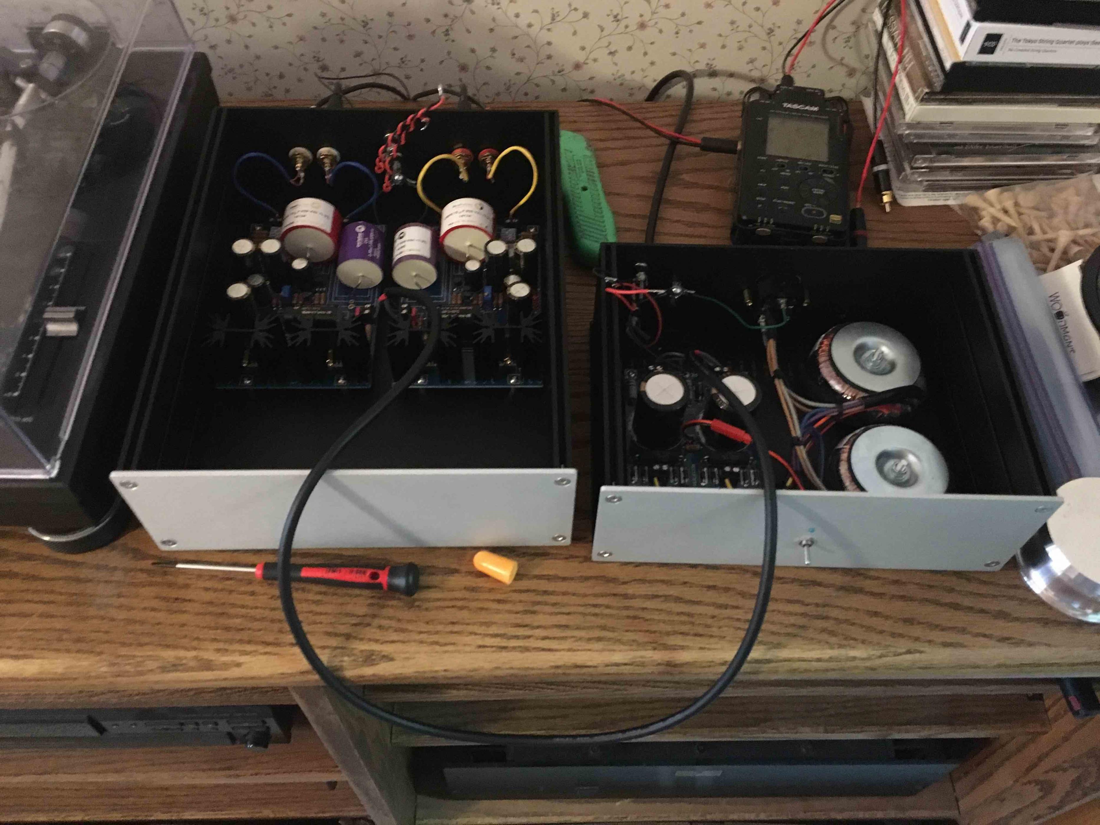

I powered up my build of Salas’s phono preamp yesterday (56dB configuration with FSP dual mono power supply) and biased it per the build guide. At moderate volumes all seemed well. I didn’t notice any hum or other problems, and it sounded pretty good (midrange was a bit recessed, but I am also using a brand new cartridge that needs to be broken in).

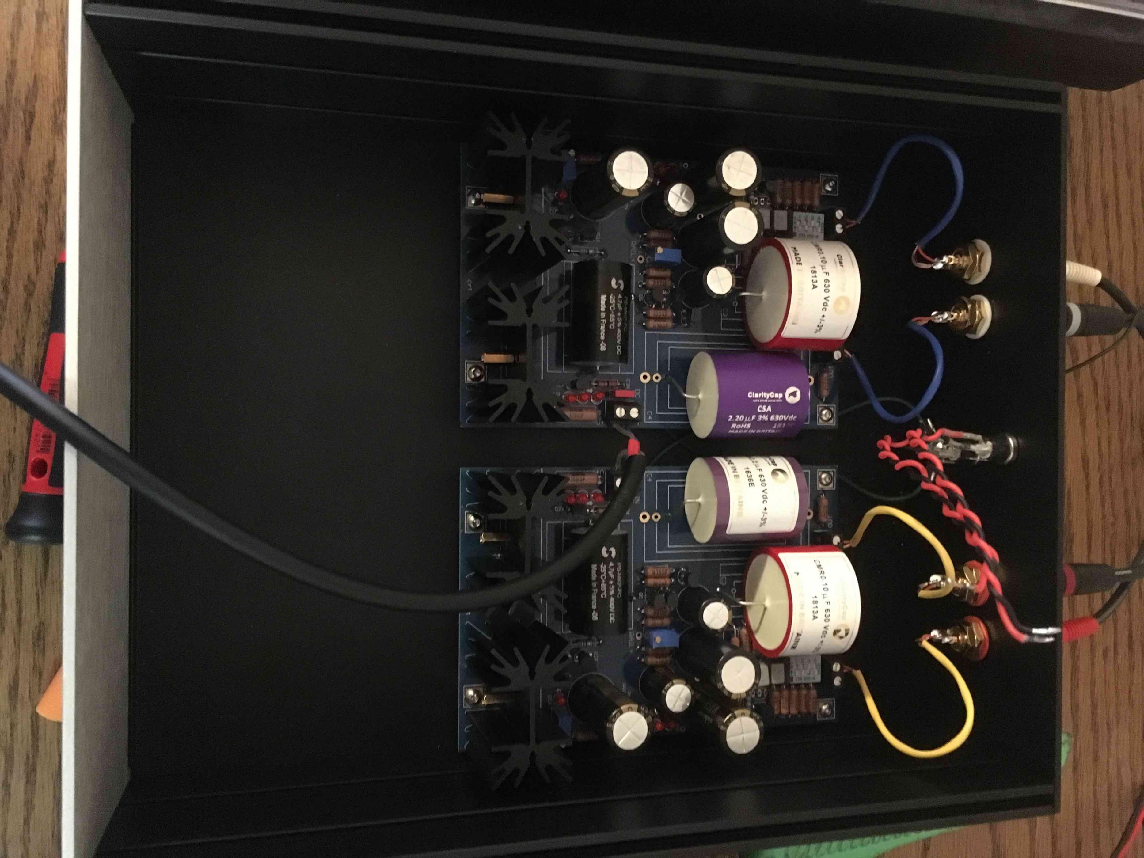

At higher volumes, I have 60Hz hum and also noticed that I was pulling in a local FM radio station. The hum and the radio “reception” can be changed by repositioning either the input or the output RCA cables. I also observed that if I hold my hand in close proximity to the preamp boards, without touching them, the hum increases, and if I touch the large red 100 pF input capacitors the hum on that channel increases.
For trouble shooting I have tried the following:
1) Removed the preamp input RCA cables - result: no change
2) Removed the turntable ground wire - result: no change
3) Changed position of the DC power cables (cables between the power supply and preamp) - result: increased or decreased hum changing the power wiring eliminated this effect see #7
4) Changed position of the output RCA cables - result: reduce or increase hum, increased radio “reception”. (Raising cables increases reception)
5) Plugged Power Supply into a different outlet - result: no change
6) Changed Output RCA cables from diy Mogami coax cables to cheap, generic RCA cables - result: no change
7) Changed from 2 independent power cables from power supply to preamp to single star quad shielded microphone cable (as suggested in the build guide) result: somewhat less hum, hum not changed by moving the power cable as was previously noted.
The hum and radio reception are the same with the preamp cover on or off (except I can’t get my hand near enough to the boards to create hum that way if the cover is on)
I am thinking of trying the following options for trouble shooting, but would really like other suggestions:
a) Replace large 100pF Clarity Cap CMR input capacitors with some Mundorf MKP’s of the same value.

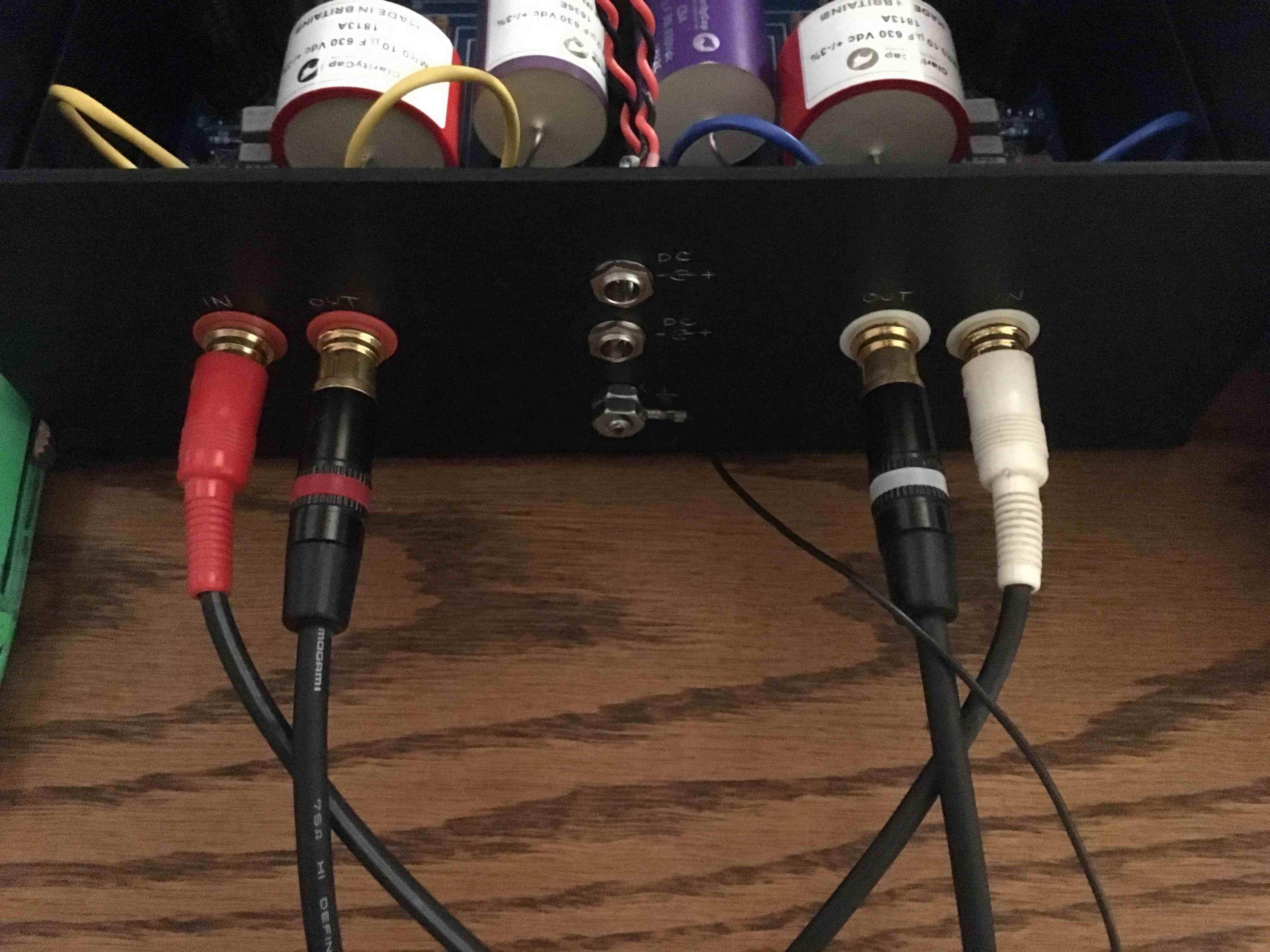

b) Relocate input and output RCA jacks to keep both inputs and outputs together (currently separated to minimize internal wire routing length, see photo)
Note: photos show the star quad power cable used in trouble shooting - this will be replaced with a more permanent solution later.

A snap-on ferrite clamp placed on the turntable leads will fix the RF reception problem.
ZCAT1325-0530A-BK TDK Corporation | Filters | DigiKey
Not touching the capacitors is a good way to not have that particular problem... :)

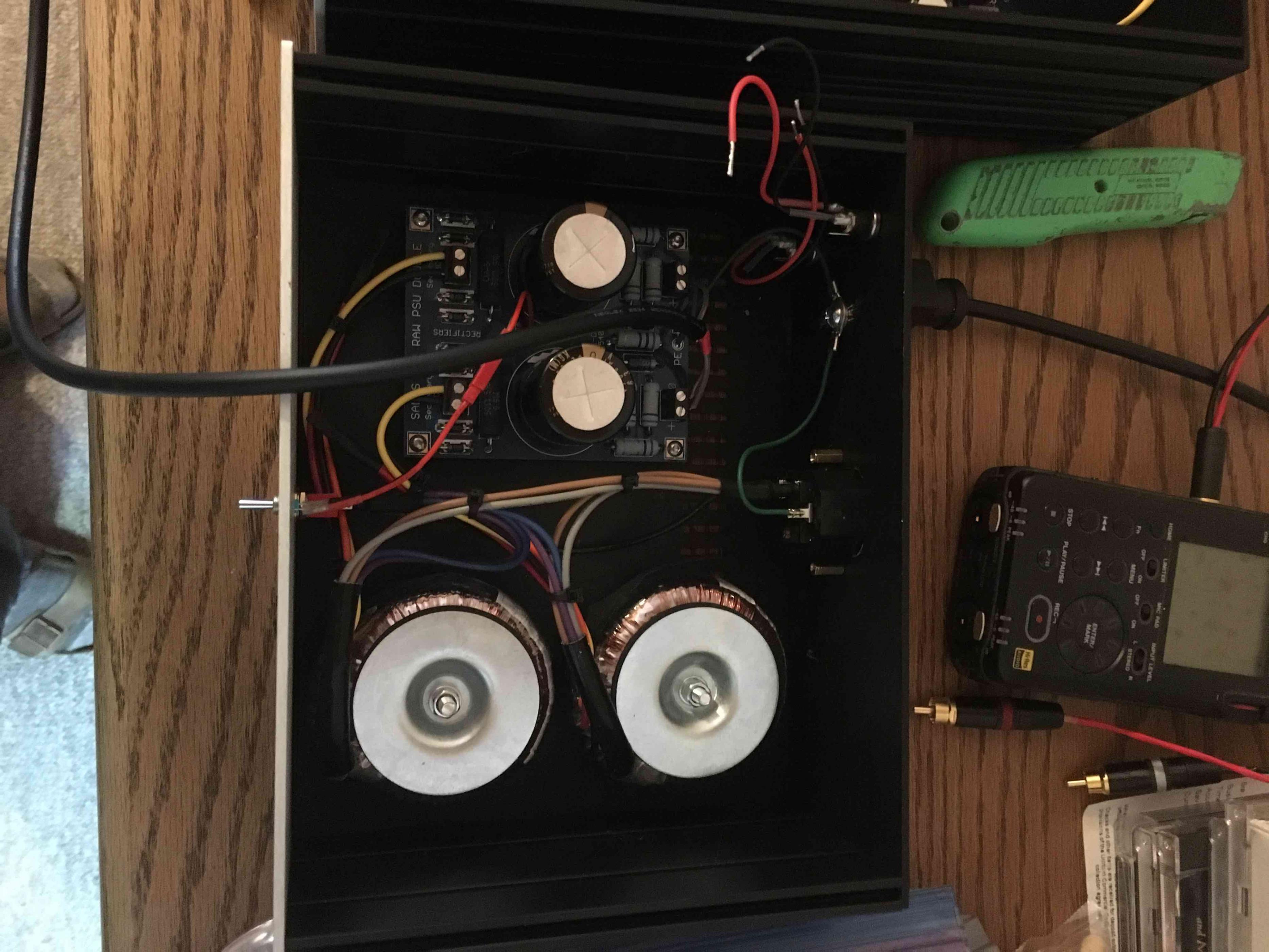

Move the PSU further from the phono stage, and for that matter, move the phono stage away from any transformers.
Scrape the anodizing off the chassis where it touches other panels or screws, try to make a good electrical connection between all panels of the chassis.
If you short your RCA input signal to ground at the board, one side at a time, does it make a difference?
Is the input/output wire shielded?
Does L-R side share a common ground to the chassis, or each channel?
Shorting the input of one channel to ground at the board significantly reduced both the hum and radio reception on that channel. I am not sure what this means for implementing a permanent solution.
Input and Output RCA cables are shielded.
L-R both have a common ground to the chassis (from the ground point on the board to a common point on the rear of the chassis (green wires with ring terminals in the pictures) I think this is what is suggested in the build guide? I also connect the phono ground wire to this point on the back of the chassis.

I grounded the shield of cabled on both ends. In my case I moved to Mogami 2 wire, where ground is shield. That helped.
Also, more off course. I grounded the TT to the power supply chassis. Similar build to yours. That reduced hum more. That may have more to do with my umbilical wire routing in my stereo cabinet than anything else.

Thanks for all the help! My preamp is now quiet enough that I consider it fully functional (no RF, and hum is on parity with the noise floor).
The changes that yielded an improvement were:
- internal wiring changed from shielded twisted pair to coax
- all phono preamp enclosure panels bonded to ground
- bundle input and output RCA cables and route in fixed location selected to minimize hum and RF pickup
I tried some of the other suggestions, but couldn't notice a change.
- removed 1 ohm channel rails resistor from RAW DC circuit
- checked for ground loop in other equipment (connected battery powered portable recorder directly to phono preamp outputs and still had hum at a similar level)
