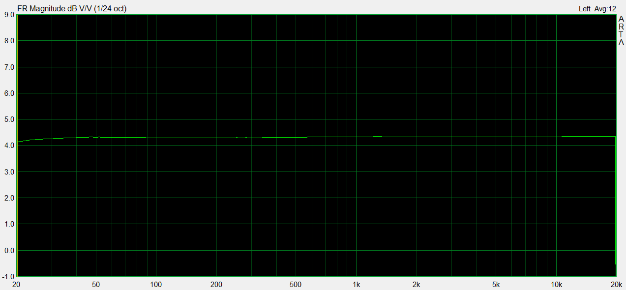

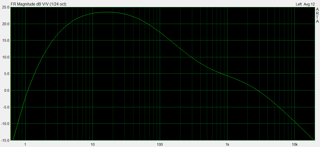

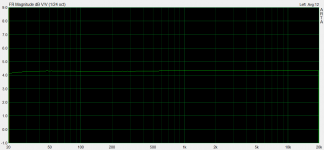

Scott, there's another practical way too, I used a RIAA playback curve in ARTA as FR comp. The software works by reversing for it. I run a test on breadboard with a times 10 Jensen SUT, an AD8429 as first stage, an OPA2134 as second stage and servo, passive RIAA in the middle. 1% RIAA parts were used with no selection. 62dB total gain. FFT grass stays at -102dBV 20Hz. Given the opportunity I implemented the mild subsonic filter in the servo, so no direct capacitor coupling anywhere. And here is how it can be verified against frequency: First pic is the actual transfer, second picture is the compensation to flat against the time constants derived 20Hz-20kHz cal file.

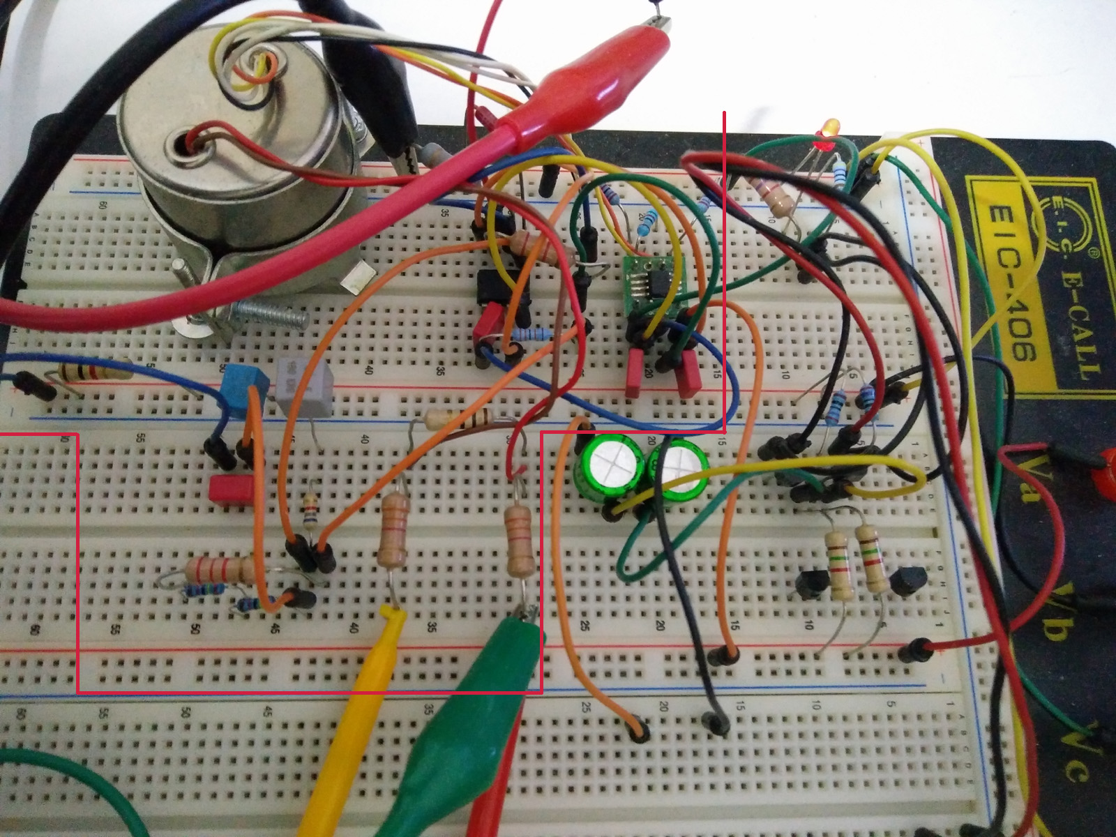

BTW here's the "it really happened" pic also 😀
(The diff input test circuitry I described is what can be seen inside the red line fence. The other stuff is residual from another experiment)
