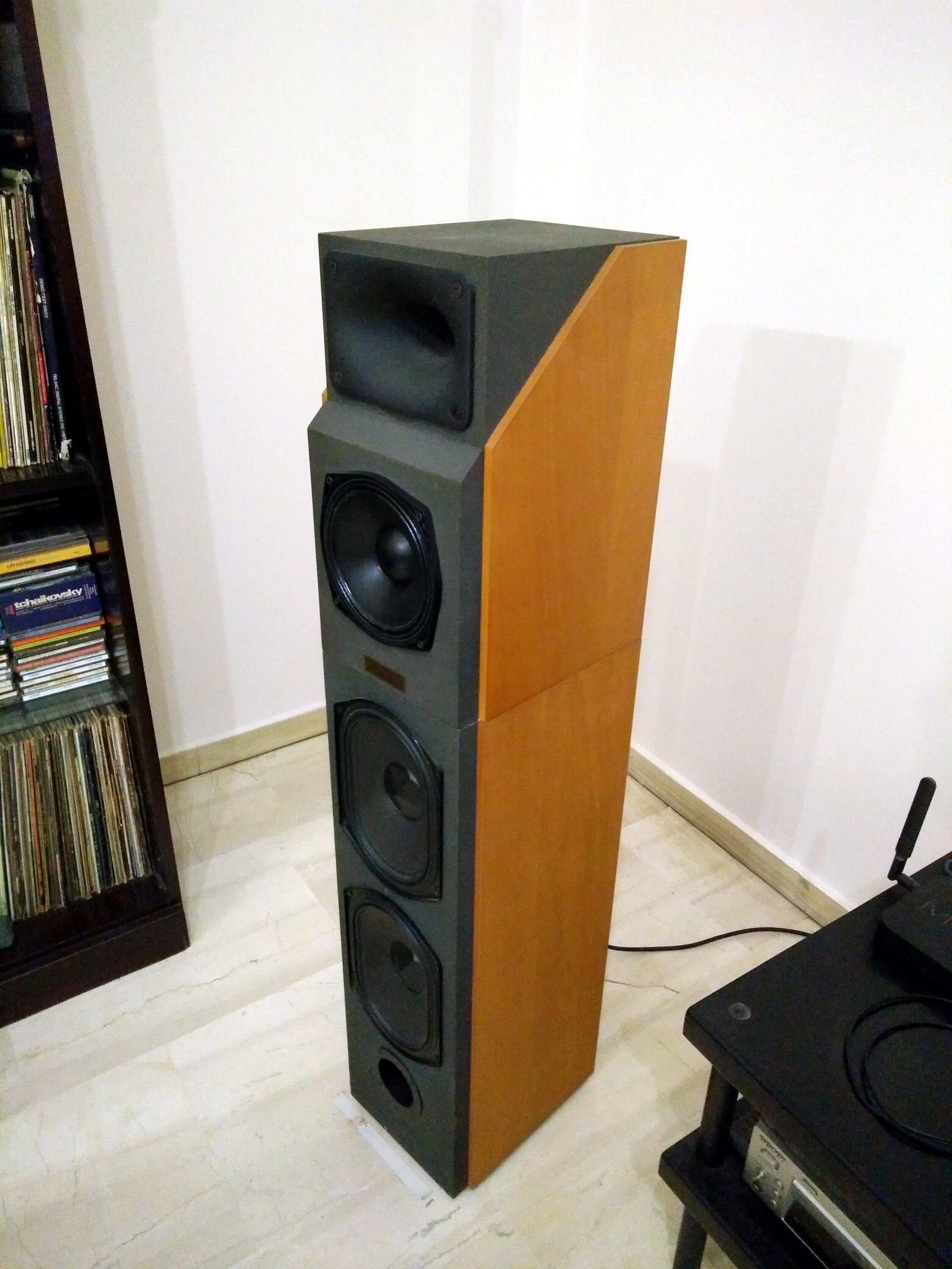

Standing 1118mm tall its challenging to fit in a standard post envelope 😀
this is the height including the tweeters?
did you by design choose compression for your speakers chassis?
Yes that's the top to floor distance, its a tall enough double cabinet speaker.
Wow beautiful speakers! Is the sub section simply ported out the front or horn areangement? (I only just started looking up speaker construction yesterday lol)
More details please 🙂
Sorry to derail this thread.

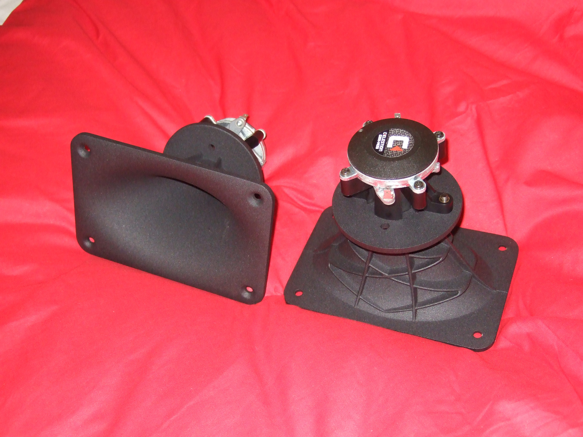

Its simply bass reflex. The horns & compression drivers inside the top cabinet look like this:
Very nice - do you use passive cross over circuit in the speaker?

Yes its a passively crossed conventional speaker.
