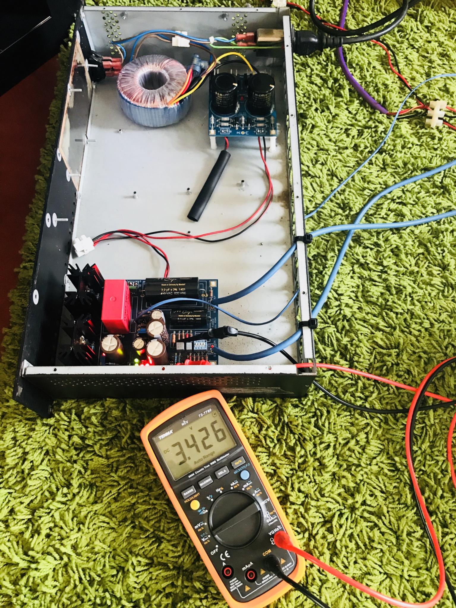

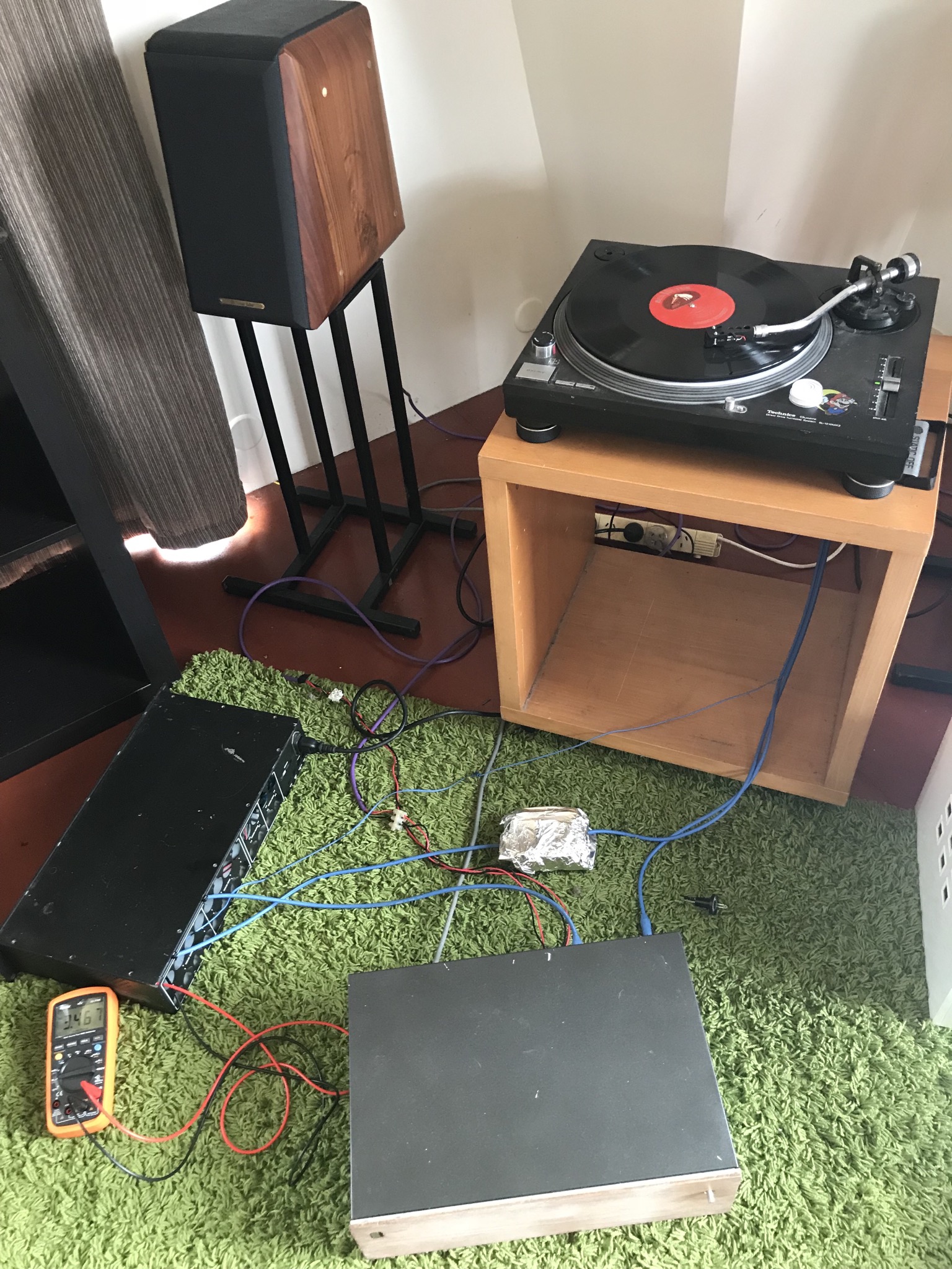

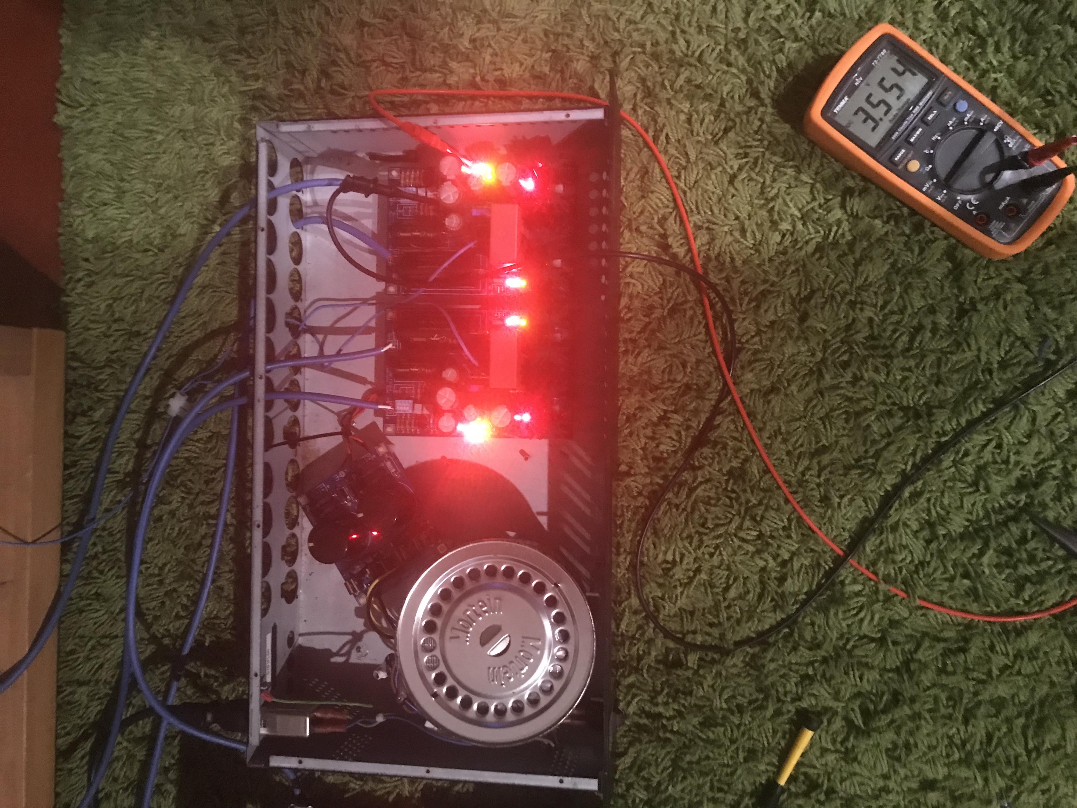

Due to a malfunction with my usual setup I decided to hookup one channel to my old lm3875. Just one channel as the other is missing a capacitor for some odd reason Anyhow.... whoa! Bloody ripper. Honestly I was not expecting such a difference. Even my wife noticed the improvement and that’s saying something. Looking forward to boxing everything up neatly, I can only imagine the potential. Again, thank you Salas, you’re a brilliant and generous person.
It’s taken me ages, bit by bit slowly. To be honest I nearly gave up this project because of life’s little turns. I’m so glad I stuck at it and got it running. A great feeling of accomplishment and it really does sound great. I’m going to keep working at this hobby, the joy I get when I hear the music play is priceless. btw you really should build one Chris.
Nice. The other channel misses that reversed and cooked C8's replacement I guess. If the toroid in the picture isn't magnetically shielded it has the potential to throw some hum field on its nearby MC sensitive channel when it will be repaired and installed. Its not certain it will really intrude, but if it will, a copper or Mu metal band dressed around the trafo can help a lot in reducing its field. Nuvotem Talema :: Custom Design :: GOSS Band
*Many times just rotating the trafo for its secondary cables exit area to face most away from the sensitive electronics and their signal cabling gives a good improvement.

Nice progress up to now
Hey, you can FFT the output on your Keysight scope and look for the 50Hz hum band and its higher harmonics. Then watch them going down or up when manipulating the build for grounding scheme, rotating or shielding with a flux-band or moving the trafo away etc. Is the pcbs ground also connected to the chassis as it should? The Y cables should attach to the chassis too. Lift one lead from just one of those two 1 Ohm resistors in the air. Is there any change in the little hum? You can even Bode plot the RIAA curve with that scope! (Maybe it takes a 1:100 two resistors divider 1k series 10R shunt to feed the phono for better SNR from the scope's gen or not)
