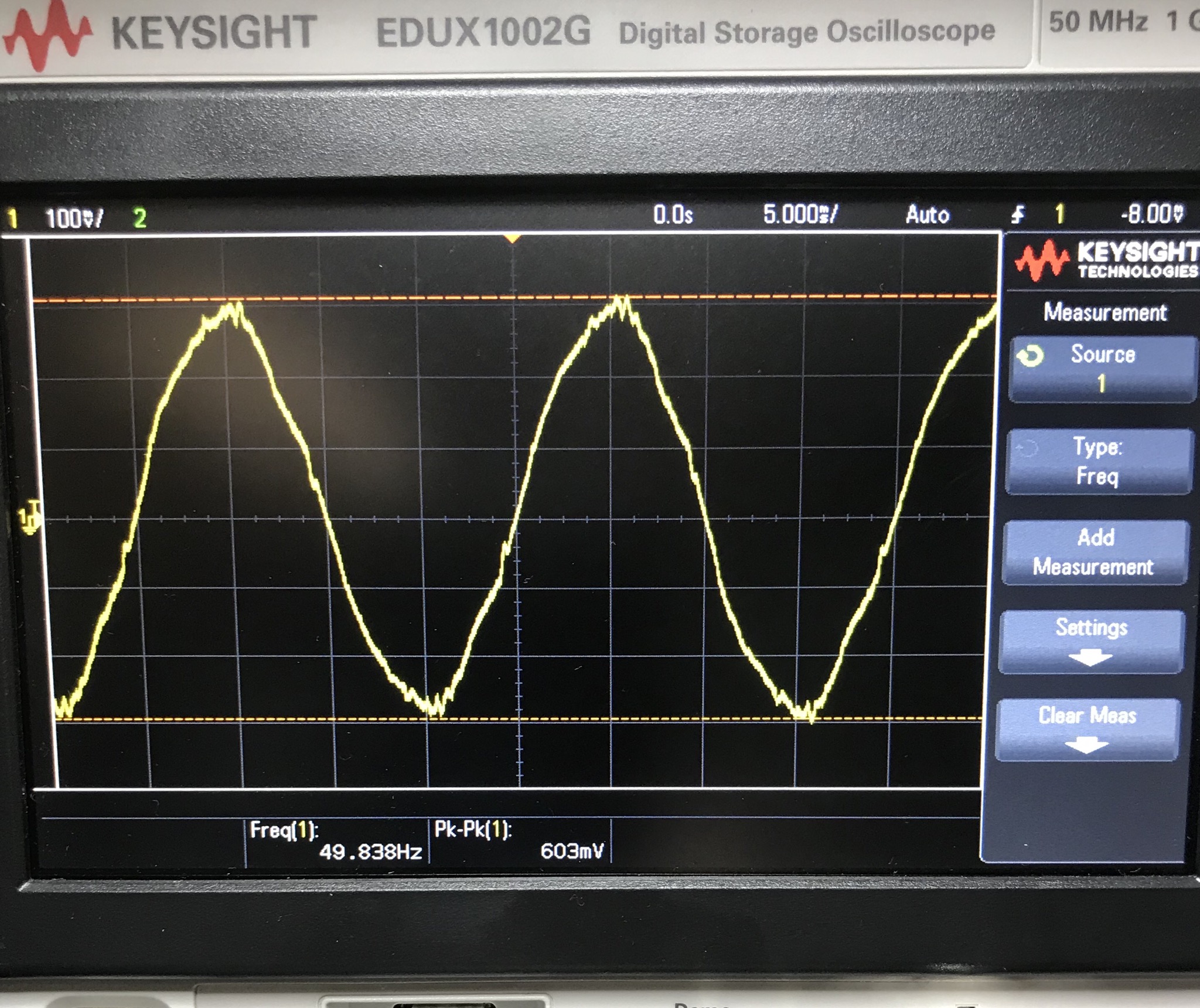

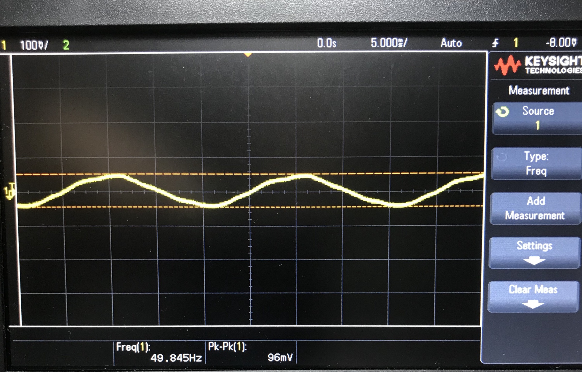

As you can see in the photos, there is a small hum 😉 around oh let’s say 50Hz 😉, maybe coming from the transformer 😉.
See the 96mV being picked up before I connected the output, then straight up over 600mV when connected.

Hi Bix,
Your AC path is short, direct. Good planning.
Try to rotate the transformer and see if it changes. Nice 'scope.
Don't forget that the output is also another input, so you might have to dress your speaker leads away from the mains plug and outlet in case they run close.
-Chris
He should also attach the thinner pcb zero blue cables on the chassis before making them to Y for meeting the TT's ground lead. The raw dc board's earth isn't going to the chassis also it seems. There are further possible test things after doing those things mentioned. Like lifting a leg from one of those 1R if there is a loop because single chassis, safe lifting the mains earth from the chassis with a bridge and RF bypass etc.
Hi Salas,
No, the AC mains ground must connect directly to the chassis. The signal ground should connect to the chassis through a resistor to break any possible loop. That way the user is protected as he should be, and the signal ground does not suffer a loop. Usually a resistor between 10 and 100 ohms is used.
-Chris
There's a phono box at pcb's regulated psu ground potential to shield best and attach the TT's ground wire lug. The zero lines also go back to another box that houses trafos and the raw psus through loop breaking resistors and yin yang diodes to the mains protective earth. That box is at PE directly. Between them boxes the umbilical's screen is only one way connected.
By the way 600mV pk-pk is 212mV RMS and Bix would have had a big loud hum at the speakers and not some "bit of hum" as he describes. The probe's very high impedance must be allowing more than his amp's input load or there is more mains earth looping between the scope and his handy test chassis. Especially if the probe is not on spring tip short gnd and near enough to that big trafo.
