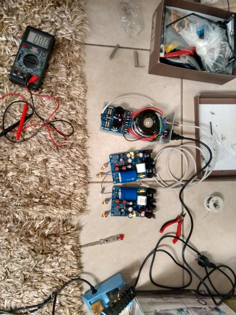

Hi Nick
Phono MC low assembled in final chassis (photos to follow later), and i was taken some measurements to adjust it
I make the following list in a 3hours:30 mins period , measuring the TP1-TP2 Voltage and here are the results . Temperature in the room is around 25-26 Celcious
Time TP1-TP2 V % offset from 3.6V

Seems that TP1-TP2 Voltage needs about 2 hours to reach the 3.6volts but it keeps raising, do you think is ok or i need to adjust the trimmers for less Voltage so it wont go at the 4volt range?
Thanks in advance

Check from C3's input point to ground for when its 4V and for what TP1-TP2 Voltage that happens. So you will know the exact TP1-TP2 target regarding your parts tolerances. Then keep that as median reference to float about with your trimmers.
If I understand you actually mean Voltage accross C2
V C2 TP1-TP2
4.115 3.623

So what you mean by target reference to try to keep
Yes saying across C2 its the same thing. So keep as your TP1-TP2 median the 3.74V figure.
Just start from cold with the case closed, have test leads on the test points that connect to a DMM outside, in an hour quickly trim for that median. Then close the case and leave it alone.

Thanks Nick
I do work on a closed case with test leads come outside the box for measurments anyway. If I open the lid even for few seconds voltages go away🙂
So I need that median value within an hour, that's what I needed to Know.
Do I need to check those Voltages when room temperatures raise during summertime? ( Or use the aircondition🙂)
Of course you can perform a periodical trim. The signal at Q3's collector could be 200mV pk-pk for 0.5mV input so even 2V DC bias across R4 will be plenty (20dB) to include peaks. That DC bias is measurable across C2 also and its 4V when your build's TP1-TP2 is 3.74V.

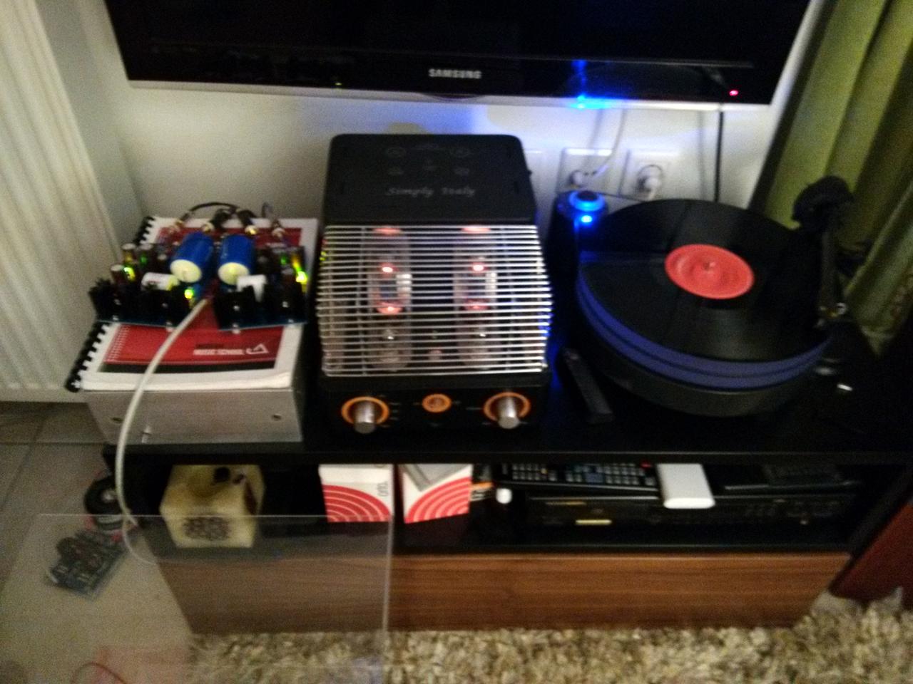

Quick question which I probably already know the answers to. I haven’t gotten my turntable out of storage yet, but after mounting the phono stage and all on a piece of particle board, I hooked up a headphone amp and did a bit of testing.
1) Significant amount of hum at mid volume and above. The inputs were open; I would guess I might want to short them for anything meaningful?
2) I have the inputs wired as twisted pairs (mm configuration). Touching either of these, or getting my hand near one increased the hum. I think I will redo with coax?
Will get the turntable out in the near future...
If you are using the RAW DC board lift one of those 1R and see if that makes a difference at least for when the build isn't housed in a grounded box yet
^ I'm not (I'm using a pair of GRLV supplies). No connection to ground or AC ground pin currently.
I know on discrete headphone amps I have built, the inputs need to be shorted if testing without the pot in. I know that R1 || R1x-R4x do provide input loading. Shorting the inputs may only mask issues?
Is testing in this manner even valid? Just trying to do as much performance validation as I can before I get the table out.
Yours is not a standard build for board and PSU so I can't tell for sure if there are issues right now. Normally its reported quiet even in MC mode without any special measures while just thrown around. Tell me your DC voltage on the drain of each JFET vs GND and if there's no doubt they are originals.
"Playing fine, noise is close to zero without a box."
