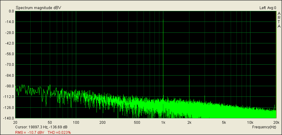

Sorry, lpad? I’m not sure what it is. Are you saying the gen will be noisy at 1 mv.
https://www.electronics-tutorials.ws/attenuators/l-pad-attenuator.html
My SDG2042X Siglent gen is one of the cleanest economic gens and I wouldn't consider it pristine at so low output levels. I always use a voltage divider for testing phonos. Especially when using ARTA etc. See the FSP's true noise (LMC mode) here in non averaged grass. To do such 24bit graphs without external interference I have the divider's resistors shielded in a copper tube with female RCA in at the back and a male RCA out at the front. The audio interface's signal passes through to enter the phono after a strong division. The audio card has much supersonic noise. Must be divided. Economic scopes are 8 bit BTW. But they enhance the basic ADC's 8 bit 50dB SNR with their memory oversampling in FFT.

In that graph above I fed 1/4 mV to the LMC mode FSP (62dB gain setting). I used 1/200 division to have a usefully steady 50mV original signal from the audio card. If I asked for such a tiny 0.25mV signal straight out from any gen or interface it wouldn't even bother to be produced not to mention chances of making it through the interference pass its output BNC socket if it dared be produced :D

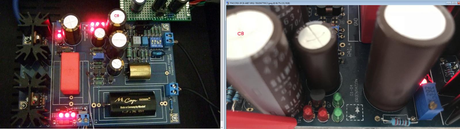

Wasn't put in wrong polarity for sure?
For sure! Hmmm sure
It was populated in wrong polarity after all. That was the cause of your troubles, not an intrinsically bad cap. Check the negative orientation stripes on C8 capacitors in the combined picture attached. Contrasting a picture saved from my prototype build vs yours while debugging.
