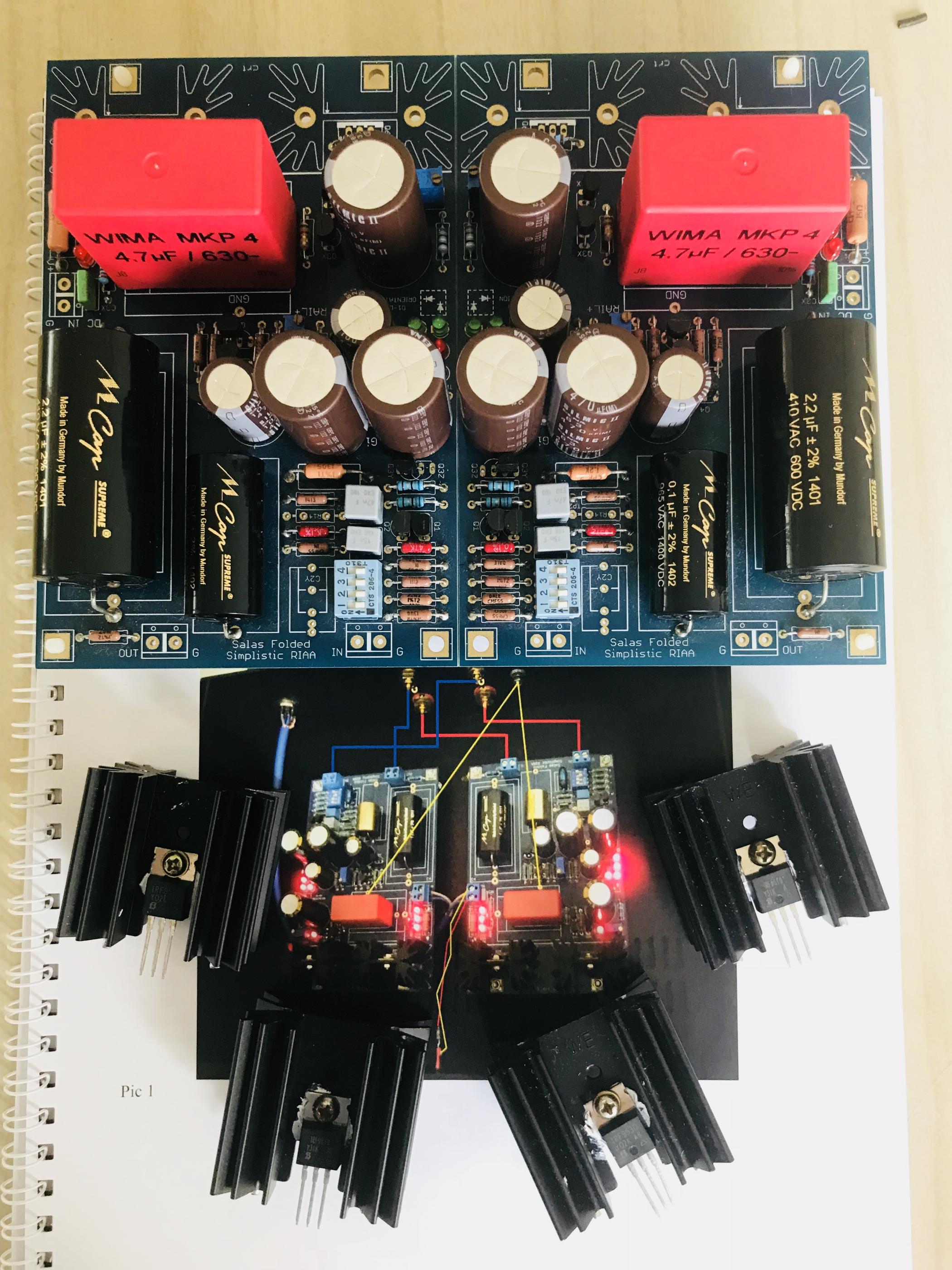

Any recommendations for semi orientation in an FSP? This is how I have it laid out right now:
Ch1: Q1 12.41 Q3Z 657.1 Q4 8.37 Q5 7.77 Q6 8.37 Q7 5.69
Ch2: Q1 12.41 Q3Z 655.6 Q4 8.37 Q5 7.78 Q6 8.56 Q7 5.71
This is for a 40 or possibly a 43dB configuration.

In other news, things are coming along nicely. I’ll get the last bits of the puzzle installed and wait for my new scope to arrive.

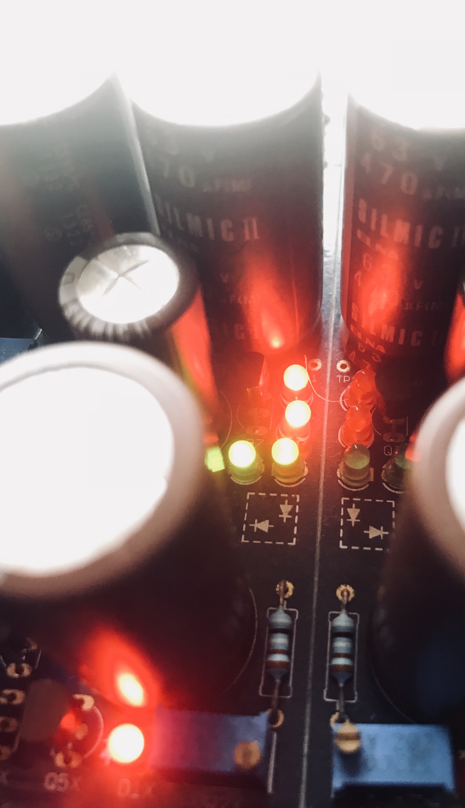

One channel lit up. No smoke!! So I’ve cranked up vr2x to max and I’m getting 30.83 vdc. Looking at the schematic... do I need to adjust R3x to 10k?

More R3x value will do, you are near. If you now got 9.1k replace with one 11k resistor or two 22k resistors in parallel for 11k. Can hide one at the bottom side. That should give useful 30.5V to 35.7V adjust range with the 2.56mA current you probably now got in the Vref.
Do try 10k R3x that you got in hand for now. It will maybe suffice for your TP1-TP2 adjust needs. I can't be sure of the exact JFET current you now got in the Vref. I am speculating it from your results but there is some tolerance. The other channel might not need something else even, depends on what Q3x JFET IDSS it chanced.
