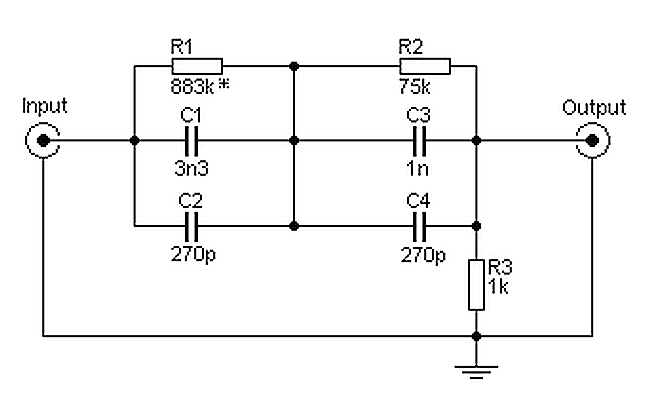

LSK170s for 2SK170s that you may find around and Tea-Bag still has matched original 2SK369s for its input stage I think. You can just put a textbook anti-RIAA filter between the voltage source and the circuit's input in LTspice.
Salas also guided me on how to alter some resistors in case Q4,Q5 are not in specifications. I think the only solid rule is Q6>Q5. The IDSS ranges for those are indeed hard to procure from original specifications.
There are quite a lot anti-RIAAs in the web!
Would this by Rod Elliott be fine?
Do you suggest any other?
