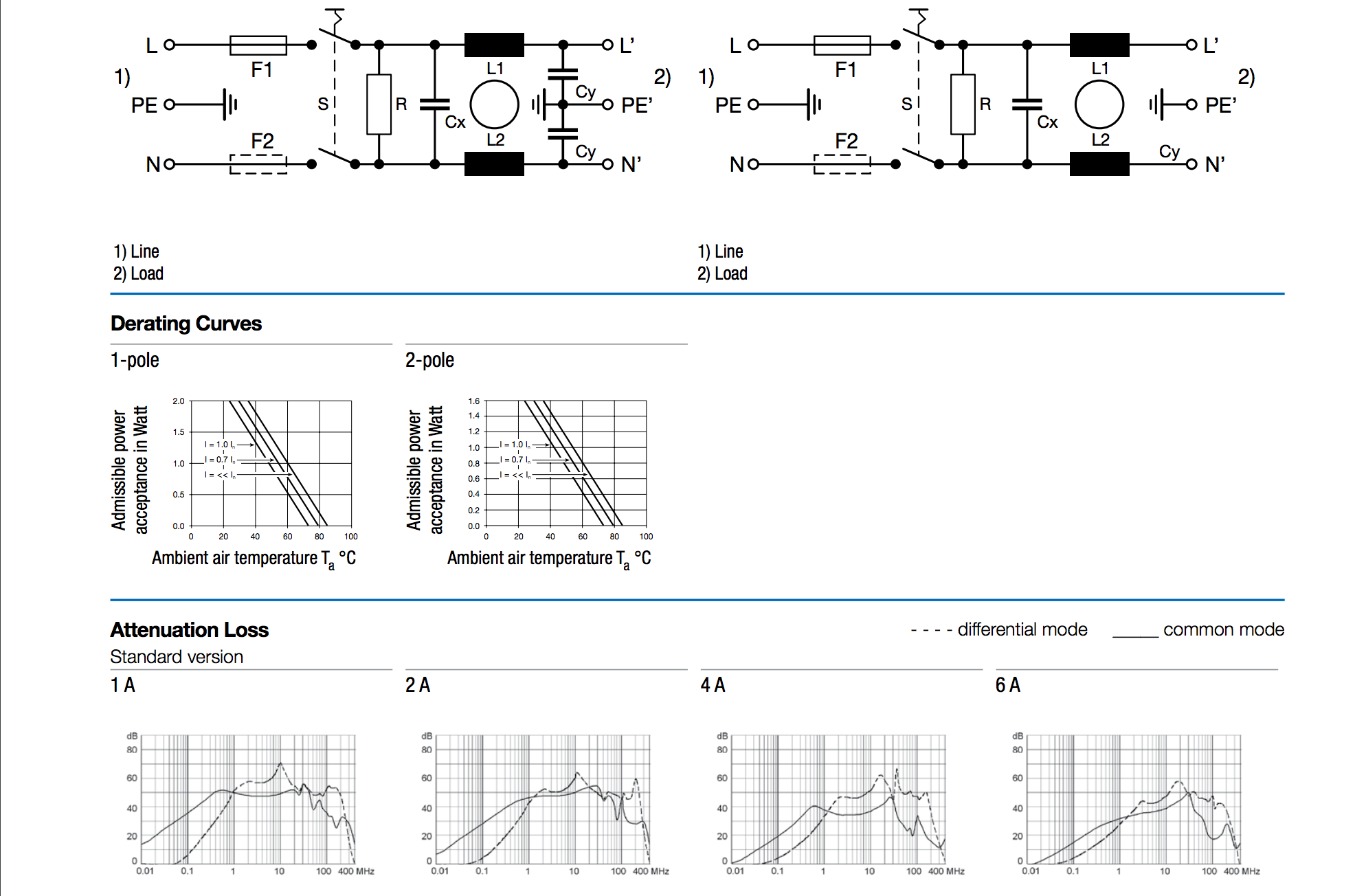

What do you guys about those Schurter type in line filters? They are quite more expensive vs simple power entry models. Effective enough?
Also, I would like some help reading those graphs. Do I understand correctly, lower current models provide better filtering?
All the data I have seen shows the higher current models havingless effective interference attenuation.
It's probably due to the higher current common mode inductor having fewer thicker turns giving less impedance.
Don't use the "Medical" version shown on the right, unless you have a medical specified piece of equipment that requires it.
Thank you, Andrew. How do I calulate what's the lowest current model possible knowing that FSP draws about 100mA per channel. My guess it's 1A. But I don't want to guess each time.
1A from a 220Vac mains is equivalent to 220W. That's a lot of power for a domestic system replaying music audio.

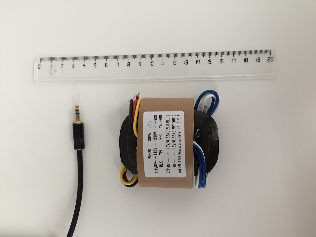

R-Cores from Asia arrived.
They looks suspiciously small.
Or I think they look smaller than my previously owned 30VA R-Core.
I might be wrong.
Including a pic with a headphone jack as a reference.
Is there a way to test them if they are specified correctly and well made in general?

That certainly is compact. I see the transformer has two secondary windings, each rated to deliver 18V at 830mA (14.94VA). You will need to connect them in series.
Start by measuring the output voltage of the combined series secondaries unloaded. Also measure the mains voltage on the primary (VERY CAREFULLY!). Now lightly load the secondaries, say about 4K Ohms resistance to draw about 10mA, record the voltage. A one Watt resistor should be OK, but as you draw more current the load will dissipate more power, so you will either need more resistors in parallel or higher power resistors. So now draw about 50mA and see what happens to the voltage. Then 100mA, then 200, etc. Monitor the temperature of the transformer as you draw more current. Watch the temperature of the load resistors too, you don't want to start a fire! You don't need to go beyond about 400mA total to get a good picture of the transformer's regulation.
Remember the FSP only draws around 100mA per channel, and it uses a shunt regulator with a constant current source, so the load seen by the transformer is constant and independent of signal or load on the output of the preamp. If you can draw 100mA (roughly 400R load, you will need at least a 5W resistor or parallel a few higher value resistors of a lower power rating) and the secondary voltage stays near 36V (for some value of "near") and the transformer doesn't get hot, you are good to go. I would also test at around 200mA, just because.
Found a 30VA 9+9V R-core at home with the same sticker.
Same size. A little bit relieved.
