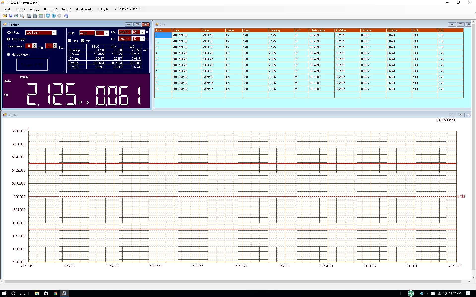

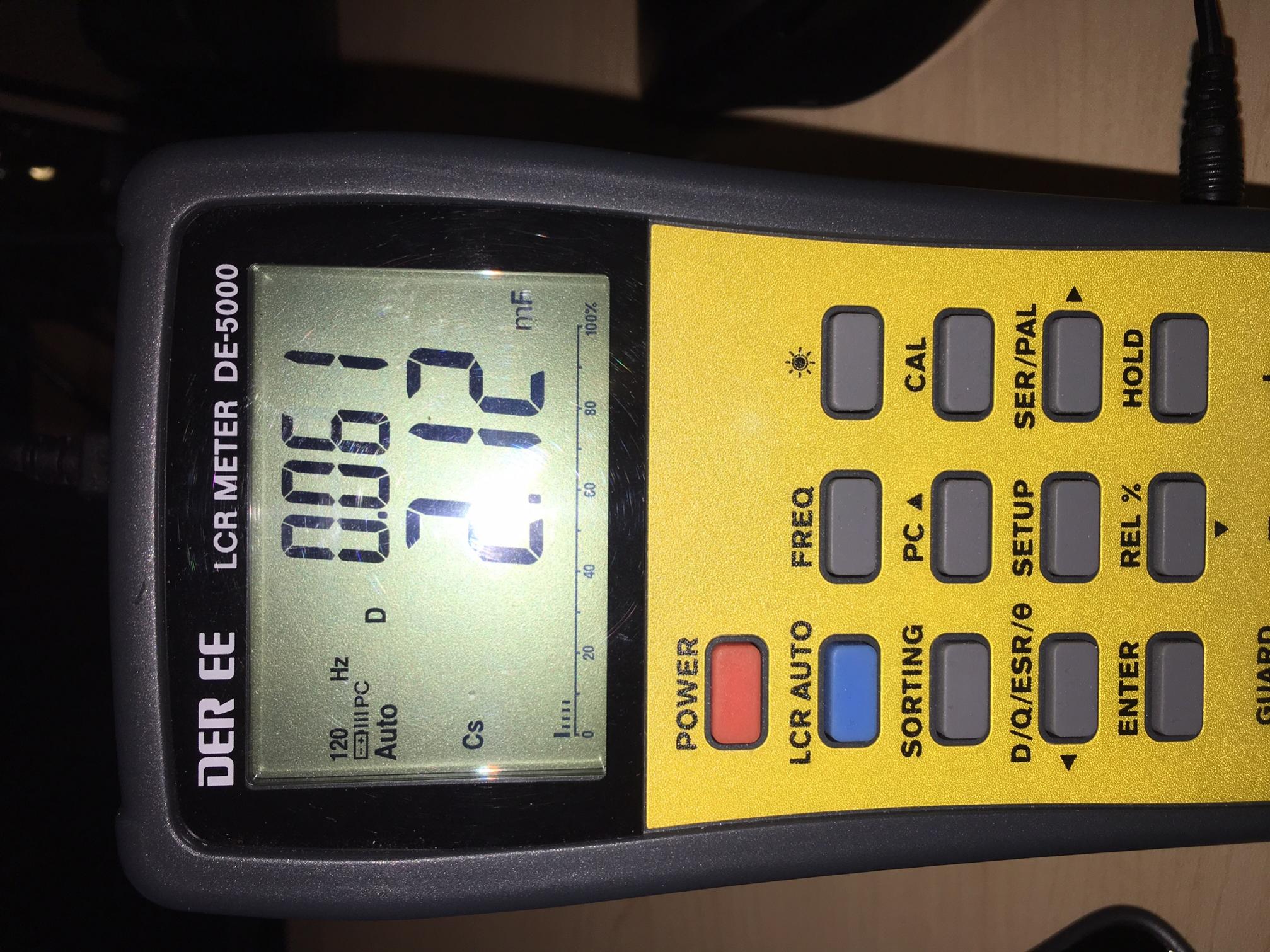

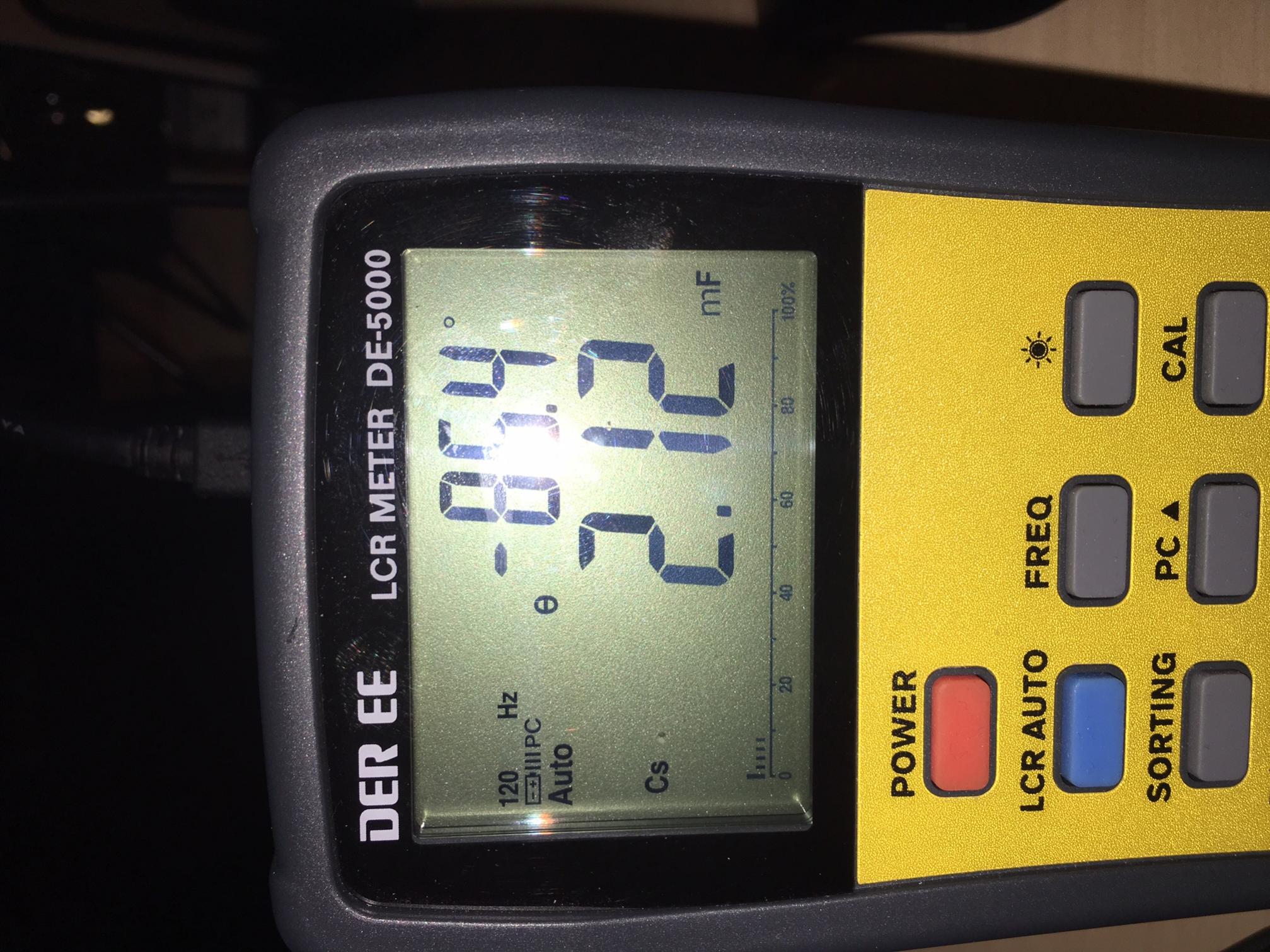

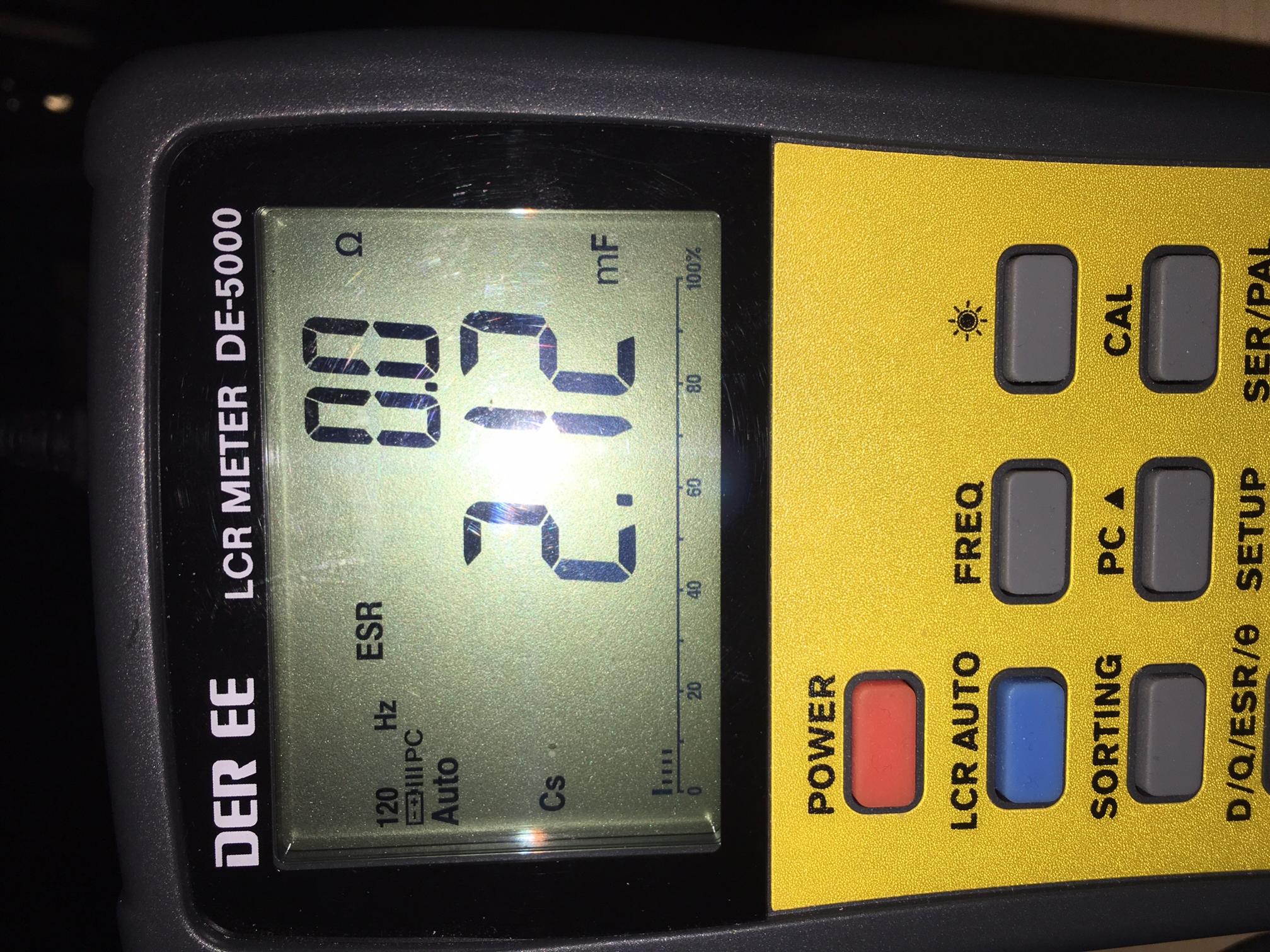

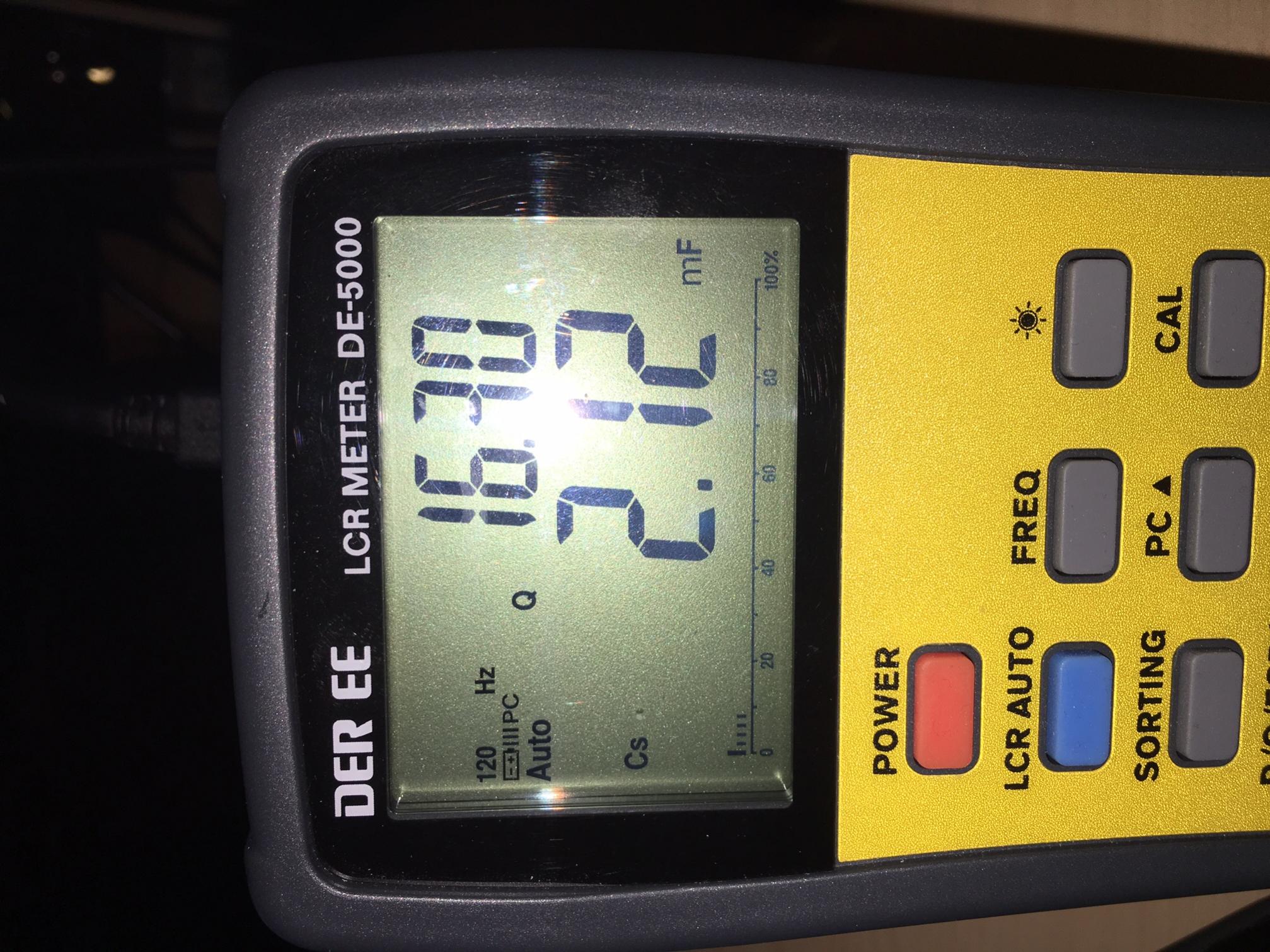

I think so. Please see images taken from device LCD and same cap measure on PC screen via USB.
