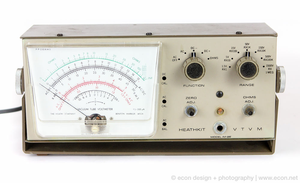

As for the VTVM reference I was just remembering doing tape deck tune-ups many years ago. We had a digital meter on the bench (all red LEDs back then) but doing finicky adjustments was much easier with the analog meter with a fairly slow ballistic movement. Today we digital meter readers tend to focus on the least significant digits, because we can, ignoring the fact that they are not significant.

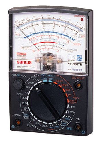

The analog meter lives on. There is a surprising large number of models available. The classic brands like Sanwa still produce. Some cheaper brands like KTI look rather nice value.

My first meter was analog of course, a Lafayette TE-12. Japanese vintage model of shiny black bakelite case like a 1950s telephone with an arched top beautiful panel. Served me for many years and it survived a number of drops until I managed to break it.
I ordered a modern Pro'sKit MT-2017 budget analog meter, unfortunately of rather gaudy colors, to also have an analog once again. For bringing back those watch the needle memories. Plus there are special cases of measurement where some analog practicality still excels as Nezbleu correctly reminded.
