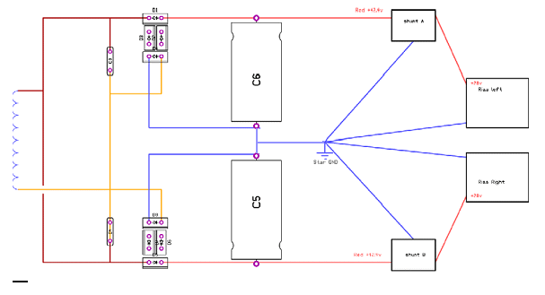

RCruz said:I really like this hands on aproach... I keep learning that way.
Below is the present GND layout.
Now I have a superlative Phono replay system.
Ricardo
Nice clean drawing. Very informative for those to build in the future.
So as the master tweaker of this thread, you recommend up to now, a heavy toroid (how many VA is yours?), 2 fast bridges (what you use?) 2 shunts, wiring as in the posted zip, for guaranteed non hum infested, expertly voiced sound reproduction. Parts choices as shown in the most recent picure I guess.

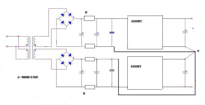

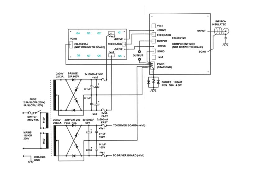

nicoch46 said:humm,as I dont use heart and separate dual mono ,is ok??
PS Salas shunt for amp drive stage
Depends on how the rest of your amp will be grounded.
nicoch46 said:like this ?
as I have 2bridge
Like this:

Hi,RCruz said:Below is the present GND layout.
join C5 & C6 zero volt pins/screws.
Run one wire from zero volts to star ground.
Measure hum and buzz and noise before and after this modification and let us know if there is any change.

Salas said:Long tail common return, to avoid star contamination, D. Self style?
Gentlemen
All morning I have been rewiring the GND because I still noticed some hum with yesterday mods.
I decided to connect the second cap GND to the first one and than run to star..... this reduced a lot the noise so I decided to post the revision.
I was tottaly surprised when I saw your comments.... Your suggestion is exactly what I did. It works wonderfully.
It looks like a worldwide brainstorm
Ricardo
I do not know how to measure noise in the ve lines so I depend on my ears. Maybe you use a scope for that purpose ?!
I am glad I found the solution but I only used common sence (reduce gnd loops visually) and hearing the results while taping a 10r+wire from the second cap GND to several other GND locations... The worst was connecting it directly to the star and surprinsingly, it disappeared when I connected the other end of the wire to the 1st cap GND.
Thanks to you I now understand why it works.
