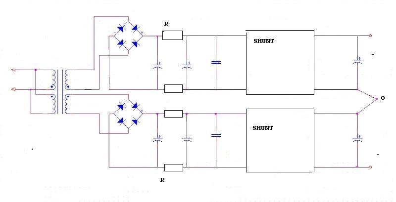

Nice Ricardo. I have experienced similar gains in Michael's double PSU one that I have shown here before. I would suggest you make an experiment about cutting on dissipation a little and see if your sound is still the same. Try to listen with 8R2 and 10R shunt's R1 at a point.

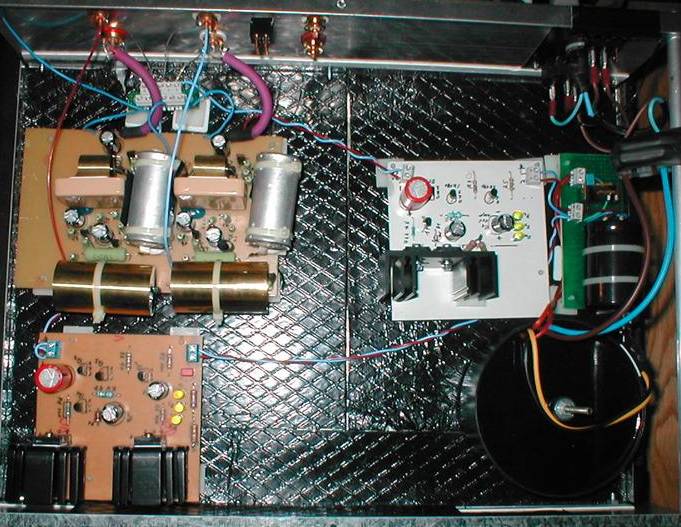

I am noticing an unwanted increase in hum... right channel... now powered by the new shunt "b" coloured brown.
There is a lower freq noise in this channel (it is buried beneath the surface disc noise but audible when the pickup is not lowered)
The other channel also produces noise but not so audible in low freq.
Seems to me I have a placement issue....
must I build a gnd screen between the shunt and riaa boards ?

If you change the connections and power the other channel, does the hum migrate? Can it be a wiring issue?
I did not try that yet...
Do you believe a metal shield between shunt and riaa should improve matters ?
Can't tell if the problem is a field or a loop until you know. If its a field, yes, a metal shield will help. Move it to the right to test.
Moving the shunt does nothing.
After adding the second bridge + cap, the hum got even worst.
Disconnecting the TT cables eliminates the problem.😕

You have to revise your grounding. Start with breaking one channel's ground return to star with a 10R and see if that helps. If not, make a diagram with your grounding scheme and post it here so we can all think about the loop.
Just solved the issue.
I was connecting GND from bridge+smoothing cap to shunt and then to star GND.
Now I have the smoothing cap connected to star GND and shunt also connected to star. (Between smoothing cap and shunt I have only the +Vin lead)
No more hum.... sound is very good.... in fact is better because the hum has always been present but I only found it unbearable after placing the second bridge+cap+shunt....

it must be done this way.RCruz said:Just solved the issue.
The star ground is the voltage reference.
If the shunt or any sensitive circuit shares the main current carrying trace/wire with the PSU to star ground then the big currents will create voltage contamination of the low level signals.
As Andrew said, riding psu return currents on low level or signal ground routes is a no no.
