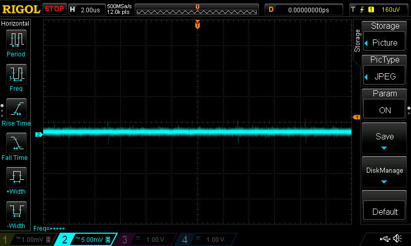

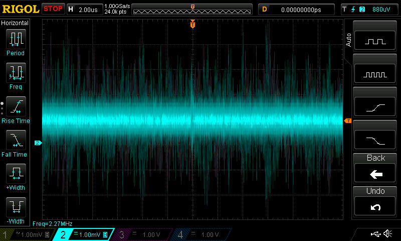

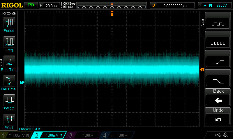

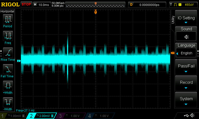

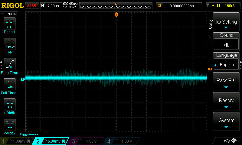

This circuit basically can not self-oscillate because there is no loop feedback. EMI can go in through the high gate capacitance and high gain input stage JFETS. There are ceramic core SMD 1uH coils or tiny diameter ferrite rings to try on the gate pins if such a situation is confirmed in an installation, though we don't have nearly enough such phenomena reported here. But there can always be a chance for an infected system. Even periodically.
Please see attached pictures.
1. It is when no noise
2. With Pup ups
3. Short pop up
4. little longer one
5. Short one low mag
6. Quite time high mag
7. Pup up high mag
No sure if I used optimized setting to catch it, but anyway it might give you some info about what I hear.

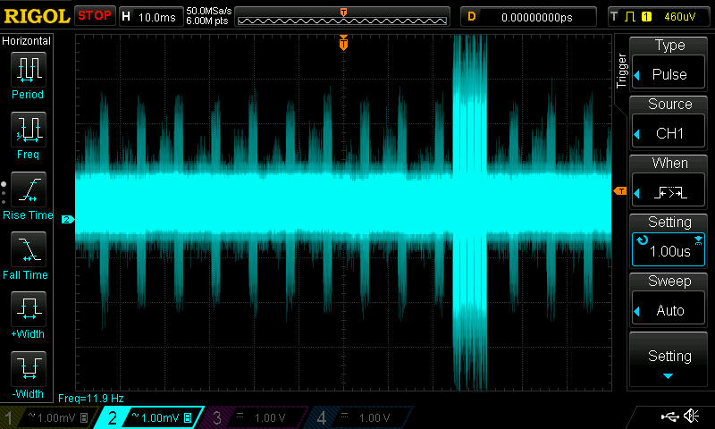

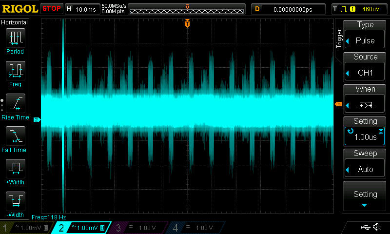

2. With Pup ups
3. Short pop up
7. Pup up high mag
The pictures are sampled on the audio output I guess. It looks like a transient event, not oscillation. Commendably quiet screen capture for your build when no pops.
I can capture on outputs too if that what will be more indicative for our troubleshooting.
Sent from my iPhone using Tapatalk
No. It is on input. Yes, it is quit when no pup ups.

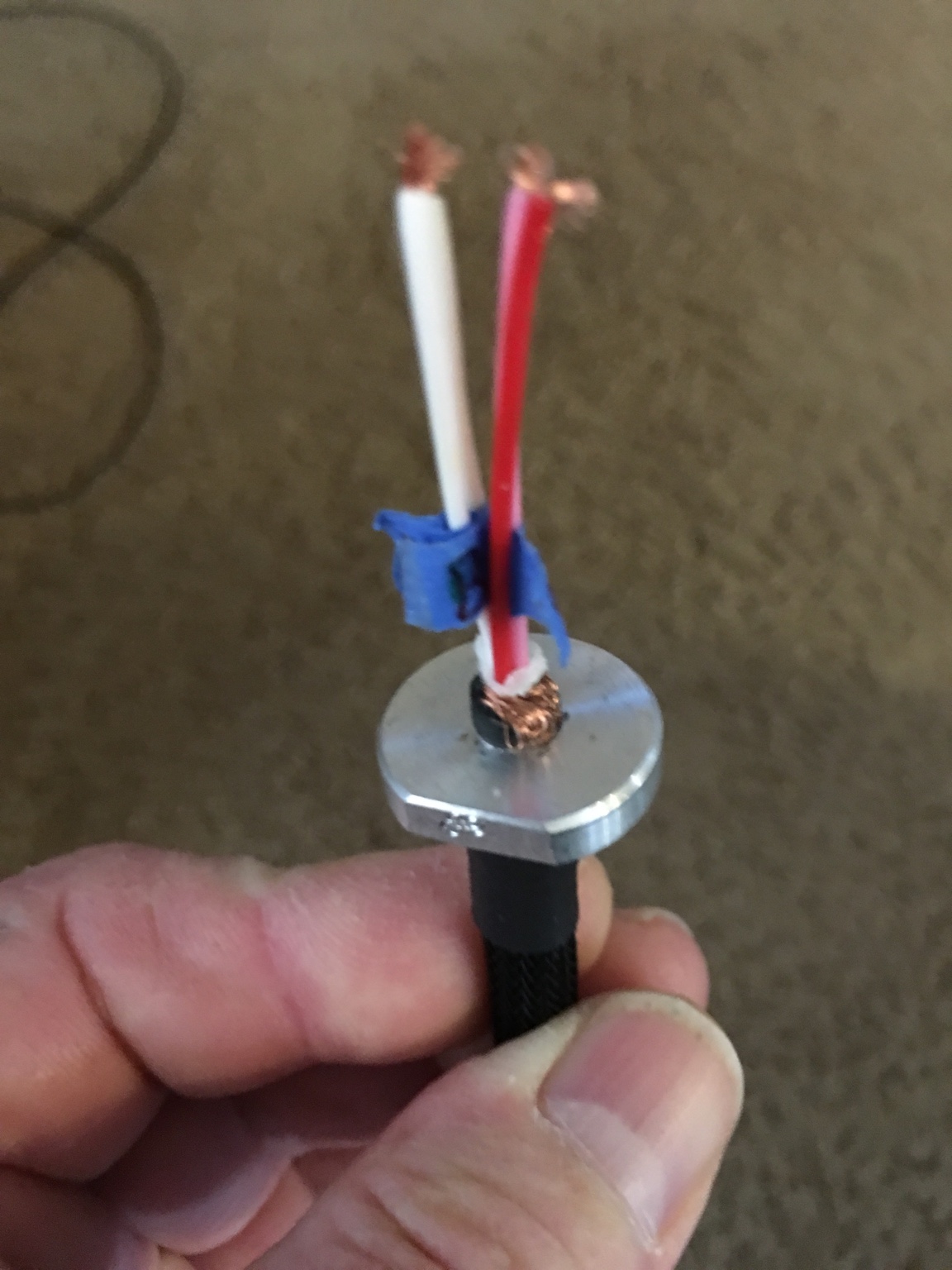

On input when the full TT is connected?
I connected cable include GND fork to FSP. Other side of cable is not connected to cart or even to arm. All wires in air.
Yes and I think that too. My question is if anything happened to my cable and its damaged now? If yes, I can buy same geometry (4 star-quad with shield) and replace it. That what I asked about Cardas made one.
It will not give me a full picture since no braid that I can use as GND. It will be pair of coaxes for R/L and one GND wire from arm to FSP.
I have this Popups only when I connect pairs and GND fork. No Popups if fork is off.
The RG174 is single coax RF cable. Has braided shield alright. Two of them can be used for separate L and R runs.
Yes, I agree and my cheap Generic has same construction (tow coaxes) which I already tested without ground. I need something similar to my noise Gotam ->2 twisted pairs with shield, 5-6 mm diameter max.
Maybe common shield between channels is what you should avoid. Better separate coax pair and a lone chassis ground wire.
I see. At that case I'll might try Mogami w2549 - two twisted wires with braid. I'll use two of those: one for L and and one for R. The question is where to connect braids together to avoid loop: I must connect arm GND to braid at the arm side, then I need to connect braids again at RCA side and solder wire with Fork.
