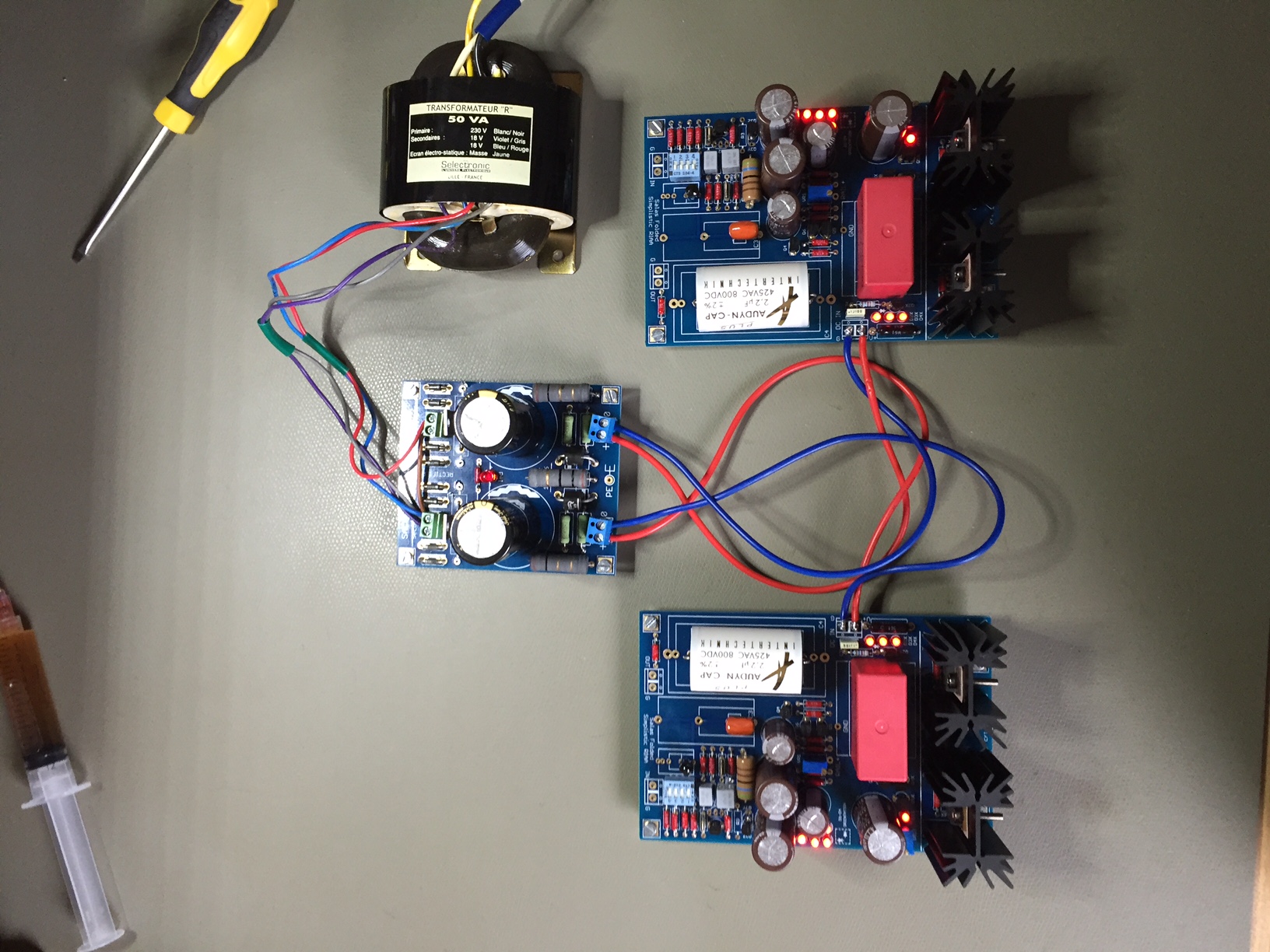

Rail 1 = 31.22 VDC
Rail 2 = 32.53 VDC
TP 1 / TP 2 both 3.600 exact.
Warming up.....
Rail 1 = 31.22 VDC
Rail 2 = 32.53 VDC
Warming up.....
After power on the whole afternoon I had to adjust a little.
Rails are now 31.25 and 31.55 VDC. Both TP1 / TP2 are now steady for two hours straight at 3.600 VDC.
I guess it's time to give these parts their home 🙂
For umbillical cord from Powerbox to Amp box I will use Neutrik 5 pole XLR connectors. I guess that should be fine.

Both boards warming up @ 3.60VDC Bias.
Looking good so far!
You only got one R-Core for two channels?
I connect the leads with kroonsteen..... don't know the englisch name for it... see pic. So nothing can touch the leads.
Screw terminals or barrier strips
Yes, I have one R-core. Is that not ok?
Raw DC without load was 51,5Vdc. With both channels connected 43Vdc.
I am getting the feeling I have to buy another trannie?
Thanks for the Enlish lesson 🙂
Optimal is to buy one more. Now you are using one with secondaries in series for two bridges. I haven't used that configuration I hope it will not hum. People either used one Tx with separate >30V AC secondaries or two Tx with high enough single secondary/double low combined in series, feeding each AC in on the raw PCB separately.
