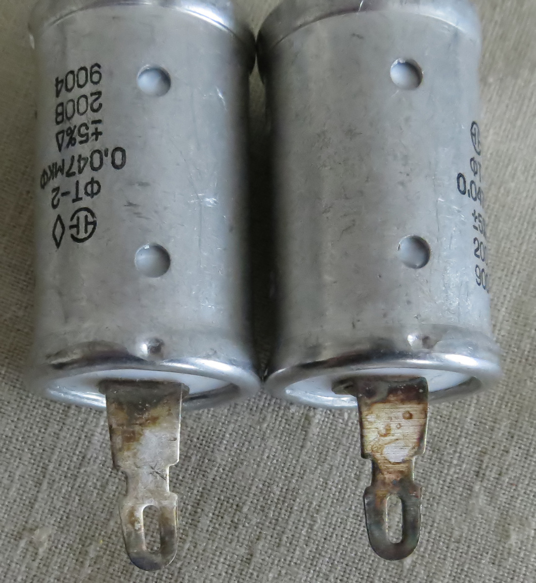

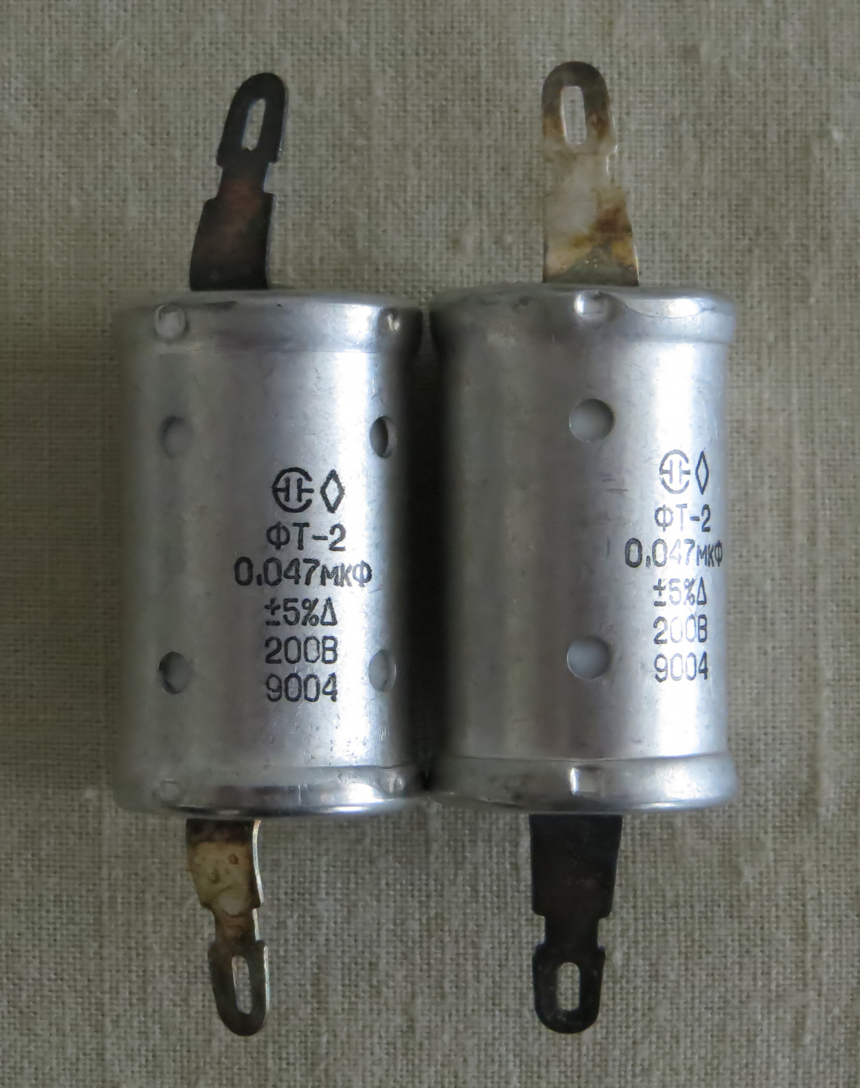

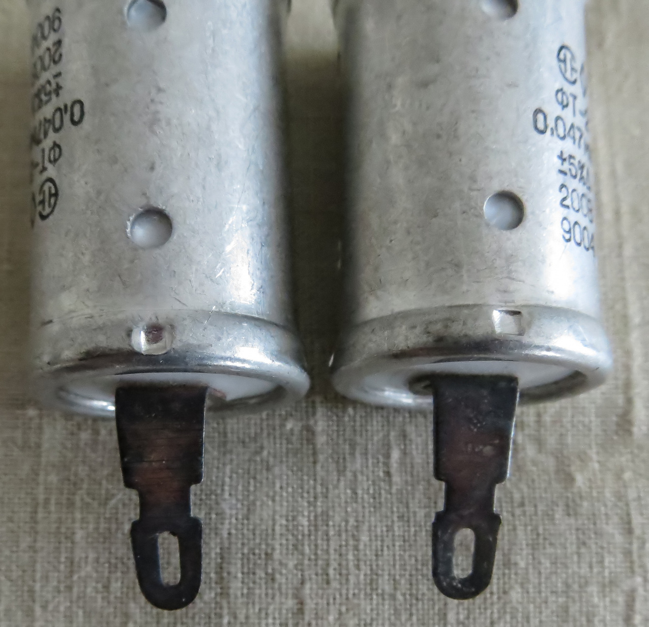

I received today the 0.047uf FT-2 caps im planning to use for interstage. The thing is that their contacts are really corroded. If i remember correctly the contacts are silver plated steel (dont remember where i read it). Any hints how to remove corrosion?
Ketchup and a toothbrush.🙂
😀😀😀 For a brief moment i thought you were kidding me...Then i googled it !
Whaddyaknow... 😀😀
Toothpaste (without rinsing on the brush or towel) is good too. Ketchup we may need to let it react on the tarnish for a few mins before rubbing.🙂

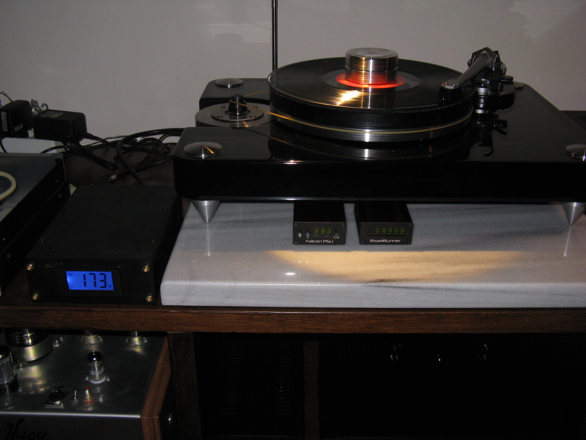

I was really puzzled yesterday, as I got a new tachmeter and PSU controller from a fellow member here : http://www.diyaudio.com/forums/vendors-bazaar/252742-digital-turntable-tachometer-dds-based-psu.html
With the test record I always got 303Hz when 33.33rpm spot on with the controller. I also read some other reports on the web, and it turned out to be the hifinews record to blame.
Also a laser tachmeter I got cheap on the web was spot on at his limited resolution of 33.3 only.
As a side note, Pyramid' s PSU and tachmeter get my highest recommendation. Excellent built, working perfectly and can be adjusted to almost anything.
The only thing is that they can output only 110V, so for the rest of us on 220V, you need a step up transformer. I built one in outside box with an A/C voltage indicator so I can monitor it, as it can be adjusted, in order to eliminate motor noise.
It' s the A/C voltage feeding the motor.
At start up it goes to 220 and after 3 seconds drops to a lower value that can be adjusted. The same does the VPI SDS, but here you can adjust if and how much to drop.
