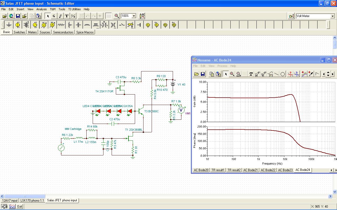

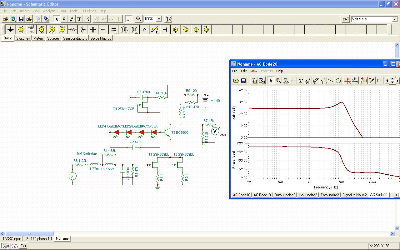

My simulations show that you need a buffer between the cartridge and the first JFET gain stage. Otherwise, the response is not pretty. The spice models I'm using are from the manufacturer.
You should put all the gain up front before the passive RIAA network in order to achieve the best S/N ratio. This one has a S/N ratio of 95dB @ 1KHz. Real world would be a little less than that.
Oh, and just to be clear. I don't mean to step on anyone's toes, or high jack this thread, or anything like that. I'm only trying to be helpful. This circuit is just something I threw together in 5 or 10 minutes. It's not "finished"....

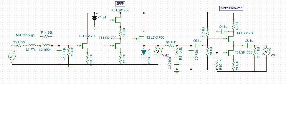

I added your cartridge circuit to my Salas Folded Simplistic spice circuit. There is no problem.
Jim
It doesn't look that good to me, but opinions may differ.

Still there is the mechanical aspect to consider, which varies widely between MM models. "Clearly the electrical model is not telling us the whole story" Load the Magnets!!! - [English]
You are simulating the MC configuration with an MM source model.
I'm sorry, but I don't see where it says that in your pdf document.
What's the difference?
Read the "Notes" near the end.

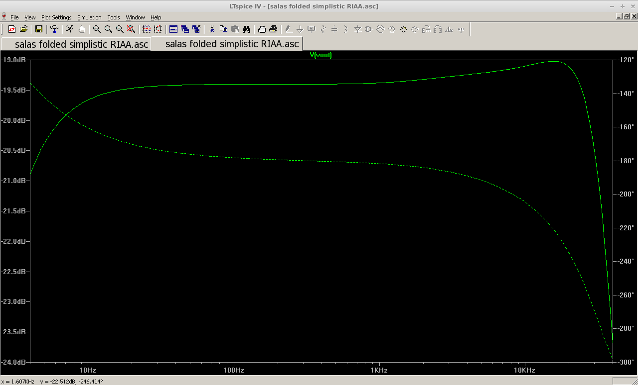

OK, I changed the values as I could find them in the notes. Not much gain and still a good bump. oh well.
From 5dB bump you went down to 0.5dB last octave bump. Which is not much there with MM carts and their mechanical issues, they struggle beyond 15-16kHz. They are responding to the R//C input loading choices much more for response shaping (#12210). Their final response is varying +/-2dB up to 15kHz at least. Total gain for two stages and filter is the 40dB standard for MM. HMC, MC, LMC are not inductively reactive enough and extend better due to lower pick up mass.
If you increase the input cap (100pf) does it get better?
