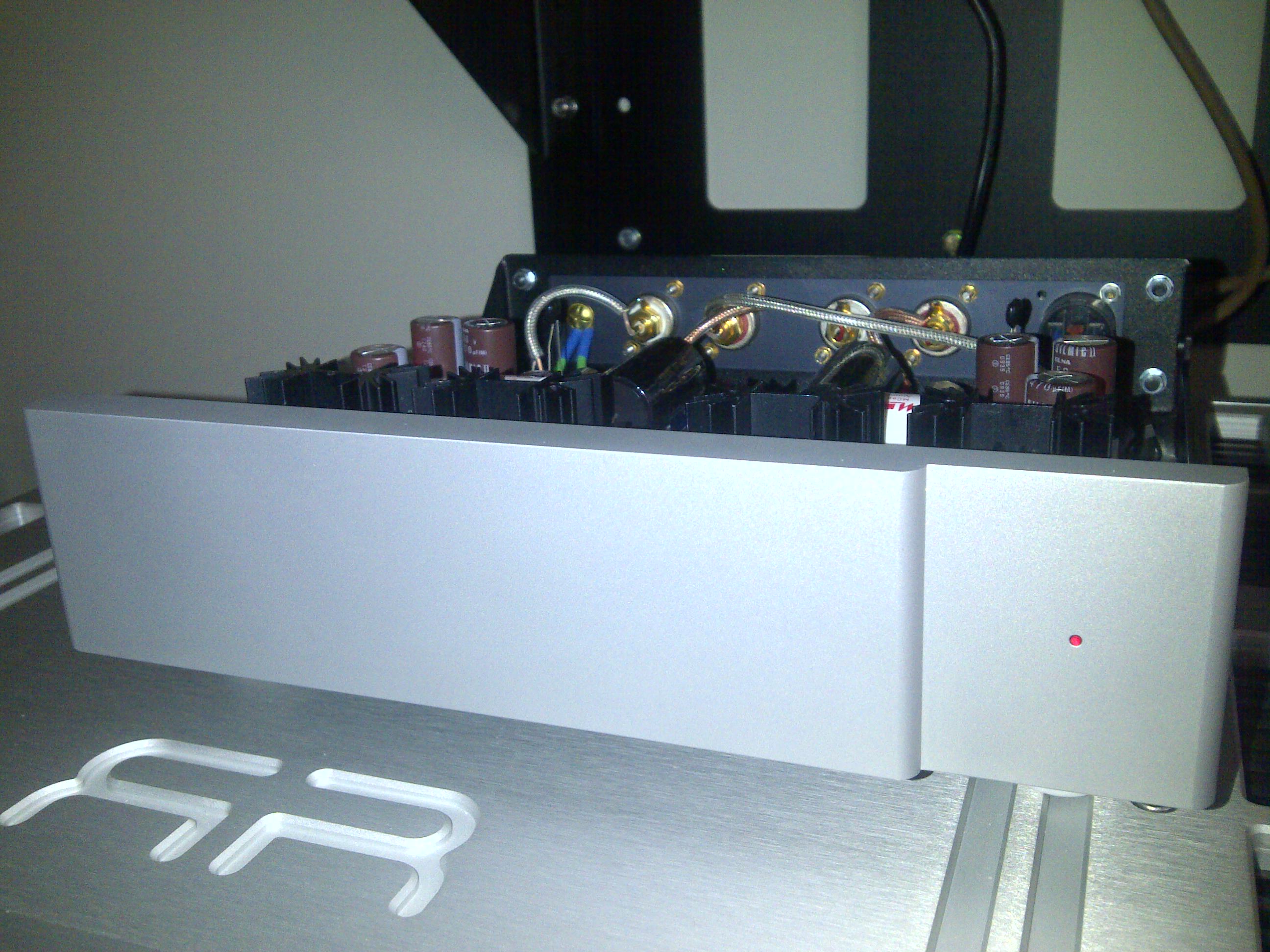

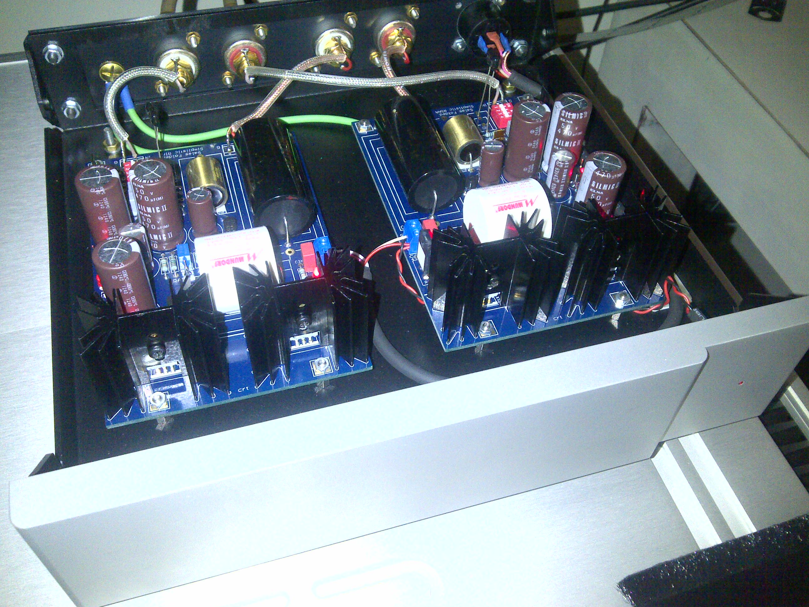

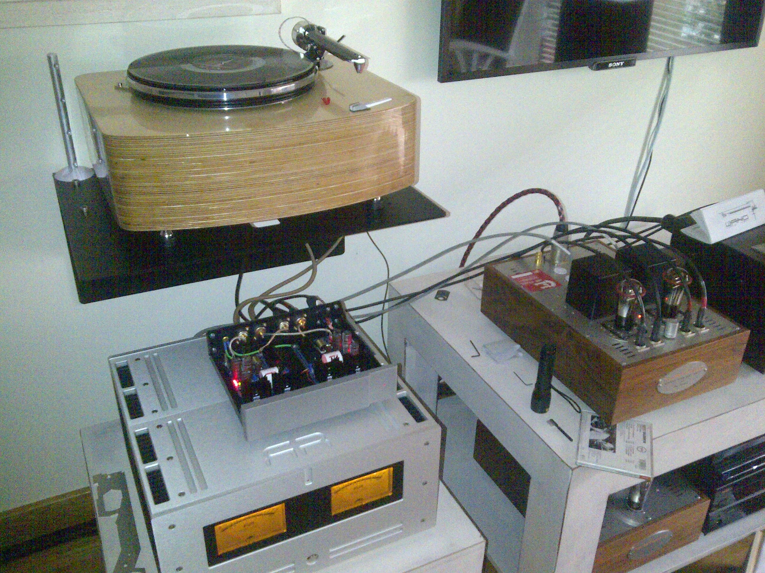

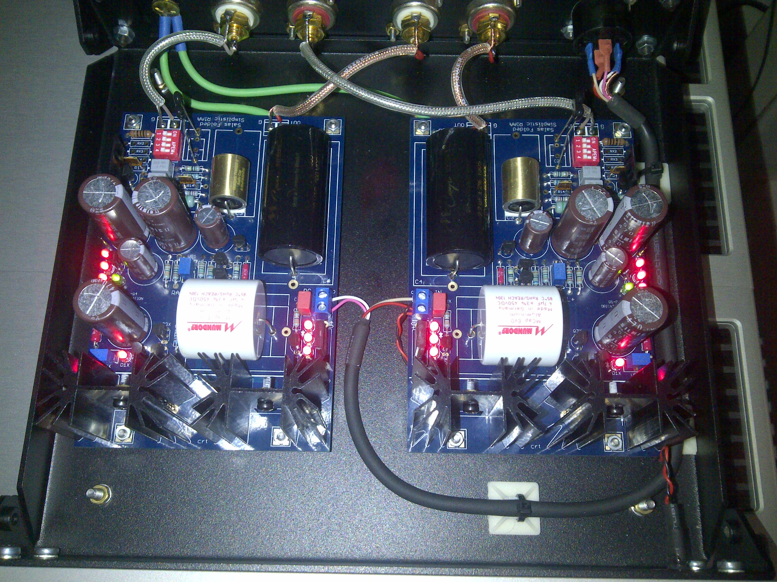

My finished Folded
Just finished my folded implementation and couldn't wait to turn it on.
After bench testing, trim setting and stabilization, all was well and working.
So, next step, connect it to the system, first impressions are very good, very silent (in fact dead quite), I will keep on burning it up, and do some tweaking. I just bought a Dynavector 10X5 but it will only arrive next week, then I will try and play around C2Y and so on.

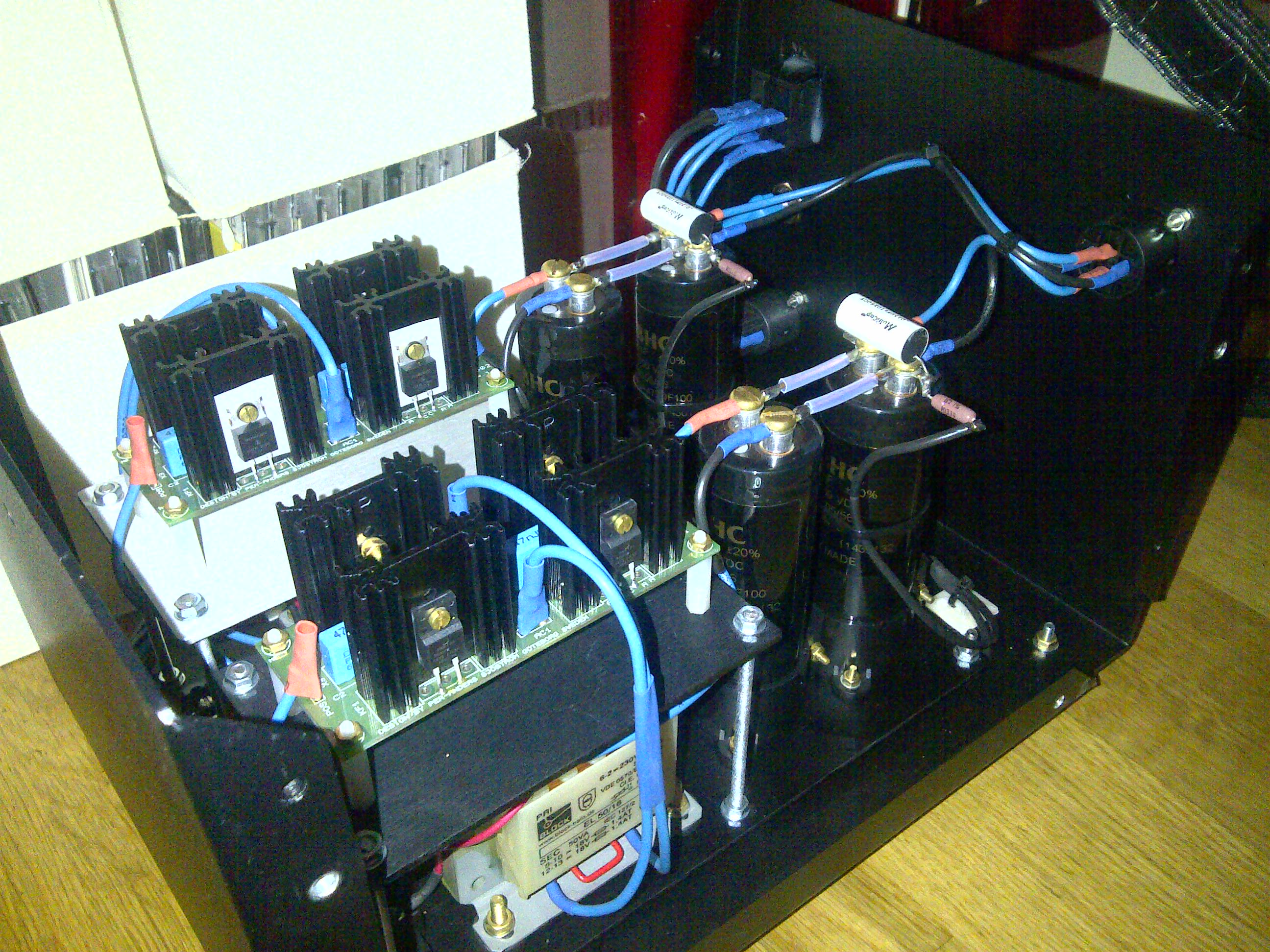

The PWS is based on 2 separate EI iron 50VA/2x18V transformers (German make and very quite mechanically), these are connected to a bridge built around IXYS rectifiers, all snubbed by an RC array. Filtering is done through 2 BHC 4.700uF each. Umbilical cord as specified on the Folded text, using Neutrik 4 pin connectors.
RIAA itself is built around the commonly used parts on this thread, like Mundorf, Elna, Vishay, Obbligato and Silver Mica caps, some PRP and Mills resistors + Takman Rey, and finally Vishay naked for R1 and R14.
Sorry for the poor photo quality, but had no time to take better pics.
Thanks to all involved in making this possible.
I am very happy 😀
PS - The TT is based on Lenco platter, with PTP 5 and PTP bearing (very good), plinth is locally CNC curt and Epoxy covered and buffed by me. Tone arm is the wonderful The WAND in its latest Plus+ implementation. For now Ortofon RED2M, just waiting for the Dyna (nice its also red so my wife won't complaint)

Excellent assembly work as always from you. Congratulations, happy listening, and keep us posted.🙂

It is really, really nice.
Can you be more detailed about PSU part.
How did you snubbed it? What values? Have you used Hagerman's snubbers calculation formulas?
