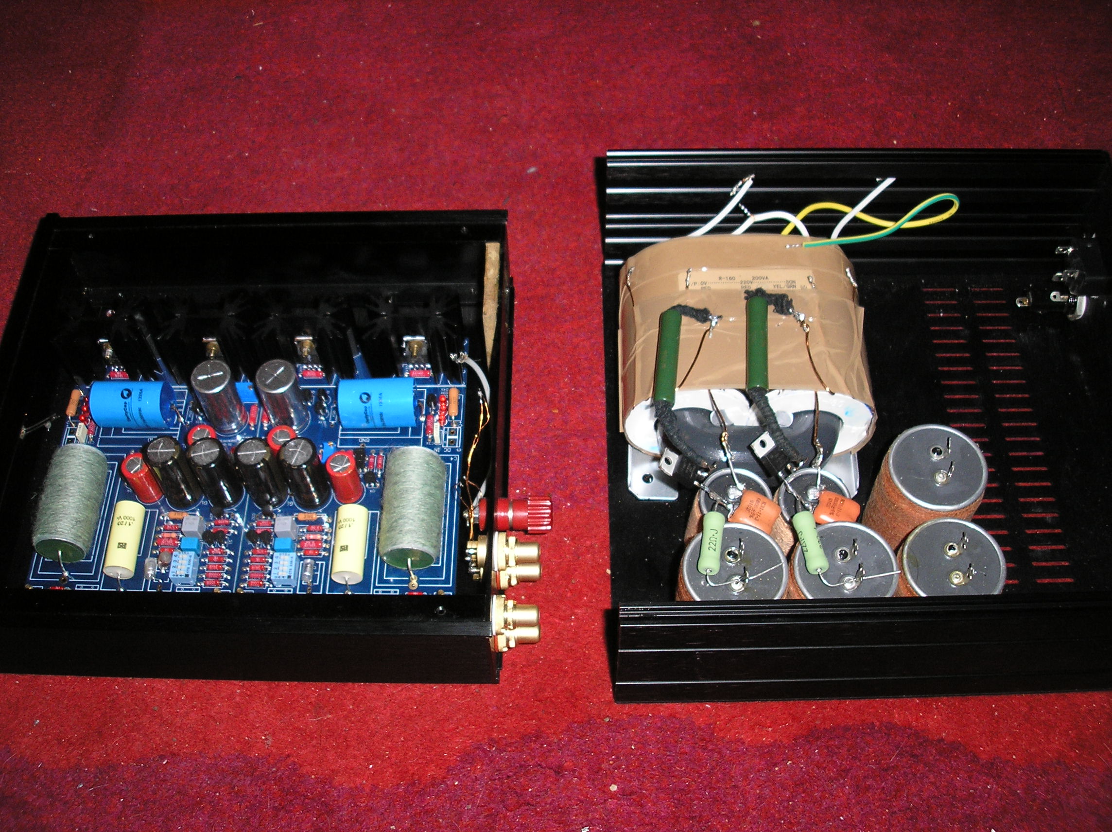

Analogmetric and I will never buy anything from them again. As you see I do not like the multicore leads. They are gone. I always do that and sometimes I reduce the voltage by taking off some cores. This is 40 vac 200 W but I use resistors both before and after diodes.
See to ventilate well the back area. Besides the box is cute its also small and the output MOSFETs sinks are side by side. That will create an ambient delta more than for others. You may start at 3.1V tp1-tp2 then rest the top cover but have a clip on each c3 input side and one on the ground lug hanging out. Monitor those they slide down to circa 4V in respect to gnd clip each after half an hour. If they slide too much open and boost them up at the trimmers.
Thank you Salas . I think I will use a 5 mm copper plate to make contact to the top plate and some silicone between. Would that help ?
