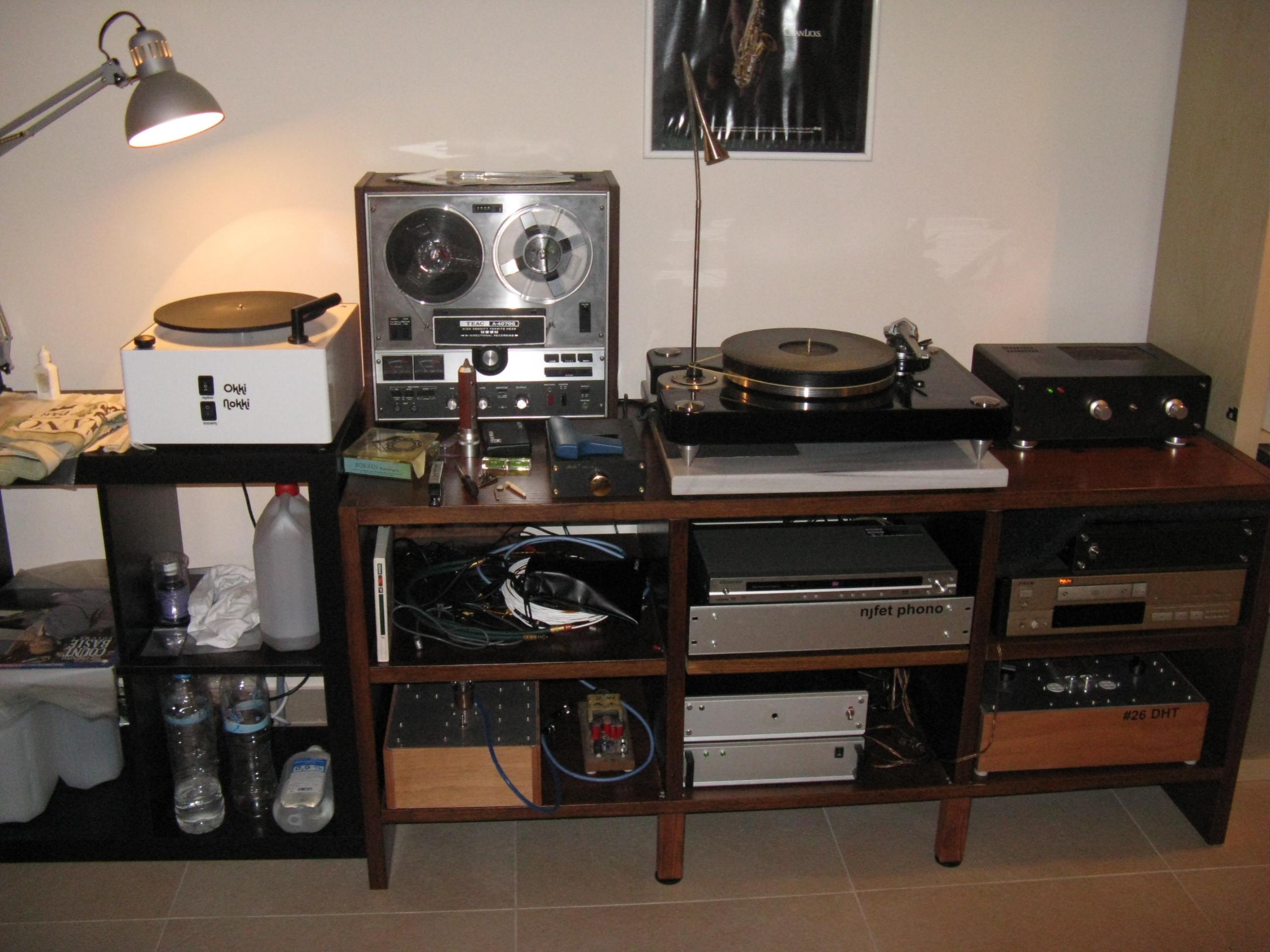

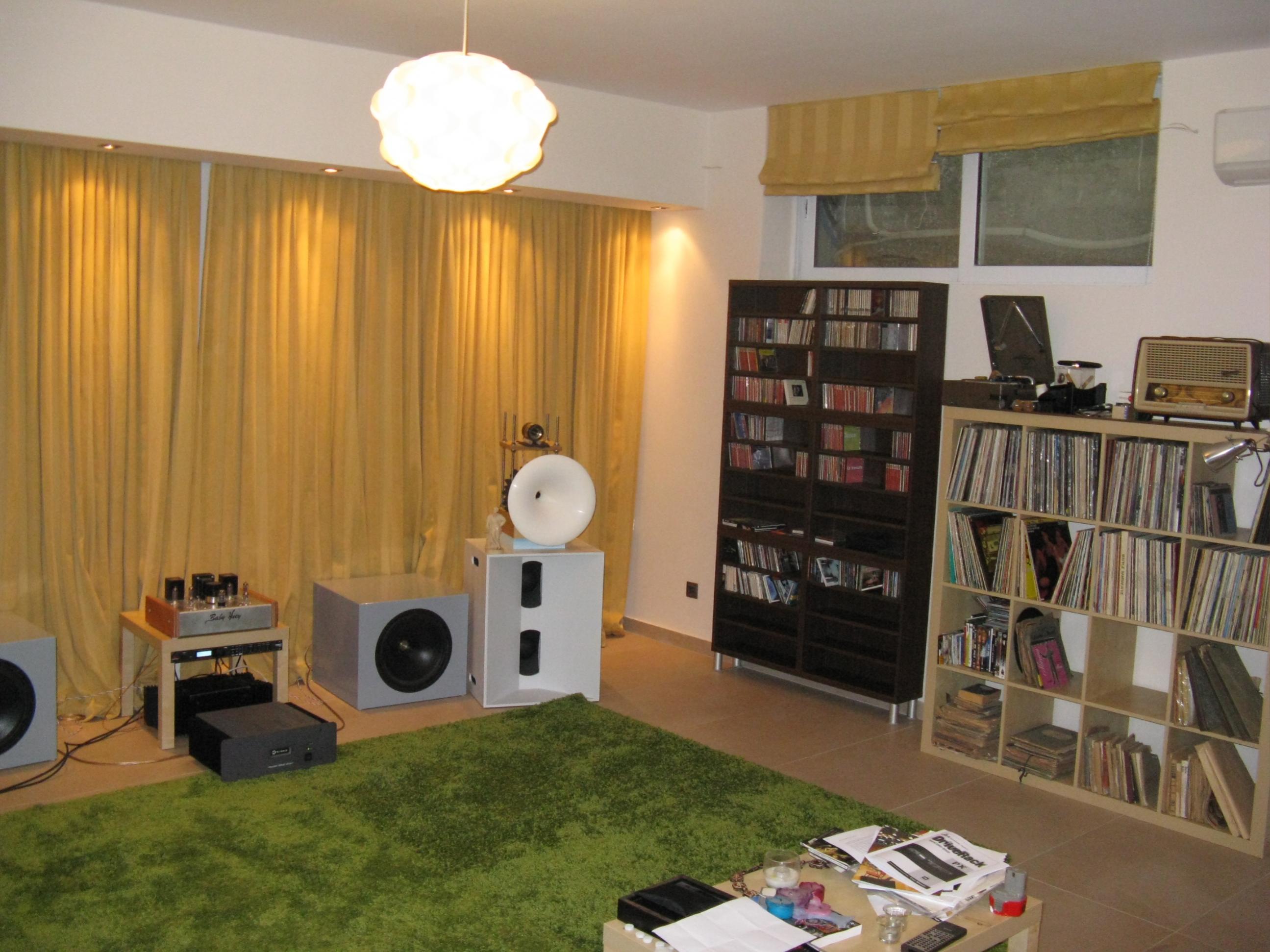

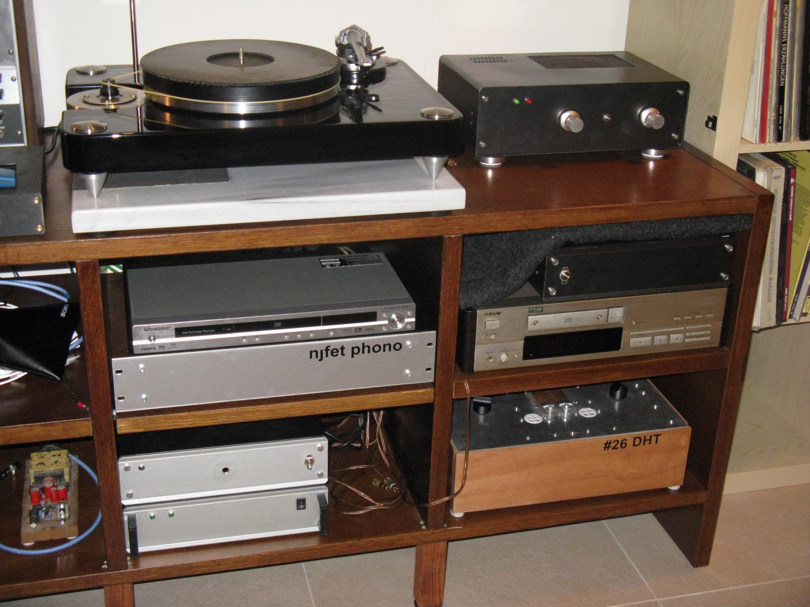

I attach some pictures of the whole setup as the folded simplistic has found his place back on the music system.
Salas, this an excellent effort. I have built many simplistics, but for sure I didn't expect this! Really high end sound, and maybe even more.
The only problem is that my other half not seeing me much lately, and although she is very understanding, she started to complain as I spend most of my time listening:)
