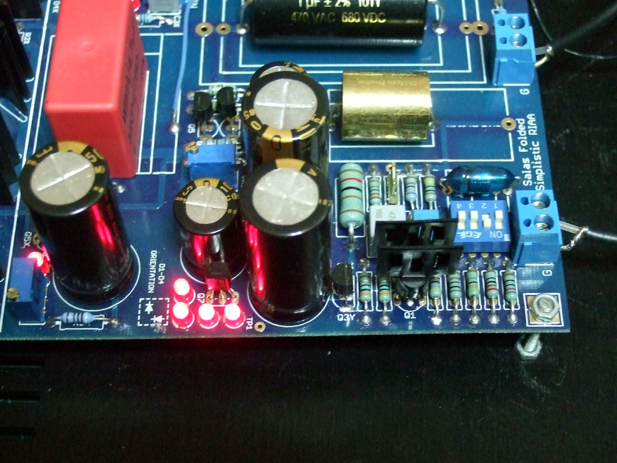

I have just checked the voltages across the mosfets and the Bc550 with the following readings and the DMM red lead to gate and black to source pins.
IRF9530 -4.5v IRF9610 -3.52
The 550 has 8.83v across B/E with red to the base.
Start with the 550 and we see what's the deal. Must give 0.6Vbe. Before that see that no K117 reads as short across its outer pins. Few decades of Ohm is normal. Not open either. About the 9530 I am still bit suspicious giving that Vgs when cold but we will see. Process of elimination...
Thanks I will check the 117's.Regarding the 550 can I use an ZTX651 if needs be.
I have spare IRF9530 if needed.
Only for test purposes. Do use the proper one permanently when fixed. That ZTX one is CBE back side remember.
