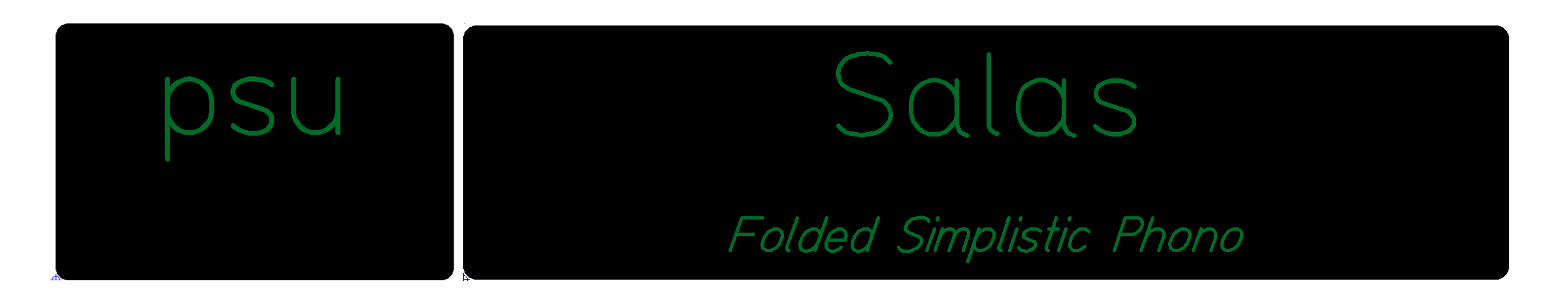

Simplistic NJFET RIAA
It gave 63dB and 20.6VP-P before clip with 2x 369s of 11mA Idss at the input stage. Good for low MC this one config. I could not get the scope to lock on any 50Hz at all. Weird given the open air crude test. I have seen a few practical things I would want to revise. Minor PCB parts fitting stuff and a couple of designations I mean. Do you like the blue or in black it will be better?

This is a PCB, it is made for giving the project a practical side for more users beyond the highly custom p2p expert builds we practiced. PCB has the 1.1 smack to the phono, no wires its a plus.
The folded with the 1.1 are a good combo. Maybe you used 1.2R and 1.1 for the standard pdf circuit so far? I will add B+ pad near the PSU/phono GND pad for the expert & adventurous.
2x369 or 1x369 or 2x170 are matter of gain or parts stash option with the PCB, it takes all. Blue is gathering momentum.🙂

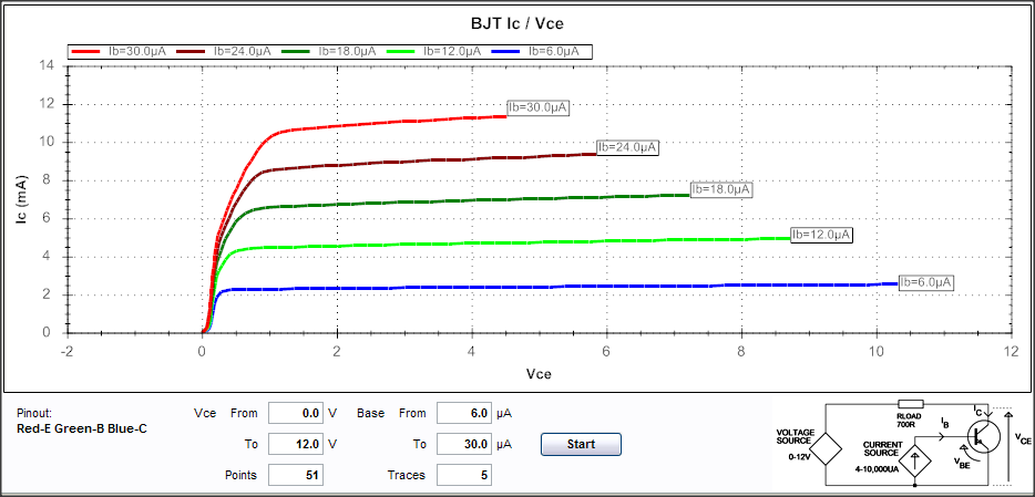

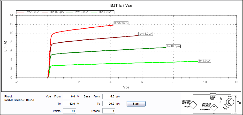

BC560C Fairchild to the left at hfe 630. 2SA970BL Toshiba to the right at hfe 400. Our Vce voltage bias is 4V in the folded phono.
