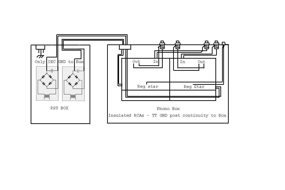

I have to say it still sounds fantastic! I´m really impressed. Have to get it installed inside the turntable one of these days though. It´s too scary looking to have a permanent place in the living room for now. And kind of dangerous with some open mains as well.
That's all very well that it honors first impressions still. If to install in the TT see to make nice little shield cans for it. Did you listen at normal to high volume enough? What is the system it plays in? (Sorry if I had asked before and I don't remember).
