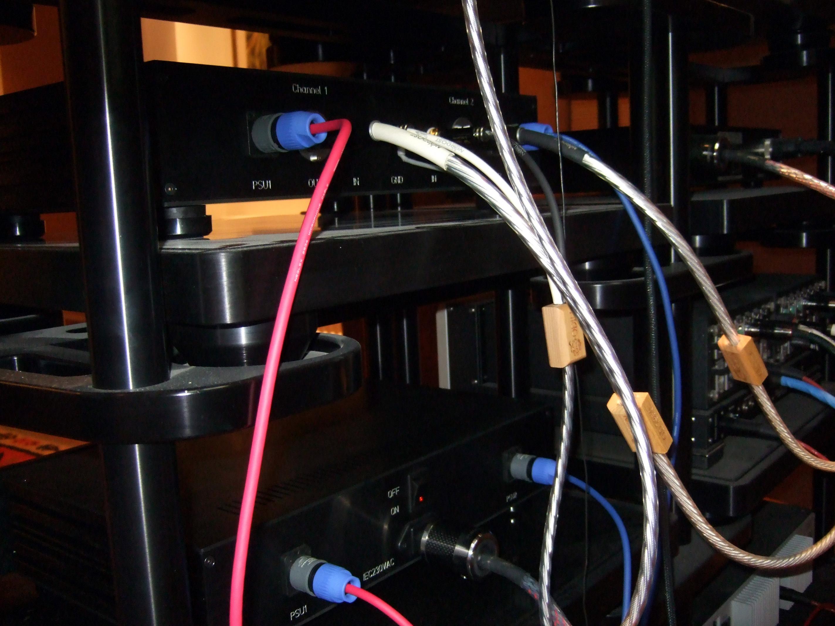

"Normal" Simplistic uses k170BL at around 8 ~8.5mA Idss, so no GR specified.
Can you find more k170 so you can choose the correct Idss ones ?
I am using the folded cascode simplistic with a 0.8mV Benz with great success because I have a DCB1 buffer (no gain) and a low gai power amp.
WW would be nice for the 33 ~ 39r
A friend had weird problems with BL in SSLV1.1 once. Proceed with caution. If yours is gonna work stable on scope, use them.
MM and folded simplistic are difficult to go well, it would take too high a VDS with possible gate leakage problems, pronounced on MM higher Rsource. But take comfort, the SNR with DL110 and HiMC gain scheme in classic simplistic is naturally competitive to folded for MC if not better.
The folded schematic with 2x K170BL I recommended to Ricardo in lieu of K369 is near 60dB in reality, and second option to single K369BL. Very good except still wanting for low mid to bass different silicone wafer doping GR noise VS 369.
Yesterday I finished modding to folded and re installed my ref build that belongs to a friend. Awesome result. He was chuffed.
