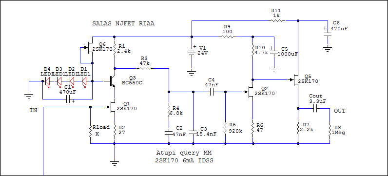

Salas, I'm using the simplistic like you designed for me but now i have some 2sk170's in my hand with Idss around 6mA. If i replace them in the circuit do i need to change some resistor values ? Also i would like to have a bit more gain to not have so much difference from CD player.

Is there any particular advantage of the higher voltage version on the original pdf file over the 24V version above (considering equivalent supplies)? I wonder if I can pick up from here (ie from the above schematics) with no disadvantage over what went on previously.
I suppose the Q1,2, and 5 must be matched for 6mA, right? Also, can I ask why the use of LEDs instead of regular diodes?
No disadvantage, the differences in PSU voltage are dictated by the used IDSS and resulting bias currents.
Q1 and Q2 are the most demanding, Q5 can be +/-1mA, Q6 +/- 2mA. (A Q4 is a missing designation from paralleled versions, does not exist here).
Regular diodes don't give enough voltage. They would be needed to be 3x the Leds number upping the impedance of that local current sourced shunt sub supply.
Q3 is a bipolar transistor, not a Jfet. Thus it has Hfe, and needs no matching here. Just use a couple of the highest for Hfe in your stash for the phono channels.
For 18V it takes full recalculation and one thing sure is that it will not afford high enough load resistors to maintain its now gain. Expect 63dB total for the 24V Atupi one with a 1:10 SUT in front of it.
They are more than enough strong for your application. Here are the modifications. You will get 5-6dB more also.

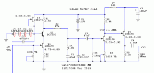

Thanks a lot Salas for customizing the schematic!
Should i change something else if i use a 0.1uf FT-3 teflon for interstage ?
Make the output cap 2.2uF if it will sound heavier than optimal in your system when you will do that.
