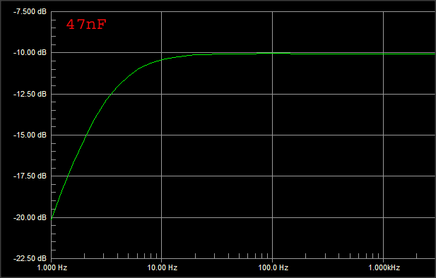

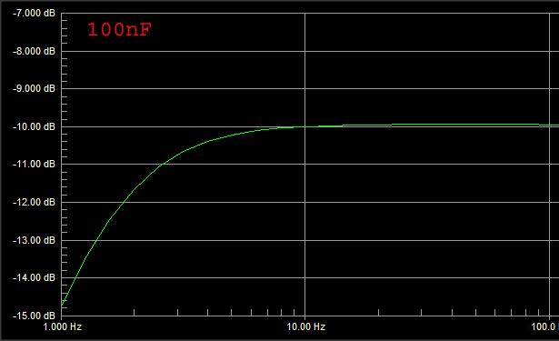

For a 0.1uf interstage what is the rolloff freq ?
Finally got teflons 🙂
Say if you got no loss of low frequency between the output capacitor and next stage, i.e. if the output cap is huge and the next stage's input impedance enormous, then all the interstage fixed coupling predetermines is in the pictures below.

That's fair, still with turntables mechanical nature and the many discs eccentricity 4-5Hz problems some mild predetermined subsonic roll off has been a prudent move in this design especially regarding big reflex speakers and/or flimsier pick up arms. Should be taken into account for total system high pass planning. The choice to modify the interstage VLF curve is still there of course. I recommend those two well tried values still. They had worked in the numerous systems that all those builds shown by the members found home to, just fine.
