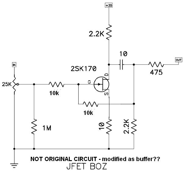

11v... do you believe there might be some sonic benefits by increasing the drain resistor to 1800 ?
Not really, I took it to 1800 for when the BF245 went so to have ~22/2 across each buffer JFET for design elegance. That's in conjunction with the IDSS of the lower buffer JFET. If you will be rebuilding component quality and is handy try make the voltage 22V after the resistor with proper value judged in your build. If you will be able to discern anything better it can only be a plus. What it practically does is it equalizes the dissipation on the buffer JFETs.
P.S. Not drain resistor, RC filter resistor for buffer stage.
You are right... this is a buffer, not a common source amp 🙄
I will take the 22v in consideration when I upgrade... thank you 🙂
In this case I should use 1k6 to drop 22v because Idss (calculated) is 7.95mA

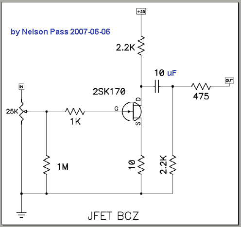

Hi FET fans !!!
The postman got here from China today ( he looked exhausted ! )...
...with a 'test' of 10 Toshiba K170-BL...
...from eBay seller 'Polida'.
search for 2sk170 on ebay and some pictures of sale item have polida written, it is not the name of the seller
Space Egg, looks like you have 2sk170.
Check the pinch off voltage.
You need a megohm resistor for this test.
From memory expect the lower Idss to have pinch off near 400 to 500mV and the higher Idss to be around 500mV to 700mV.
http://www.forsselltech.com/media/attachments/JFET_Jig1.pdf
Measure Vgs/Vp (-ve value) when the 18V of the batteries are across the 1M & the jFET.
