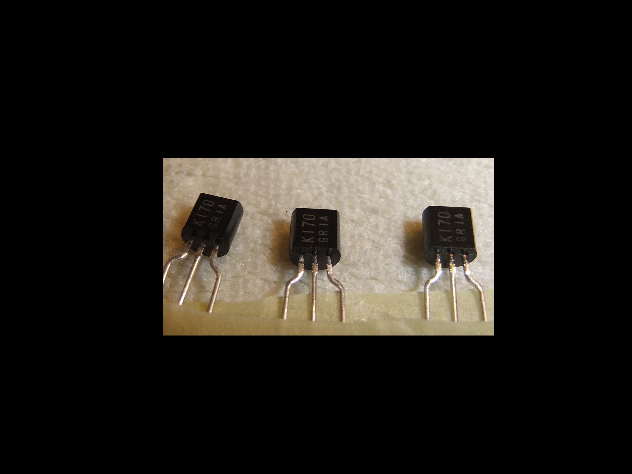

after a lot of reading here i finally bought some 2sk170 to start building this phono preamp. After checking Idss i found the following values:
3.08, 3.53
4.07, 4.75, 4.80
5.83, 5.92
6.28, 6.30, 6.36
Can you advice me how to pair them and wich of the schematics to use ?

Its designed for BL grade. But I will see if your JFETs can fit somehow since you need no more than 40dB gain. If something works out I will let you know.
And i was so happy when i found it on stock in the electronic store.
Also happy when the salesman says 25eurcents/piece 🙂
Now i get the reason 🙁
Maybe you will have a solution for me.
Thanks in advance!
