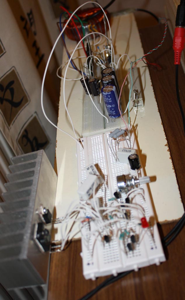

My go at it
Over christmas I bought myself an old old Thorens TD150 mkII including a Shure M97xE cartridge and was in need of an MM phono, tried a couple of simple versions (pacific and similar) and found this thread.
As I already was trying different ones and they were so simple I tried the simplistic too, 37dB MM version as in the evolution pdf, some components to add and some to change and done. I played a little with R1, had a 100k pot there, and found that it sounds sweeter with it at higher resistance so at the moment I have it at 100k on the breadboard.
When testing out I started with a CRCRC+317 but it was too noisy so I tested Salas V1.2R shunt regulator and it was much better. Still some noise when cranking up the pre fully but I think this will get better with proper cabling and enclosures.
I like the combo so much that I am in the process of making some more permanent solution than in the pictures. Plan is to have powersupplies in one box and phono+pre in another.
First picture is the phono, second shuntreg and third the Thorens deck (somewhat halfway through some cleaning and cableswaps).

First time I see one done all the way on breadboard. Still some noise when cranking up fully he says...ain't that a something in such a prototype?🙂 Watch the 1.2R with oscilloscope on the power rail, it can oscillate in various layouts.

You need the MM setting that you will find explained in the PDF. Fanos store in Solomou Street maybe gets you K170BL on order or has some extras readily available if lucky, but matched isn't something stores offer. You buy many and you match yourself.

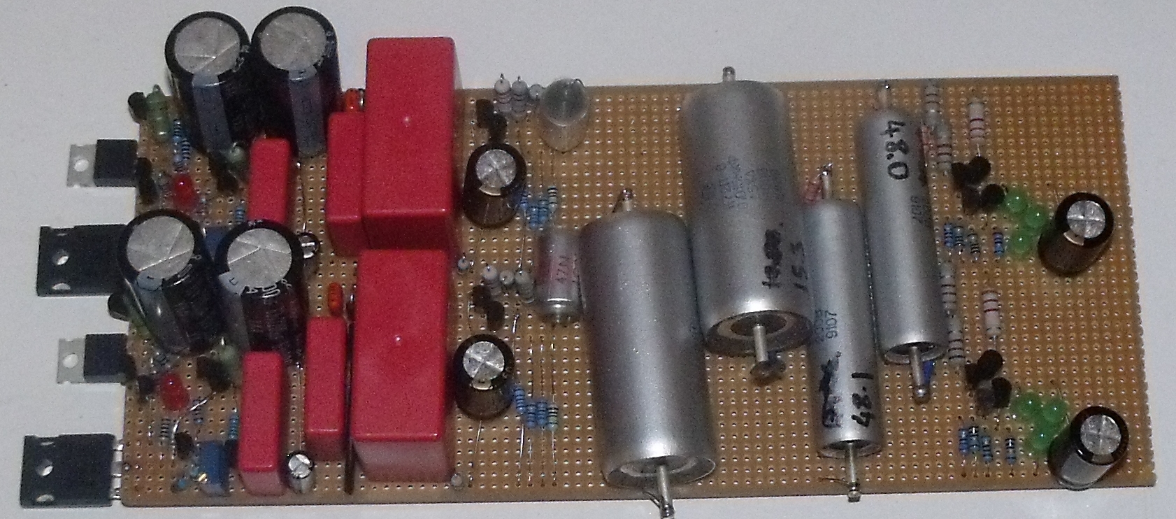

I got my V1.2R regs debugged this morning (I tried to keep the layout as compact as possible), and have finished the phono section. I wanted to keep the regs as close as possible to the the phono section so used one board for everything. Using my old 15Mhz BK scope I can't detect any oscillation at all, I just get the noise of the scope itself at the highest frequency setting. I'm going to start installing into my pre-amp (using the baseplate as the heatsink) this evening, and have short a connection as possible to the input sockets. Here is a (bad quality) photo
