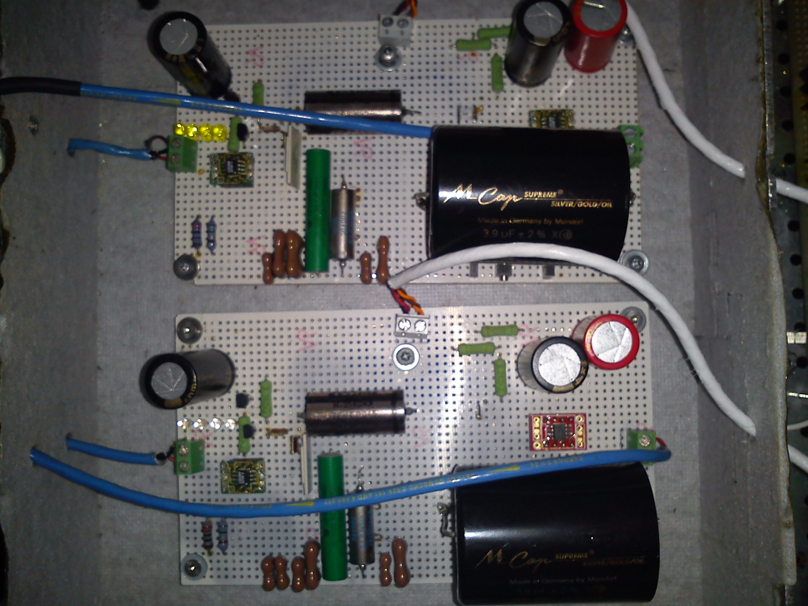

The Piccolo MC head amp pre-pre is 26dB + 40dB Puresound P10 are a total of 66 dBs, a lot of dBs for my Denon DL103R so I have a little hum in both channels: more in right channel than the left channel but I think it's due to the fact that I'm using a bad Tx: today my friend paid the new Tx Special laminated Bartolucci 200V 100VA so now Giuseppe is in the manufacturing process & more or less between 3 or 4 weeks I will get at home the new Tx.
About the sound it's difficult with this kind of hum, in the headphones sound good still needs open the highs & lows but mids are OK, I compared the Puresound vs Salas Simplistic with Wilson Audio CUB model & there is a lot of difference so the clear winner is the Simplistic, Puresound still needs some tweaks:

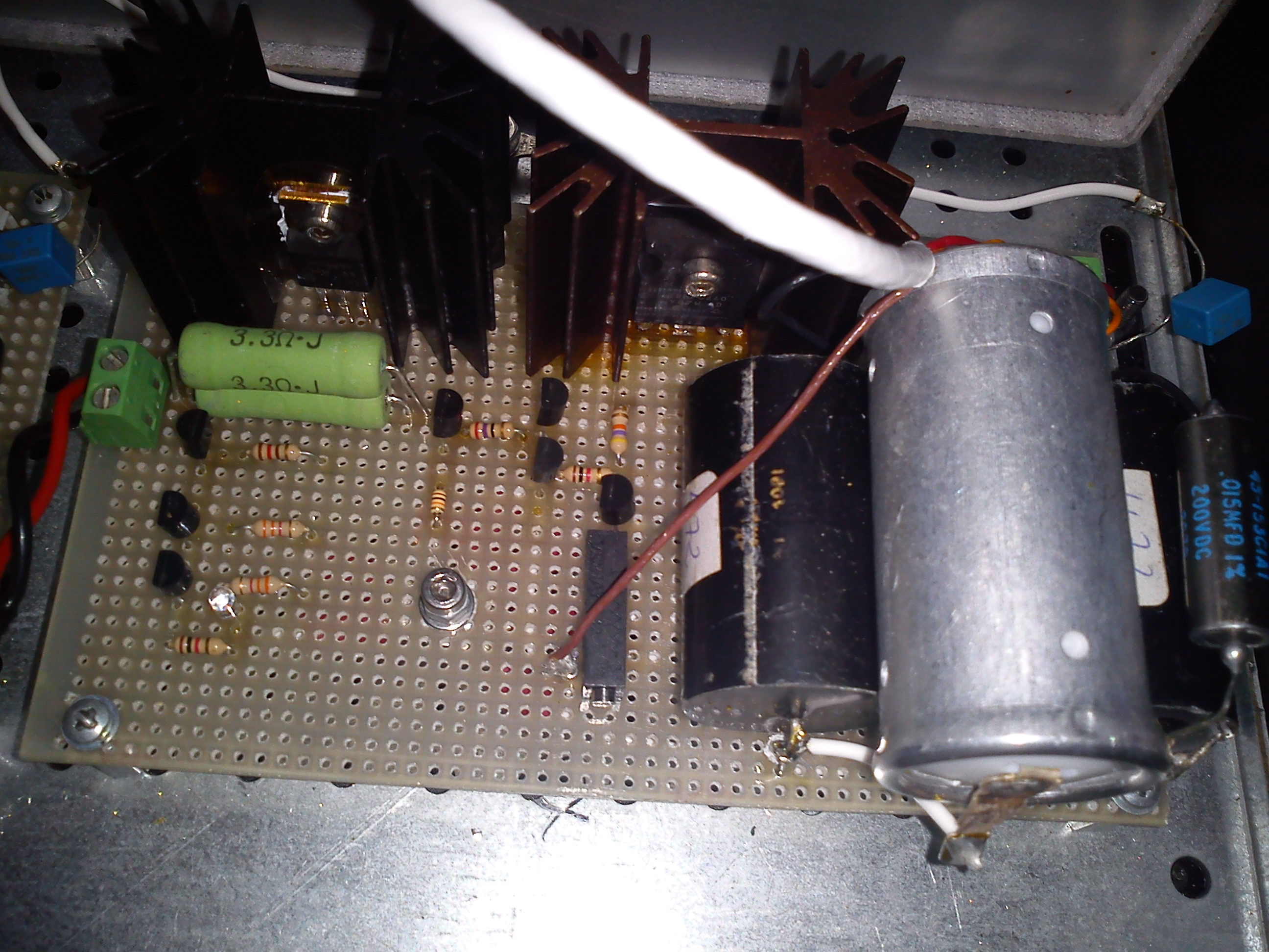

PSU
PSU with Nippon chemicon KMH 220uF 450V have to be upgraded with BG or MKP oil filled, also add snubber for rectifiers UF4007 = 47nF+100R before the rectifiers
Salas HV reg
Parallel both film caps with 0.1uF FT3 Russian teflon & 0.015 FT1 Russian teflon, Bourns trimmer for Vref must be changed for Vishay 1280G trimmer the other fixed Vref resistor changed for Mills, resistor to set the current also must be changed for Mills
Tubes
Nothing fancy 6N4 J (Chinese ECC83) + EH6922 (Electro Harmonix), so here can play with some tube that I have on hand RSD ECC83 & ECC88 Russiam military grade NOS.
About the RIAA nothing is changed waiting the new Bartolucci transformer to fix the hum.
Thanks for your interest.
Felipe

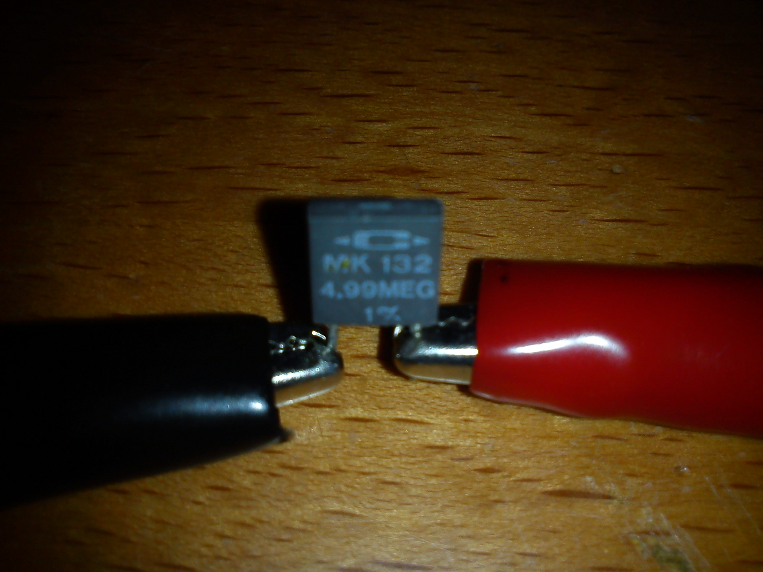

Fortunately I have a couple of resistors Caddock MK132 4.99Meg have I to add 10K or nearest value to DVM reads 5M? about caps the nearest value I can reach with two paralleled caps 68pf //15pF are 83,3pF & 82,4pF can be good?
Those are perfect values for the caps.
You do not need the extra 10k.... The 4M99 is ok.
Thank you so much for your help. After you do the mods, you must wait at least 24 hours before you can evaluate the sound correctly.... It might sound a little harsh in the begining.
If you need more highs, you can always reduce the 15n cap.
