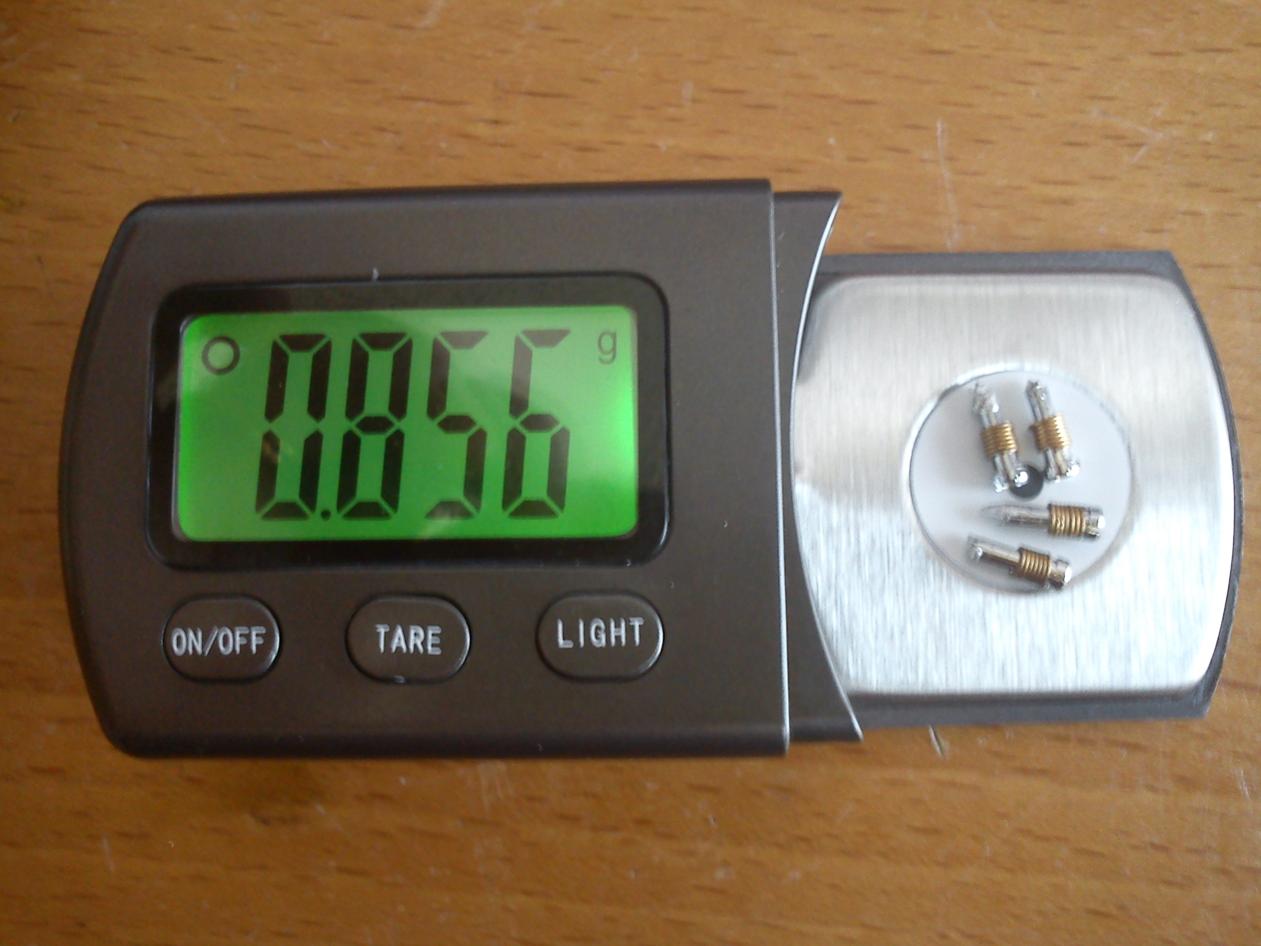

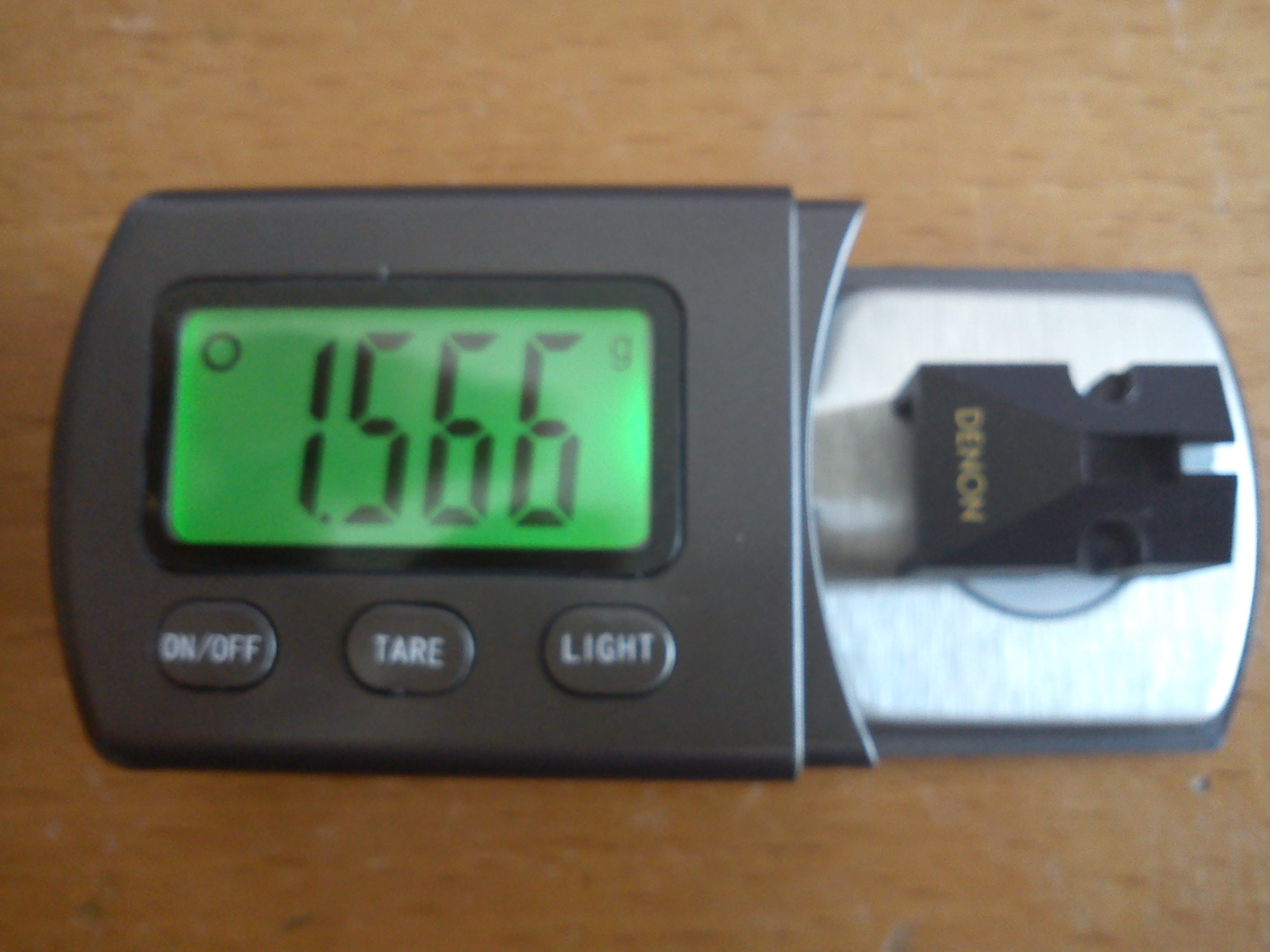

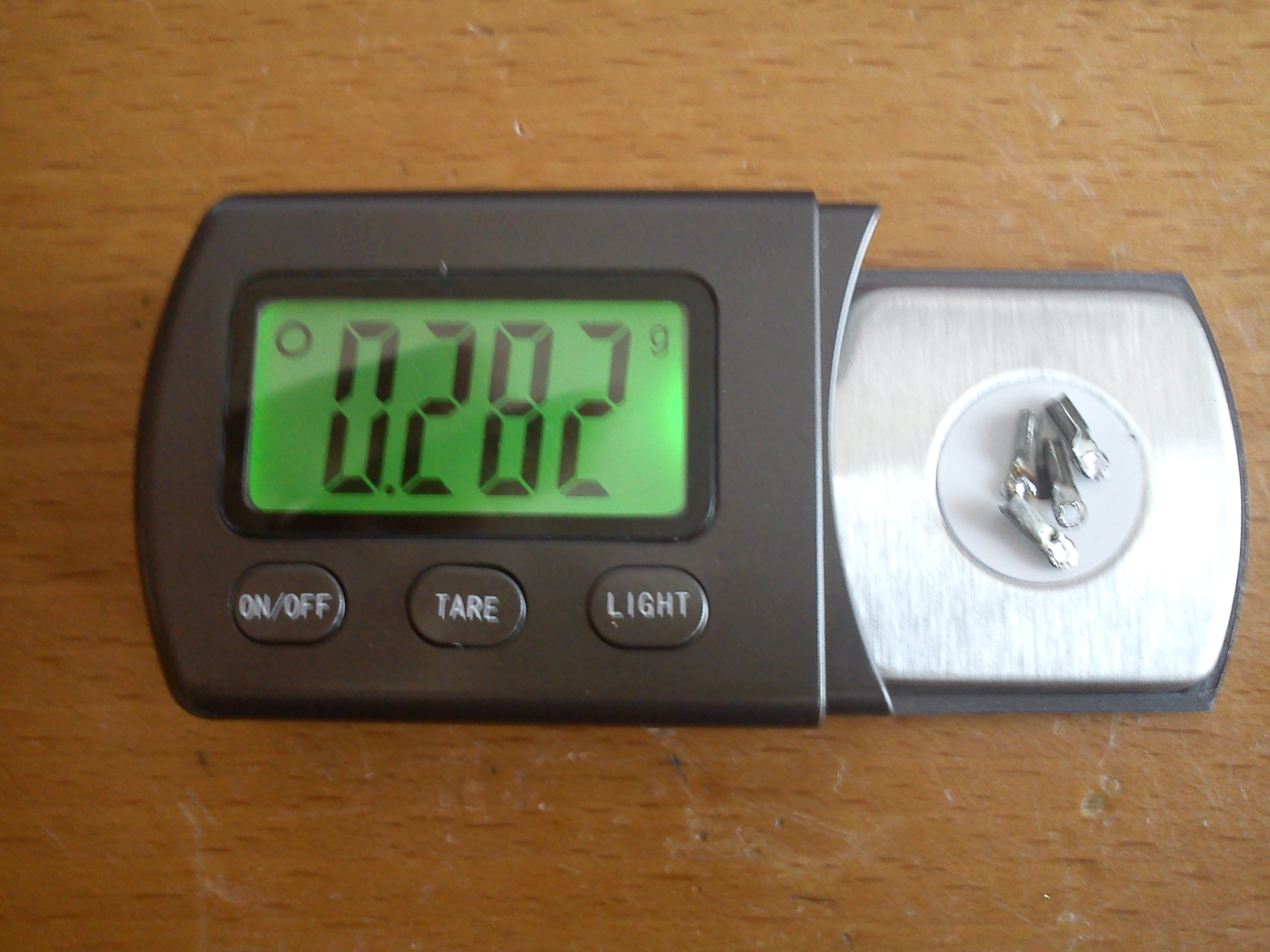

I measured my new cart without the body & without 4 Cardas screws that I must be removed because can fit correctly the cart with them so I used ultra small headshell leads, I calculate the moded cart weight:
-1.566gr body cart
-0.856gr 4 Cardas headshell leds
+0.282gr 4 new headshell leads
Total moded cart lost 2.14gr, now I understand that can get the same sound, 1st I believe was that RIAA needs a new adjust but isn't the RIAA the real reason it's the cart lost 2.14gr & that's decrease the effective mass of the combo tonearm+cart:mad:
Now I'm looking how to add these 2.14gr because the sounds is very very different, of course I prefer with 2.14gr more;)

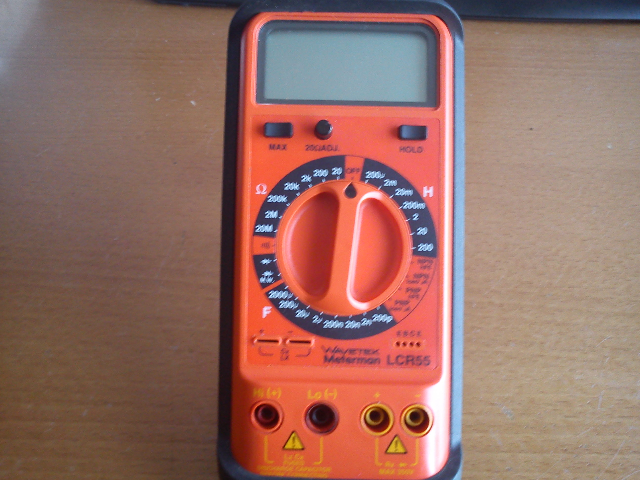

My caps where measured OK by Mark when I checked with my LCR.

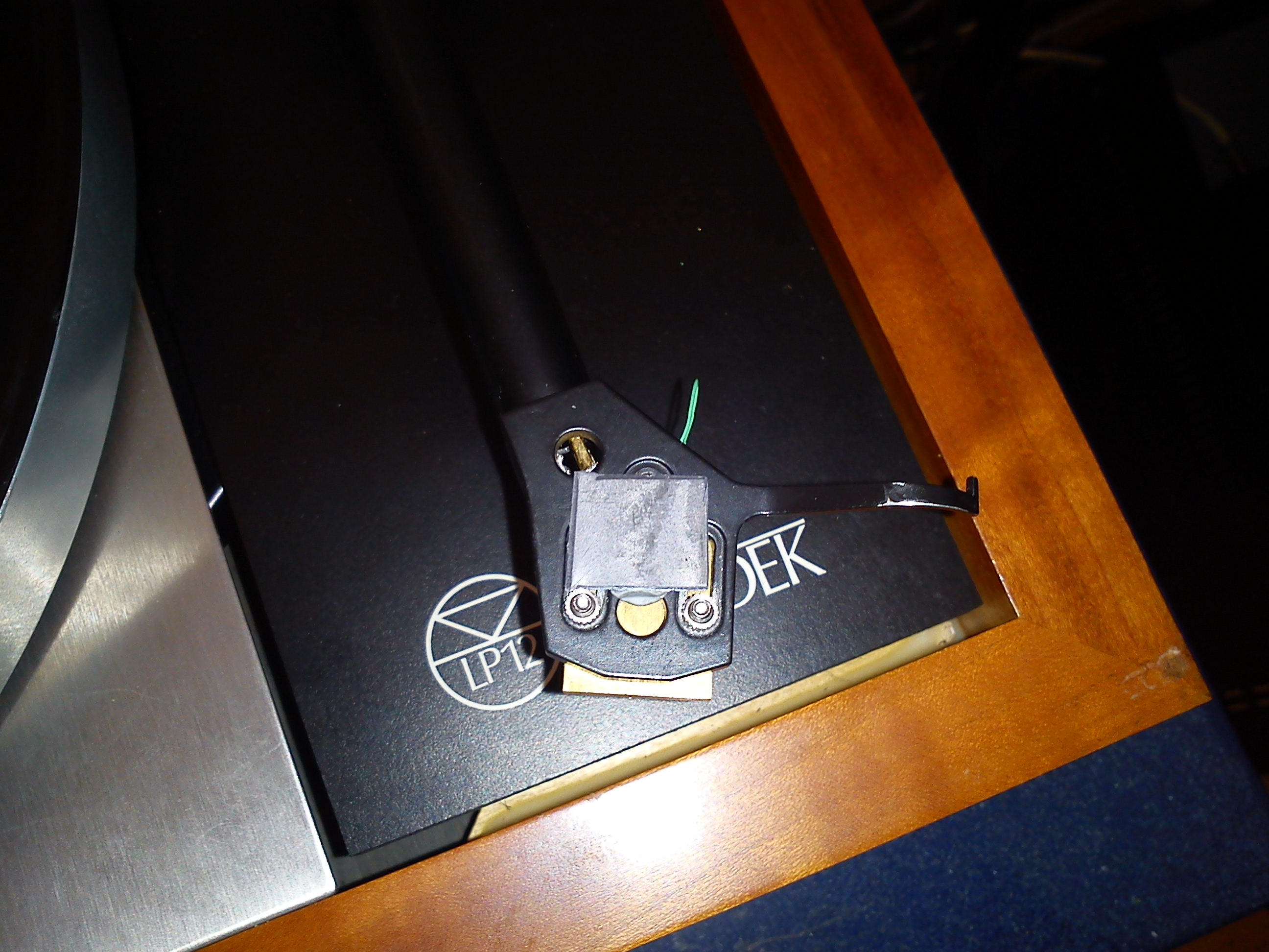

Hi Merlin, last week I've disassemble my damaged ortofon MC-X5, I have found 2 pieces of lead in the housing, small one right at front (behind label), the bigger one near head shell, I guess you can add weight, but where and how many exactly? I don't know :)
I tried with a small piece of lead (2.14gr) fixed with blu-tac, see pic.
Joined 2006
I added some mass to the headshell of the RB300 I am using with my DL103 and it works wonderfully.
I agree with you that the DL103 needs some mass to show it´s true character.
My friend Luis Pires (the man behind the Benz LP) kept telling me the benefits of using a high mass body for the MC carts. He personally chose the special African Wood used in the LP.
Maybe it would be a good idea to build a good wood body for the DL103..... :)
