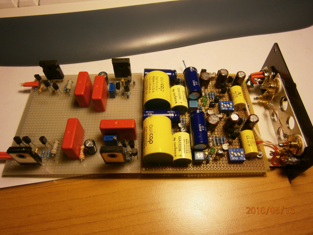

IRFP9140 or IRFP9140N

I have, for shunt regulator, IRFP9140N and no IRFP9140.
Is good for shunt IRFP9140N?

I not have IRFP9240; so if use IRFP9140N, what's problem will the shunt regulator?

What do you mean? The phono has no Mosfets, the PSU for the phono has. There no problem again, 9140N will work.
Yes the phono has no Mosfets, i mean if the Shunt Regulator, with IRFP9140N, can give problems to the phono.

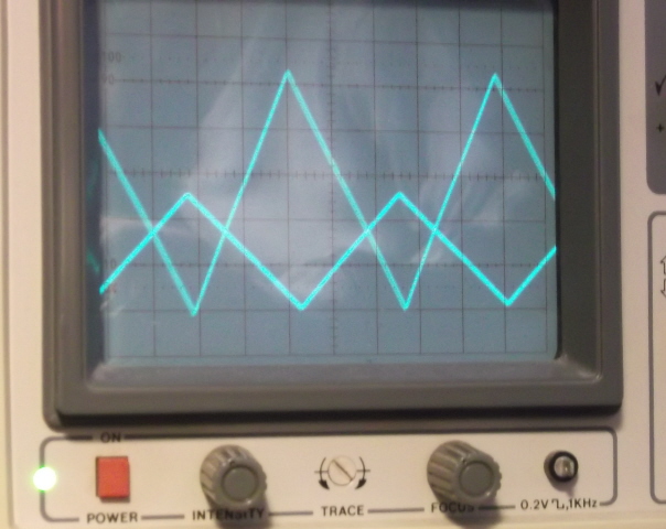

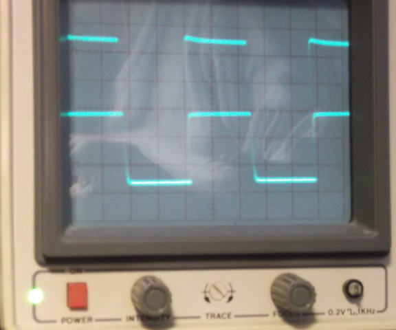

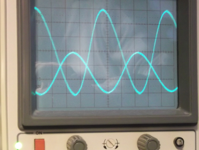

Input signal from generator through inverses riaa. Input level is about 2.5mV and ouput level is 3.6V
It looks like +6dB rather than +4.5dB. Strong fets in the pre-pre? Just a bit more gain in the next stage can easily multiply to +1.5dB off target OTOH. Is it the same difference @ 0.5mV?

The input level can not measure exactly because on oscilloscope I see just a cloudy signal. Maybe is 3mV not 2.5mV.

You will see with your cart anyway. You were after level and it looks very healthy for that. That signal from the generator is strong for such gain. Nice that it does not clip. Its 15.33nF in the 43dB. Not the same as in the 56dB. Notice the left corner of the square wave.
