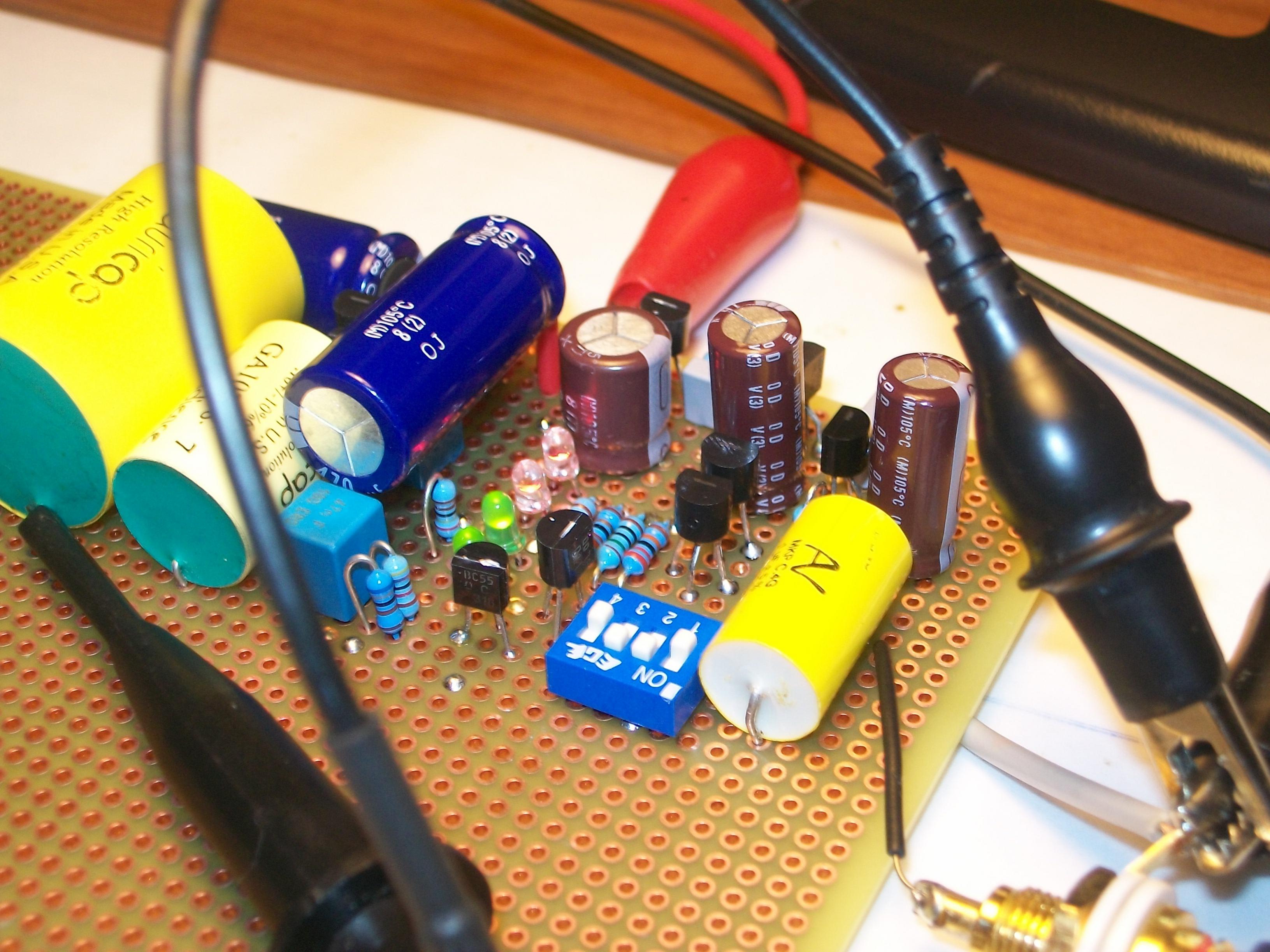

my new version for Salas pre-pre + MM RIAA (63db)
Based on the PDF for pre-pre+HMC=63dB?
This is the left channel of the new Salas 63db, according the pdf of post #6190.
On oscilloscope shows beautiful.
You put DIP switch loading I see. Clean assembly. Still big interstage caps...
Ah, for that. I saw 4 positions and I thought its for loading. *HMC, not real MM. Would need 100 Ohm Rs and would go 56dB total. Then it would be MC/MM. As I gave it in PDF is LMC/HMC.
