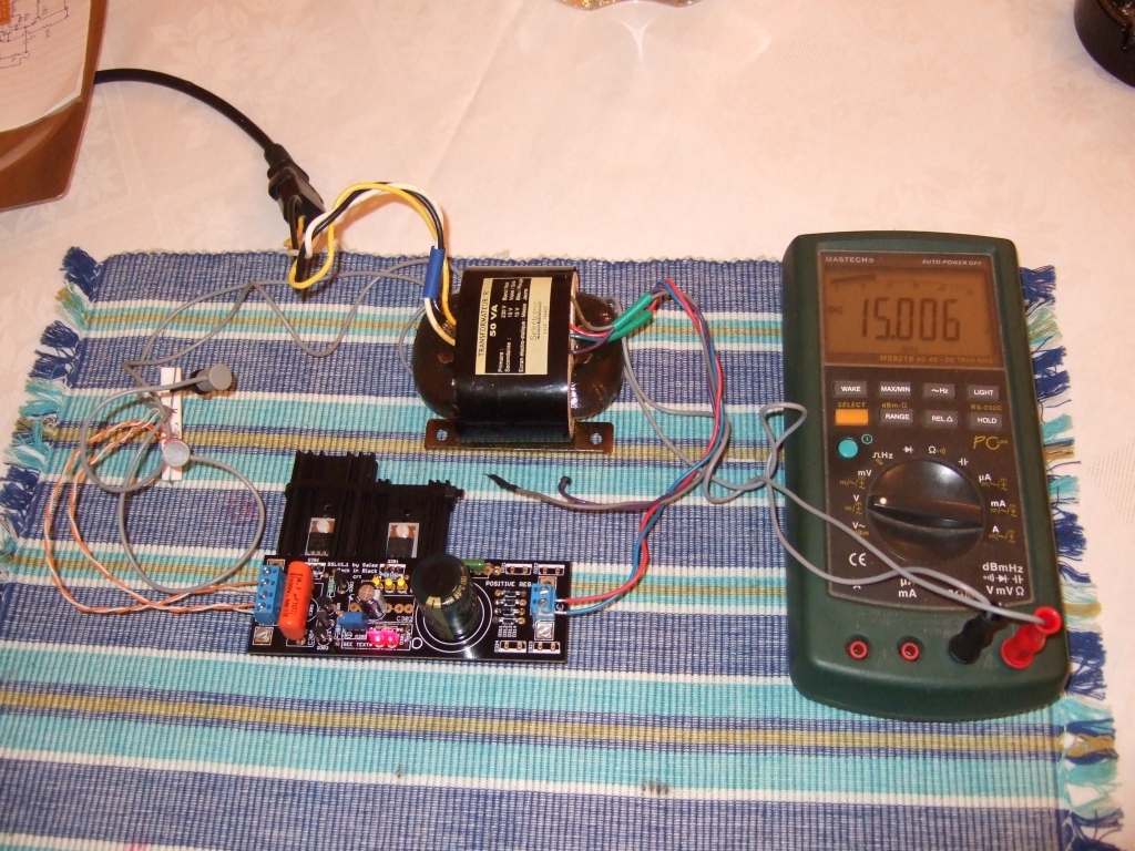

3V drop is minimum (as much as to include R1 drop) but I recommend 7-10V for including possible mains variations, ripple, some warm up.
and you suggest i should decrease the value of r(22r) from my crc and increase r1 for current limit to 100-110ma so i could reach a higher drop across the regulator?
with r(crc) 1r i have : 31.5(output voltage after crc filter) - 24(output voltage after shunt regulator)=7.6(voltage drop on shunt regulator)
this is more appropriate to what you recommend.

I would like you to have 5V drop across regulator minimal and 150mA current. Because each of your channels eats 25mA it will be nice to have 100mA to massage the Mosfets a little better than the spare 50-60mA you now got down to. If the radiator will not go more than 45-48C that is. Since its a small one you said.

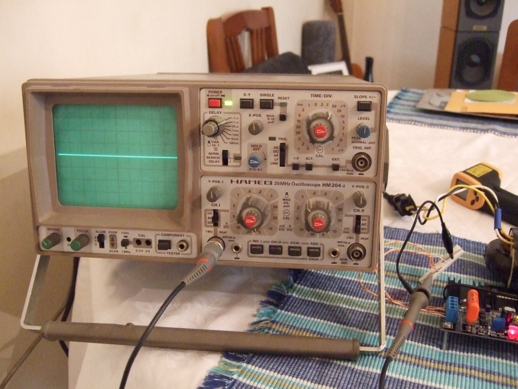

finished tweaking the ps.with a curent draw of 165ma and 5v drop across it the radiator for the mosfets burns at 70C.what do you say...should i search for an 1-2mm aluminium sheet so i can do for it a bigger radiator?

How small the radiator is? Dimensions? Rising easily in temp. Yes reinforce it or get a bigger one. Its good to keep those drop and current settings if you can but with logical heat. Else, the heat will compromise the reg's reliability. Incidentally I was experimenting on regulator prototype board too today.

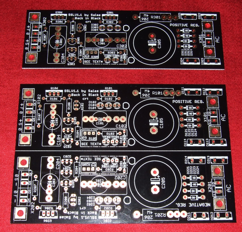

Will sport a configurable Vref to each one's desire. Can take trimmer, fixed resistor(s), Zener, Leds. Very stable with film 4u7+R Zobel output termination on first tests. Also uses different Toshiba low noise JFETs. Nice little drift with those for just adj. resistive + 2 Leds Vref. Has more open OLG than previously also. Unsure if I could see any noise on the scope. Very average scope though. Higher voltage and symmetric tests still to run. Tea is on those, he has a couple of projects that they tie with. Massimo, see better. PCB quality tests good. Soldered very smoothly.
Not yet, since I will have to know it passes all tests, different Jfets reliable, and decide all components values. Topologically is V1 family, still more ironed out, film cap stable, can hot rod, take MURs. I will make a full instructions PDF when I will feel its sea worthy.

It took weeks of consulting with CRT... Thanking him for his patience on the many changes I was asking. Needed a good layout to further work on the extended OLG and phase performance and added features. Keeps a narrow sense loop also. Will see how it goes on with the tests.
