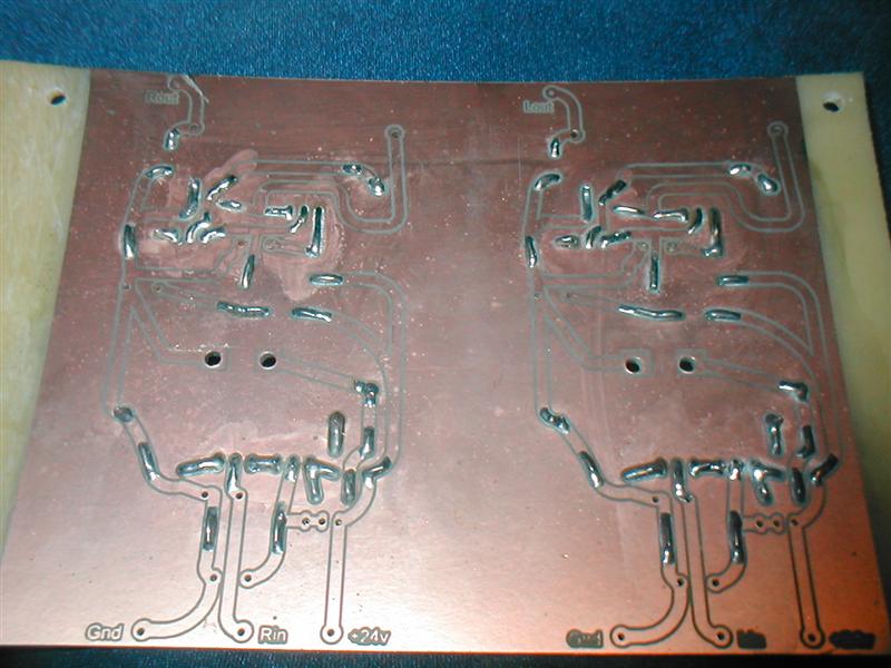

Thaks Salas,
have you a perfboard schematic?
As far as I know there is no pcb schematic available but I suggest you use Express PCB to design your layout.
Post it before you build it ! It will be a nice contribution and we will review it and try to avoid any mistakes.
Have you already decided on what type of components you are going to use ?
