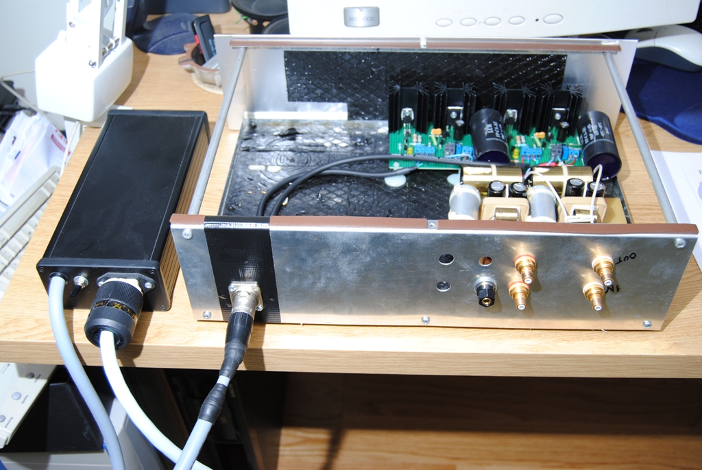

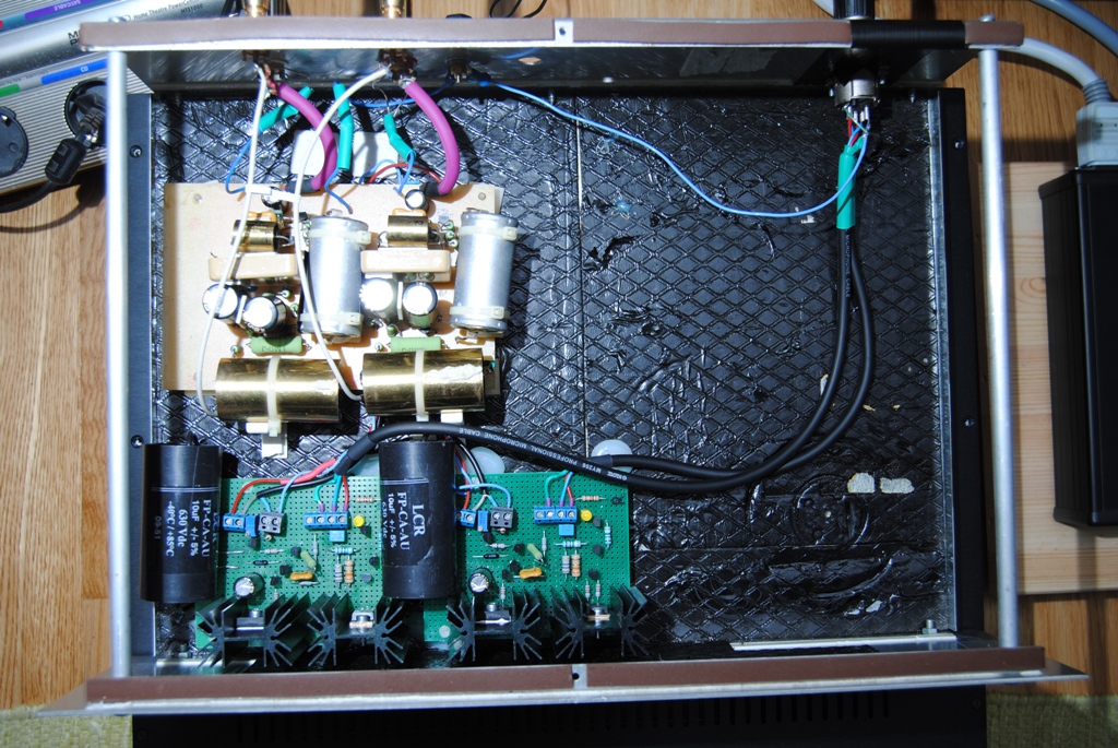

Just for fun.... Some pics of my Benz Riaa with the new outboard psu (hum killer).
I am using two 80VA Toroids (could not afford the R-Core right now) 🙁
In the Bench I tested the build with a smaller PSU.
I am using Lee´s original board but stuffed with better (bigger) parts.
The shunts are Mean V12 (V12 but using a 47u BG on the output instead of the zoble).
Sounds sublime 🙂 It took me a while but now I believe my component/layout choice is "dans la mouche".
Shinkoh is better than Z Foil for Rload in this case.
