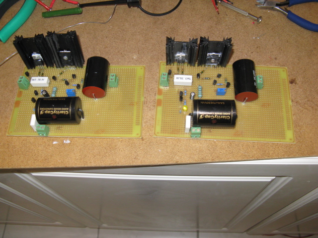

Finally found some time to begin my second RIAA.
PS will be in an external box with 2 rcore transformers and an CL - 4700uf plus 10H. Final C 10000uF will be on the RIAA box with the V 1.2R shunts, which I completed and tested. Vin loaded is 52V and Vout 42V.
For the RIAA - it is going to the 57db for my Shelter 901 - I have already matched some 170 BL at about 8.5mA, but I also have a stash of V's. I will measure some and see how many I can match.
Also waiting some teflon capacitors from the states.
