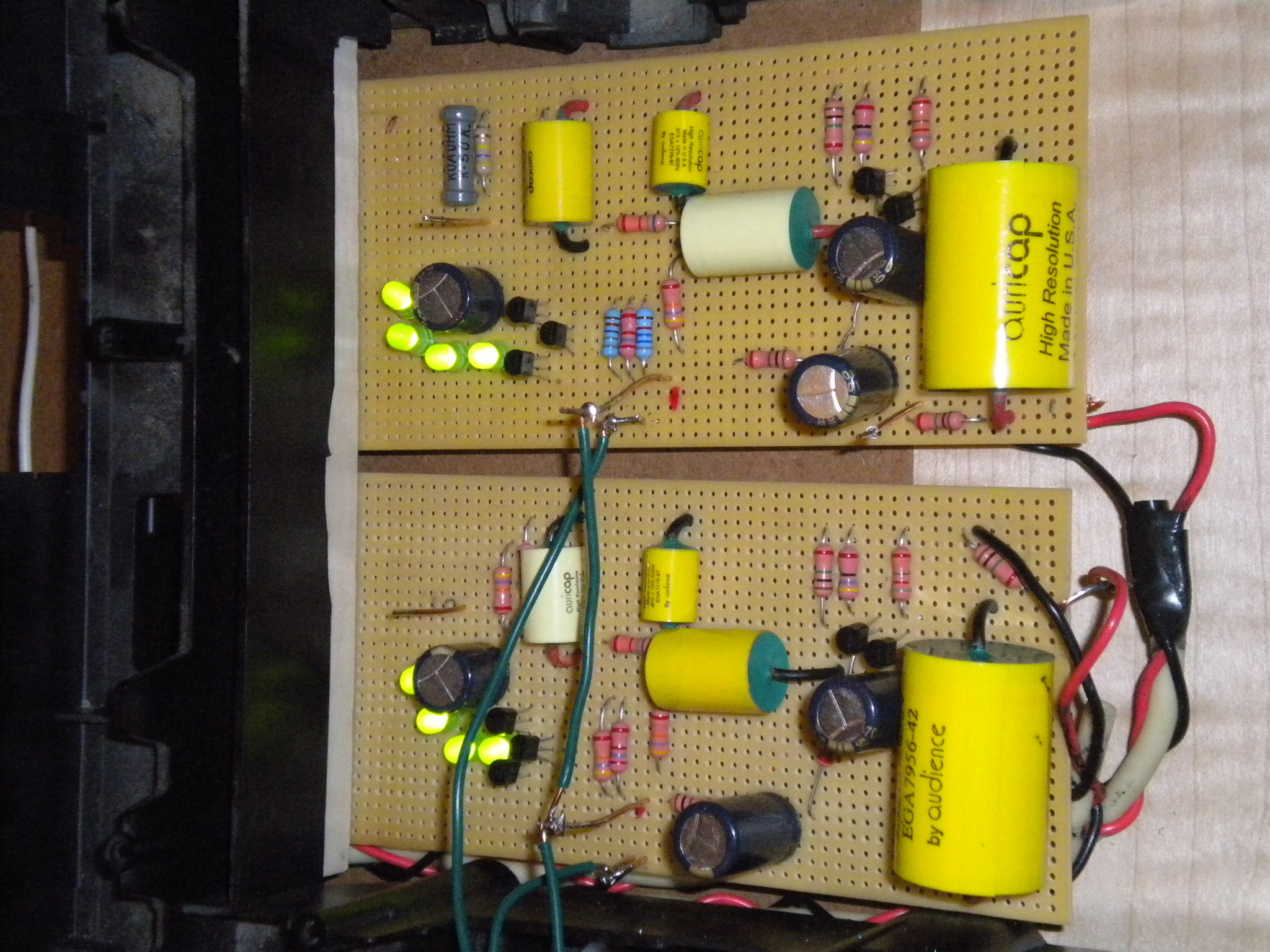

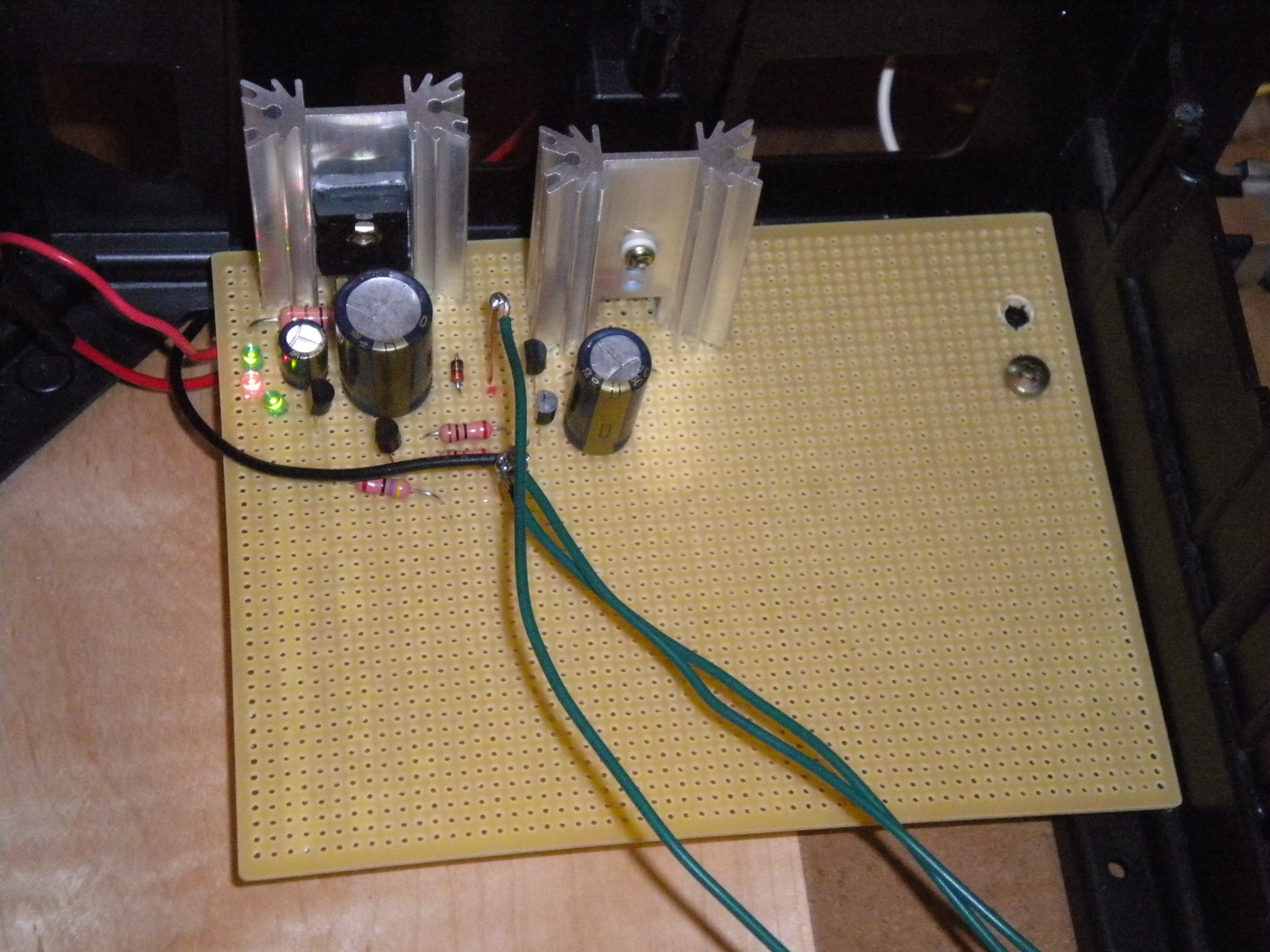

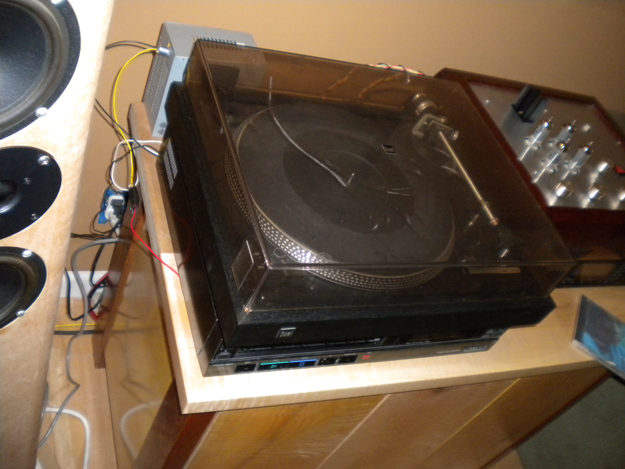

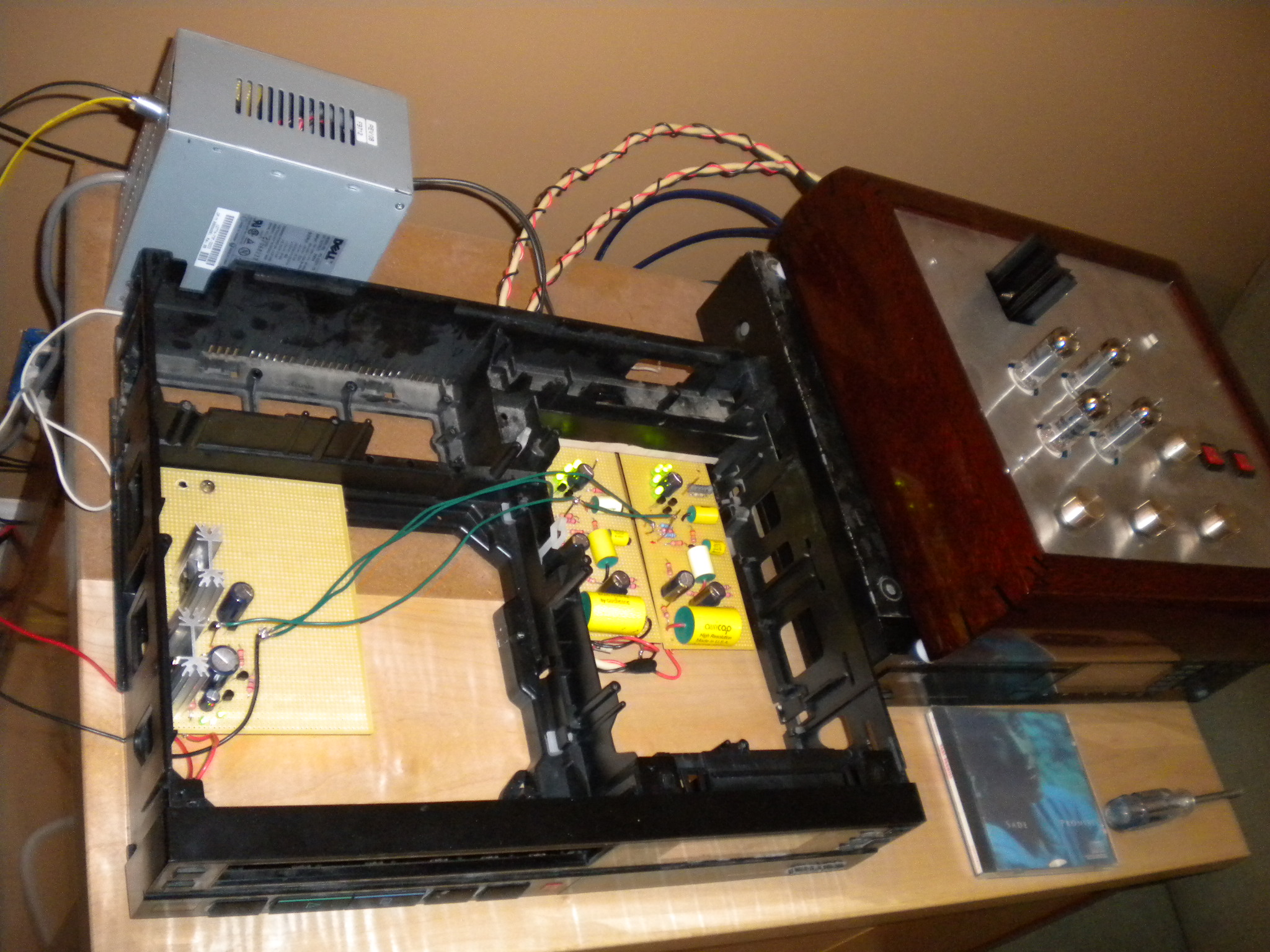

here are a few shots of my build. it is the earlier version of the regulator. moving the power supply to a separate box fixed the hum. dead quiet, not quite but quieter than the back round noise when the needle is on the record. This sounds good enough to make me take a hard look at some other parts of my system. thanks again to all. Evan

The circuit is 41 db gain it runs on 25 volts. I have an adcom cross coil cart. I believe the output is 2.5 mv. There is more then enough gain for the rest of the system. Is there much improvement with the latest version regulator? a question on the riaa circuit the .1 uF cap that is place right after the voltage input seems to be bypassing the filter cap in the power supply. Should this cap be with the power supply or the riaa board?
Thanks for the encouragement, Evan

Yes now I remember, you mentioned the cross coil in a recent post. The gain for that cart is OK. The PSU in the PDF is the same class except it can be variable for not showing two schematics, and being 4 wire Kelvin. A difference is your Zener, when there is a trimmer pot in that one, but having big FC cap shunting the Zener surely kills its noise. Is it 1000uF? The 0.1u was meant local to the phono, when there is long wire like in your case. So to battle the inductance. What can have a chance for even better sound, is to follow the 4 wire arrangement. It can be done in yours as well, if you will take a good look in the arrangement of the one in the PDF.
