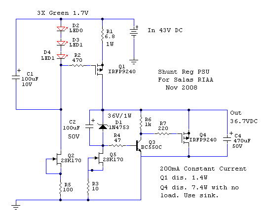

Hi salas,
Thanks for the reply.
The schematic for the the led shunt is as post 336 ?
If yes, I think that I need your help to bring it to 36V.
Also is there any more readily available substitute for the k170s. I don't have so many of them and it seems you use them everywhere... 😉
My line stage's input is at 47K do you think I need the buffer ?

Marinos said:Hi salas,
Here you are. Don't go over 43VDC in, the left hand 2SK170 has 38V across already. 40V is its max.
No, you will not really need a buffer. If you notice some strain, add one. Jonners added one and said it was transparent. He has OB speakers and he is experienced.
