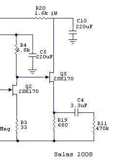

it is a transformer + CCS + Shunt + load.kstlfido said:..........Shunt notes- seems to pull appx 120 mA. I'm getting 36.7 volts out- so all seems to be working fine. I had to use 1/2W resistors on the 220 ohms and an old 1W carbon comp on the 5.6 ohm. The sink gets VERY hot- it's a 45mm x 45mm finned job and I can barely keep my hand on it for more than 15 seconds!![]()

Sound advice. Use a 6R8 for R1 Kent. That will save you 20mA off. Its a nice construction and the current is plenty, why modify with new big heat sinks? Better reduce Iccs.

OK- will do the R1 change to 6k8 on shunt and to 43k from 41k first- easy to do.
Buffer- like this one from your other design? I have some spare 2sk170...

Yes, either R20 1.6k 1W & R19 680R for a higher running current, or R20 2.2k & R19 1.2k for an about Idss current one. Listen to both if you like.

OK I did the mods you guys mentioned- thanks. Q4 fet in shunt much cooler now- just warm to the touch.
I lowered the Rload to 180 ohms and changed the 2 82k's to one 43k. Base has improved; still not quite like the SUT hook up; but better.
