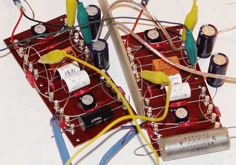

...and it works! Can't listen too much- neighbors won't like it at 4:30 AM! 🙂 I built Sala's 56db gain one on post 110.
Of the 2SK170's I got, the best 4 were all 8-8.16 mA Idss. Used PRP resistors throughout. Siemens ps for 47n Laclanche ps for the 100n, and Multicaps for the 16n. All the parts were better than 1% except for the multicaps, they were all over the place.
El chepo 'lytics I had on hand for the 470uF. I used a Solen and a Vitamin Q for the 1.5uF output couplers. I have more of the vit Q's so that will go in. Solen sounds 'tizzy' on first impression.
Built on old turret boards- tube style! 😀
Using four 9v batteries as the PS parts have not arrived. It's an alligator dog mess at this point, but sure sounds great! Quiet! Airy! Bit thin on the bass.

Hi Kent,
You just adjust the source trimmers so to read 8.1V on top of every FET where it meets its load resistor. There is no such thing like in circuit Idss. Its just that the stronger the FETS for Idss are, the stronger they pull current in a given circuit and the stronger they gain. If you equalize the voltages you will be OK.
I hope that you are not driving an impedance under 50kOhm and you notice lean bass just because you did not employ an additional buffer stage and/or the output capacitors are rather small for what you drive.
Otherwise, the somehow thin bass must be due to 9V batteries and alligator clips. Much added PSU impedance as is.
This Riaa sounds noticeably good on bass normally. Especially when you employ the shunt PSU, that I highly recommend as it is a very successful partner. You will notice a strong sonic lift.
You will be fully OK when you properly supply it and connect it for sure.
The best thing is that already you made it quiet which could be a main trouble part. Let me know more of your system, line in impedance, and progress. Congratulations, nice start. I like the construction style too. 😉

I saw something on your picture that is going to tilt the response somewhat up towards the highs and will surely contribute to a false tonal balance. That capacitor looks smaller than the 16nF asked by the circuit, at a measured 14.31nF. You must do something about that, by adding some small one in parallel.
I would expect it to sound good. He has copied the Valve/Tube guys method of hard wire assembly.
Yes indeed. And nice parts quality too.
But that RIAA capacitor must be trimmed to 16nF, because I just checked simulating with 14.31nF and it tilts up the frequency response noticeably enough.
Yes, it has been trimmed. You can barely make it out, but there are two 1n silver mica just behind the yellow alligator clip. Found the lowest pair, totaling 1.93 nf. Total is 16.24 nF; close enough for now. The other multicap (right board) is 16.38 nF. Both these were supposed to be 15 nF- go figure.🙄 I'll need to get some of those russsian green ps and make up some proper 16 nF's.
Salas, I've noticed on some of your schematics, this cap is 15.8 nF. Is that correct or is 16 nF?

I am happy that they are actually OK for value. So we can concentrate on proper PSU and hook up. Yes your Mosfets are very nice Fairchild jobs, totally OK. Those 15.8nF etc are trimmed for slight differences in internal circuit impedance between versions. Yours is fine with 47k, 47n, 16n. For that little hum, better attach your coax shield, not using the cable as pseudo balanced, especially for input. If it is so of course. These are practical things, I am sure they can be sorted out. In general this RIAA is not a PITA to make it quiet. You did not tell about the impedance that you drive with the RIAA or what is the TT, cart, amp, speakers. Maybe it is helpful we know.
