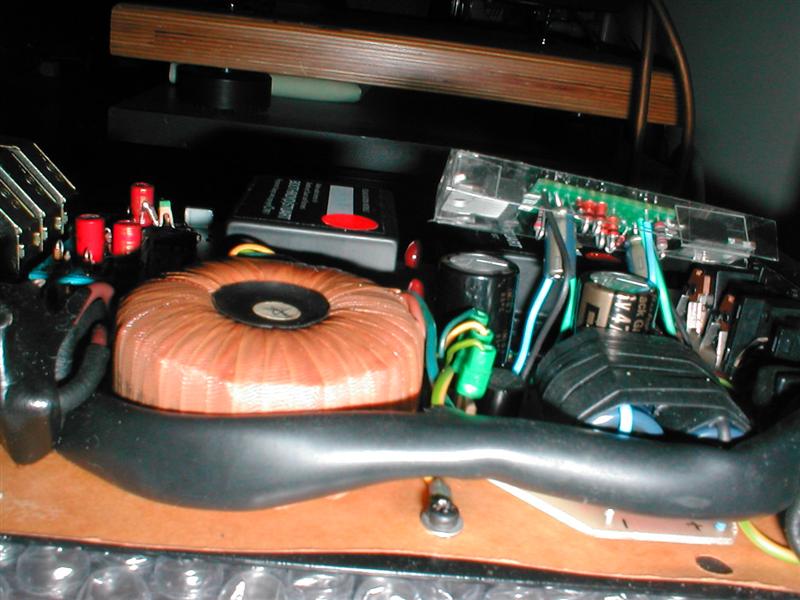

Here's a couple of pics of my pre/phono.
http://www.diyhi-fi.co.uk/images/system/Pre Front View.jpg
http://www.diyhi-fi.co.uk/images/system/Pre Top View.jpg
The wiring will be tidied up when the parts are finalised and the shunt reg is in.
Lee.
Lee.
Nice space and box. If you continue to have hum problems after finishing, remember that most possibly is gonna be due to no use of shielded coax for signal. Especially on input from TT. If you face any ground loops ask me too. Also, you must decide what kind of buffer you want to employ so not to have 2. Remember, you already have Q5 doing this. You may do the B1 I have shown above, directly at your Riaa tail and compare the Q5 or your external buffer. If you gonna use an external one, just toss Q5 and R19, link Q2 drain to C4 in, and take output from current out point. So you have one redundant stage less. More transparent.

Hi LeeThomo said:Here's a couple of pics of my pre/phono.
Finally I can see your pre
It looks quite good.
What type of buffer is it ?
Do you need that buffer between the CDP and the power amp ? Can the DOS feed the power amp directly ?
Ricardo

salas said:Can it be a Pedja Rogic circuit from Serbia? I think that I can see a TO-220 Mosfet there.
It is indeed! I used a higher power transistor as it's what I had to hand. I tried it with all 2sk170's, which had better bass but sounded a bit too "gloopy".
Originally I was using just the pot between cdp and power amp, adding the buffer stage was a huge step forward. Massively increased sound-quality in every single area. I have bypassed the buffer on the phono just using the Pedja Rogic buffer.
The phono stage is sounding really good even with just an lm317 reg. Still have that large hum, but that's probably to do with poor cable routing inside and outside the pre.
