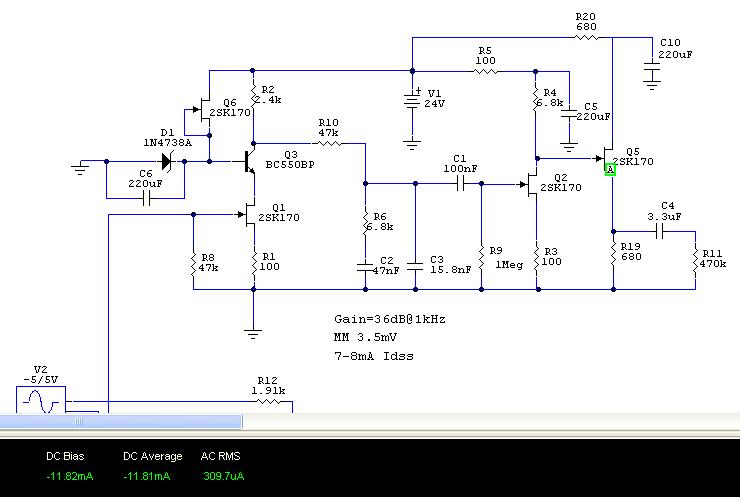

Hi Salas -
There's something I don't understand about the component values for the buffer, and since I prefer to understand what I'm doing rather than blindly follow a schematic I wonder if you might help?
Taking your buffer in post 236 as an example: The gate of the buffer fet is presumably at about 8V, same as the drain of Q2. As I understand it, the source has to be more positive than the gate, so the source voltage must be more than 8V. The source resistor is 680R, so the current must be at least 8/680 amps, i.e. 11.8mA. This seems like a lot - is my reasoning correct?

the voltage at Q3 base is Zener voltage.jonners said:Taking your buffer in post 236 as an example: The gate of the buffer fet is presumably at about 8V, same as the drain of Q2. As I understand it, the source has to be more positive than the gate, so the source voltage must be more than 8V. The source resistor is 680R, so the current must be at least 8/680 amps, i.e. 11.8mA. This seems like a lot - is my reasoning correct?
Thanks, John.
The Q1 drain voltage ~Zener-600mV.
The source voltage ~33*Id
The gate voltage ~0Vdc.
Vgs=-source voltage
AndrewT said:the voltage at Q3 base is Zener voltage.
Vgs=-source voltage
Hi Andrew.
I get that, but I was actually referring to the last stage, Q5.
John
working from the output:
Q5 Id should be < Idss i.e.<=7mA.
Q5 source will be ~ <=4.7V.
Q5 Vgs will be ~<=0v (since it is passing near Idss).
Q5 gate and Q2 drain will be ~ <=4.7V.
Q2 Id will be ~ [36-4.7]/[100+6k8]~=4.5mA
Id = Idss[1-{Vgs/Vp}]^2, take a guess that Vp~-1V and Vgs~-550mV.
Id~=5mA. back to the the guesses and actual Id=4.5mA.
giving Vs~ 150mV (33*0.0045)
It seems that Vgs ~ -540mV and Vd ~ 4.7V
therefore Vg ~ -390mV.
can anyone confirm the calc and logic?

Thanks people for your replies to questions, you covered greatly.
AndrewT explained well for the gain stages. The Q5 buffer is source follower, so its drain is AC grounded. I keep Q5 with 10V across it, which is the optimum I found in my version of Pass B1 (Nelson confirmed to me on the B1 thread that there is an optimum indeed, and has data). A buffer has to be beefy, and that one sounds really good. The dissipation is 113mW so no worries. If you want to relax it at your 36V B+ case, you can use 2.4K feed resistor, 1.2K source resistor, and dissipate 80mW at about 6.6ma and 12V across.

AndrewT said:can anyone confirm the calc and logic?
Its not working in isolated DC conditions and its drain is AC grounded. Think in those terms. It actually has 17.7V Vd and 7.8V Vs.

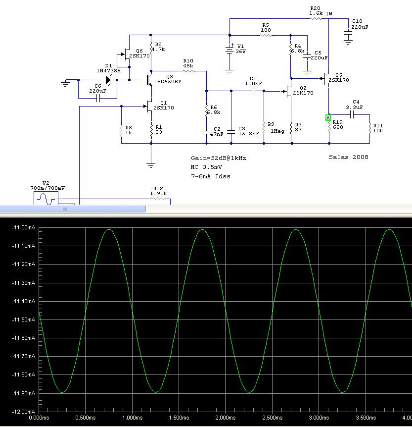

I repeat the questions
are you running Q5 @ 150% of Idss? or using a higher Idss than the 7 to 8mA shown?
AndrewT said:Salas,
Indeed, and as we exchange messages right now it plays at a friend's, driving a 4K7 input pot line stage.
AndrewT said:I repeat the questions
See how it centers there.
Did Nelson Pass really say optimum bias is 150% of Idss?salas said:I keep Q5 with 10V across it, which is the optimum I found in my version of Pass B1 (Nelson confirmed to me on the B1 thread that there is an optimum indeed, and has data).
John Curl did say you can run a Jfet at or above Idss. But I think the above was only for the AC content not the quiescent condition.
Most design to run the Jfet Id between 70% and 90% of Idss.
AndrewT said:John Curl did say you can run a Jfet at or above Idss. But I think the above was only for the AC content not the quiescent condition.
What do you see in my sim pic post? 11.45mA centre and AC hovers around. So you answered it. Drain is virtually AC grounded, remember. So we avoid an extra capacitor between 2nd stage and buffer, or a symmetric supply. Tricky Salas, shame on you.😀
